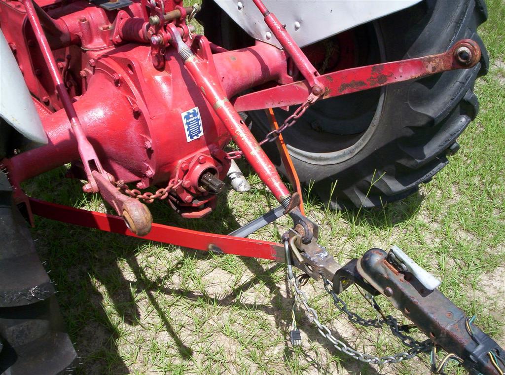

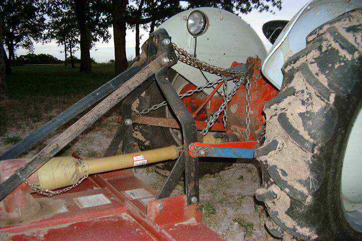

Soundguy, If I attach the limit chains to the top link and to my mower,what's stopping them from both moving together? The mower will still bottom out. What am I missing?
/ 9N ford hydraulic help? #9
Uh.. physics... Chains don't stretch.. unless you are using rubber ones.. if you use metal ones.. uh.. it should hold fine.. just get some grade 43 ( or 70 ) chain.. heck.. even 'proof-coil' will hold a mowers weight.
Your chain hitch bracket is firmly pinned to the tractors toplink ROCKER... it don't move.. if it goes up and down with your lift arms you must have a huge chunk of cast iron broke out around it on the back of your lift cover...
soundguy
/ 9N ford hydraulic help? #10
Her's a pic of the back of my 8n.
Ignore the drag hitch i have on it, and look where the toplink pins tot he rocker... that is where your chain bracket will also pin... ( it don't move with the lift arms.. )
soundguy
Here's a picture of check chains installed.
