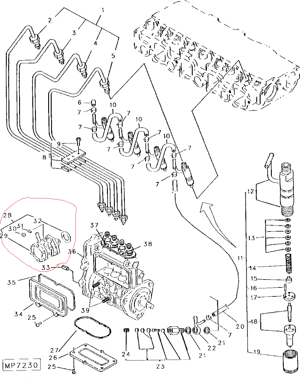

MY JD 870, 970,1070 manual states that the system is autobleeding like Roy said. But there is a fuel pump with a pump lever underneath the injector pump. As near as I can see it is there to suck fuel through the injector pump and pump it back to the fuel tank. Or you could do like I do when changing filters on my VW diesel. You attach a vacuum pump to the return line from the injector pump and suck the air our of the injector pump. That should be the function of the round pump with lever underneath the injector pump. Fuel pump.jpg Hopefully the vague image uploads.
/ 970 JD wont start #5
If you make that image larger I tried to circle the round post fuel injector distributor pump with lever that is there to help manually prime the pump.
