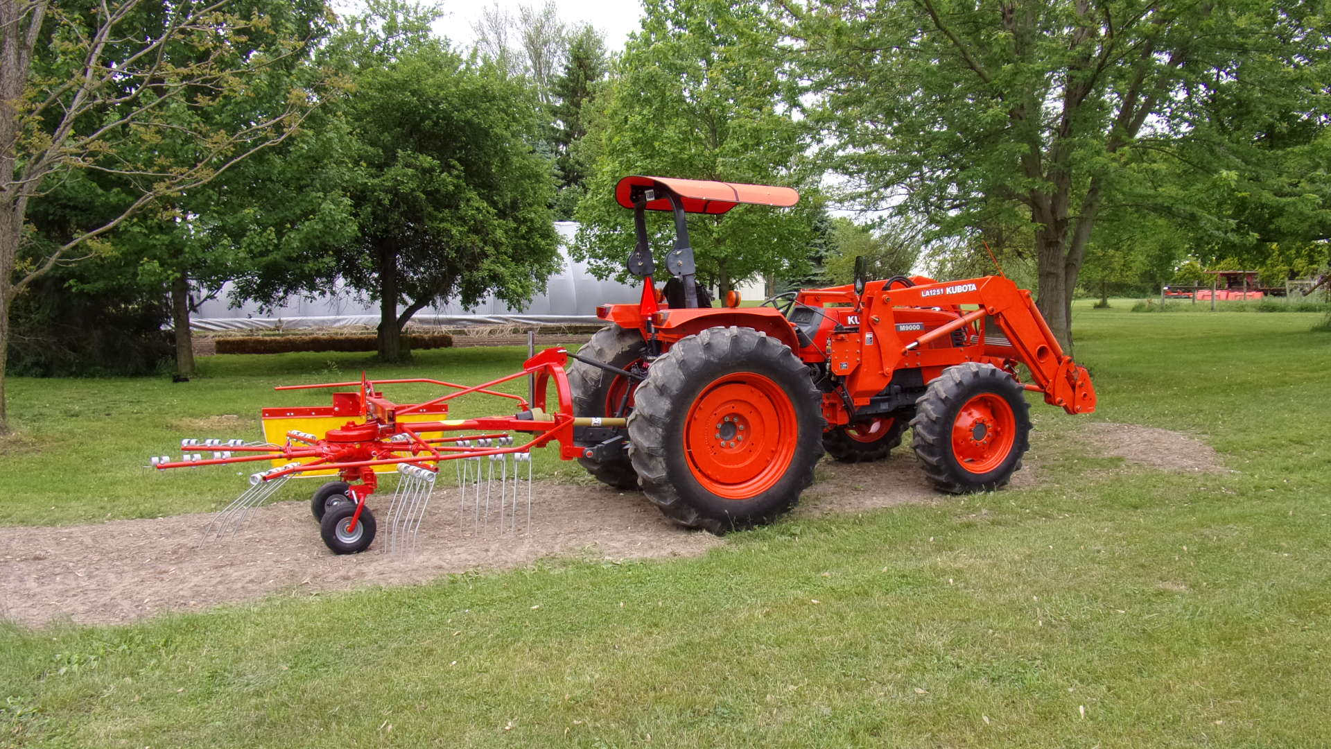

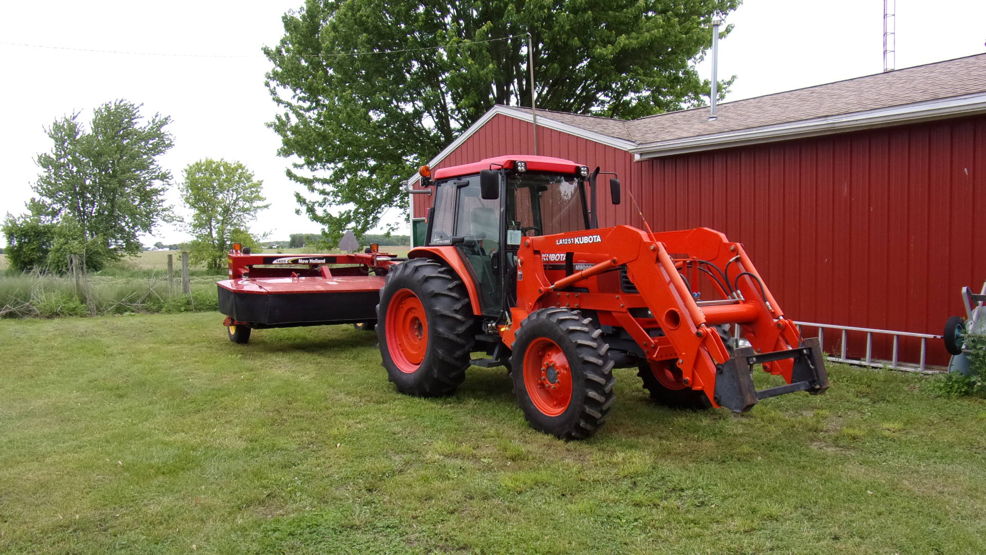

I have 2 of them. Both mechanically injected and both are farmed with and both have very little issues to deal with and both will be here until I'm fully retired pus my Kubota dealer is always chafing at the bit to buy either one (bought them both from him years ago). he's offered me top buck for them but neither are for sale
You won't find very many M9's for sale used on TH or anywhere else for that matter because owners hang on to them simply because they are stone reliable and built like tanks.
Only 2 issues I know of. One, they must be hydraulic shuttle. Hydraulic shuttle totally eliminates the dry clutch in the bell housing. It's replaced with a damper plate so no worries about ever splitting one for a clutch job and two, early M series units all have have weak PTO brakes so I suggest running an over running couple on any pto driven implement that will freewheel of you'll roast the pto brake and replacing that involves splitting the unit. The wet pto clutch pack is only accessable by splitting the unit.
Both of mine have the optional creep gears which makes them a 12x12 and they both have the 2 speed (540-6 and 1000-21) exchange shaft pto setup.
One is a full cab with climate control, the other is an open station. Both are very capable units.
