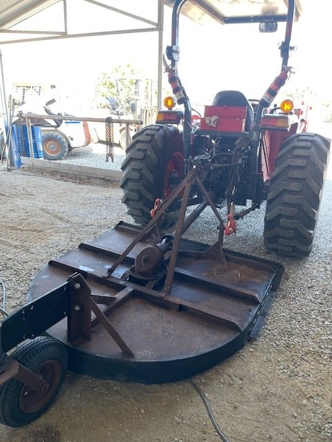

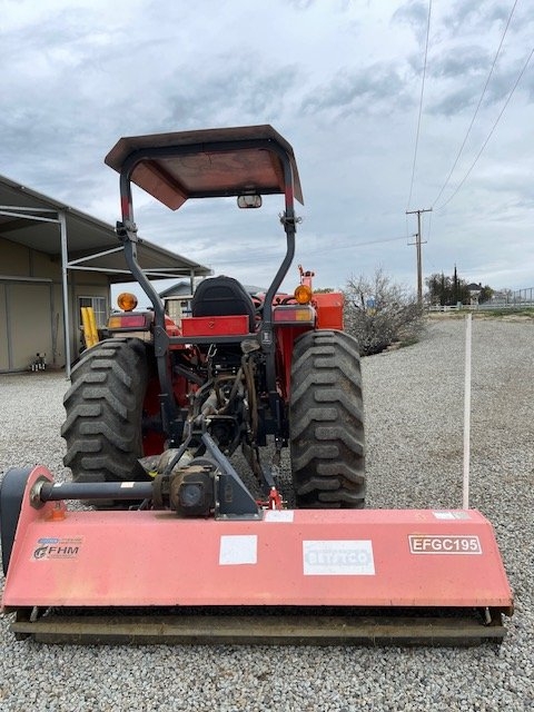

With an offset mower you have only one wheel in the uncut grass vs 2. Unless you have a mower on the front of the thractor you just have to live with a wheel in the cut. I use a 7ft offset flail which sticks out on 1 side allowing me to get as close to the fence or tree or creek as I dare.
Last yr I rehabbed and modified a 5ft BH mower for rough cutting. It was free and the modification was a low cost experiment. If the tires leave the dreaded stand up rows I'll just have to move over a bit and cut it twice make a 4.5 ft cut.
