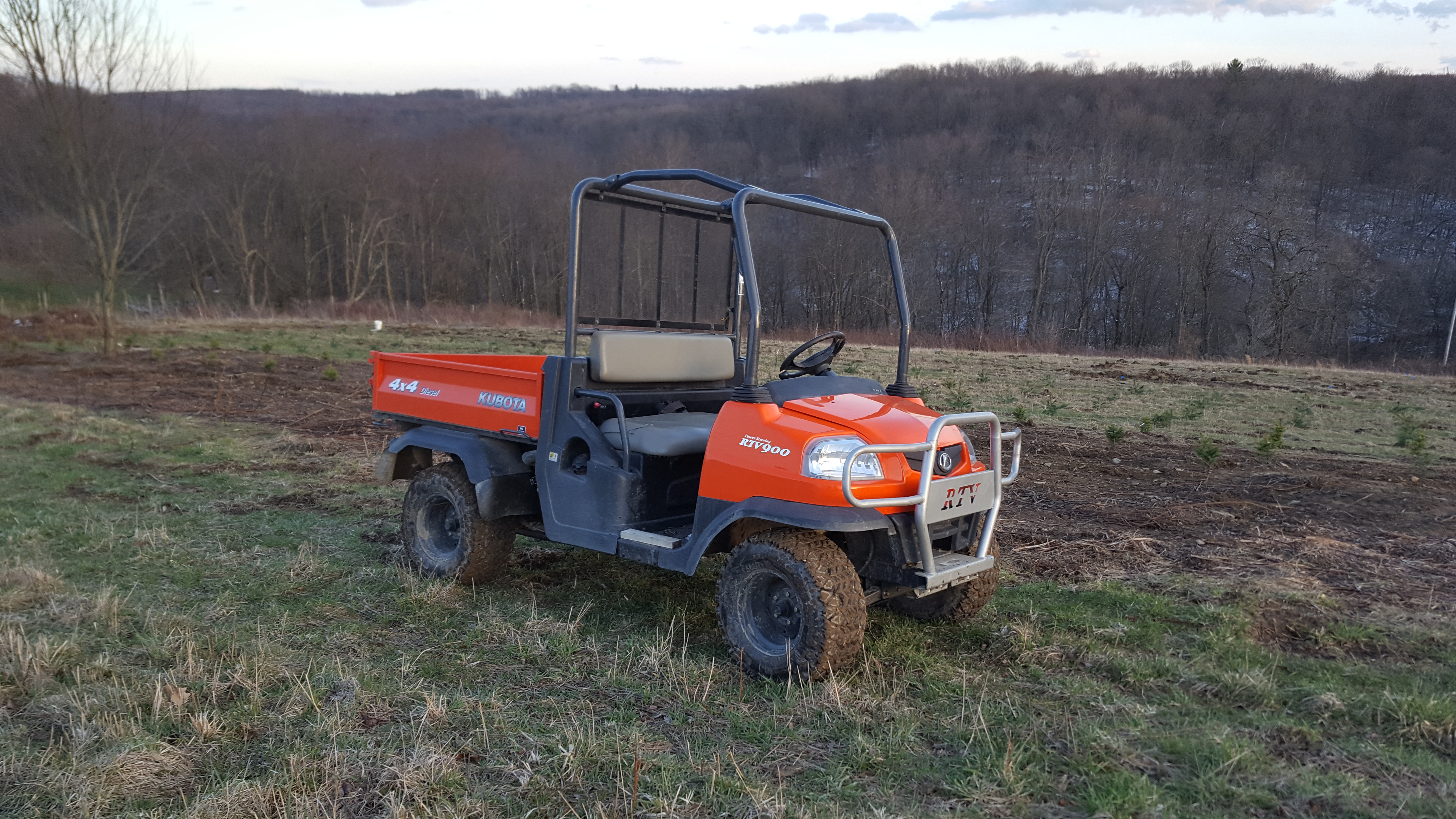

One more pic. Paid $7500 for it with just over 500 hours so I am pretty pleased with it other than getting stuck. It won't get stuck in the majority of areas on my farm
but I would like it to get to some harder to get areas to cut wood and up/down logging road to my house. So I think new tires will be the first thing I get for it.
Also do you have to get 4 new tires or will it work with say just 2 beefy ones in the rear? Guy at dealer said something about the 4x4 not working right
if I had diff tires on it but wasn't sure about that.

On them you need all 4 to keep the ratio the same. Also a slightly larger tire will give you some clearance for in the mud as well as a deep tread pattern. Some of the tires come in two tread heights (smaller tire - less deep lug, bigger tire, deeper lugs).
Good tires are not cheap BUT they will last a long time and make the machine perform 10x better.
Good luck

I just compared your pics to a pic of my tires on an RTV-X1120D, and yours look like the tread depth is substantially reduced. They are "HD worksite" tires, meant to be an overall compromise, and I have had pretty good luck with them. Steepest slope I go up/down is about 40% and I haven't had issues even when it's wet. But I haven't driven in pure mud except for flat terrain.
I suspect new tires will help the problem, but if you need to deal with mud on hills, it might be worth getting a more aggressive ATV tire.

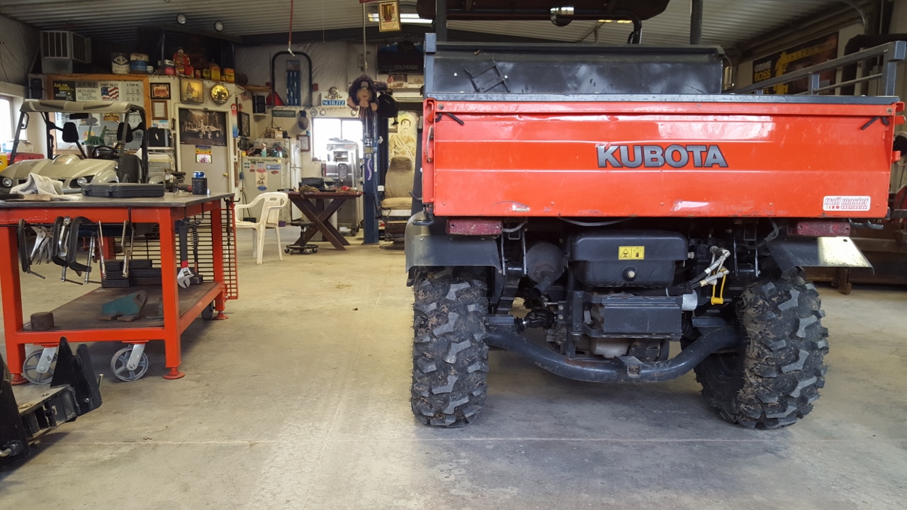

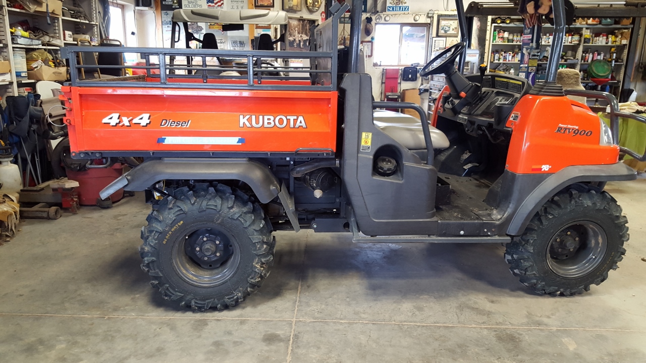

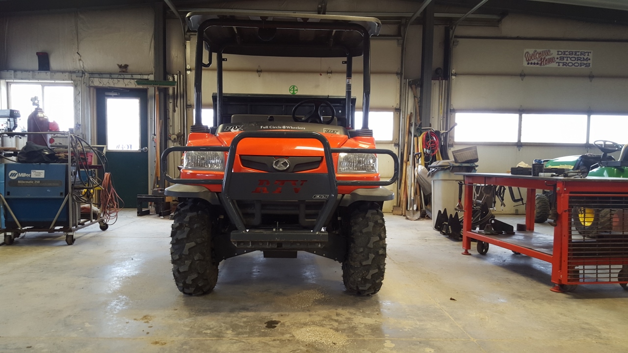

I have a sister to your machine, 08 model. They are what's called the "worksite" model. Those tires suck!!!!! They suck worse than any tire I've ever owned in mud!!!!!
I replaced mine with ITP Blackwater Evolution tires, 27x9 on front, 27x11 on rear. Should have did 11 on both ends. Was worried about rubbing.
I also built an inch lift kit. Very easy to do.
Lastly added 1.5" spacers on front, 1" on rear.
Now the machine gets around a lot better in mud, has more ground clearance and is just as stable on sidehills.
None of these pics are after adding the spacers. Sorry.
