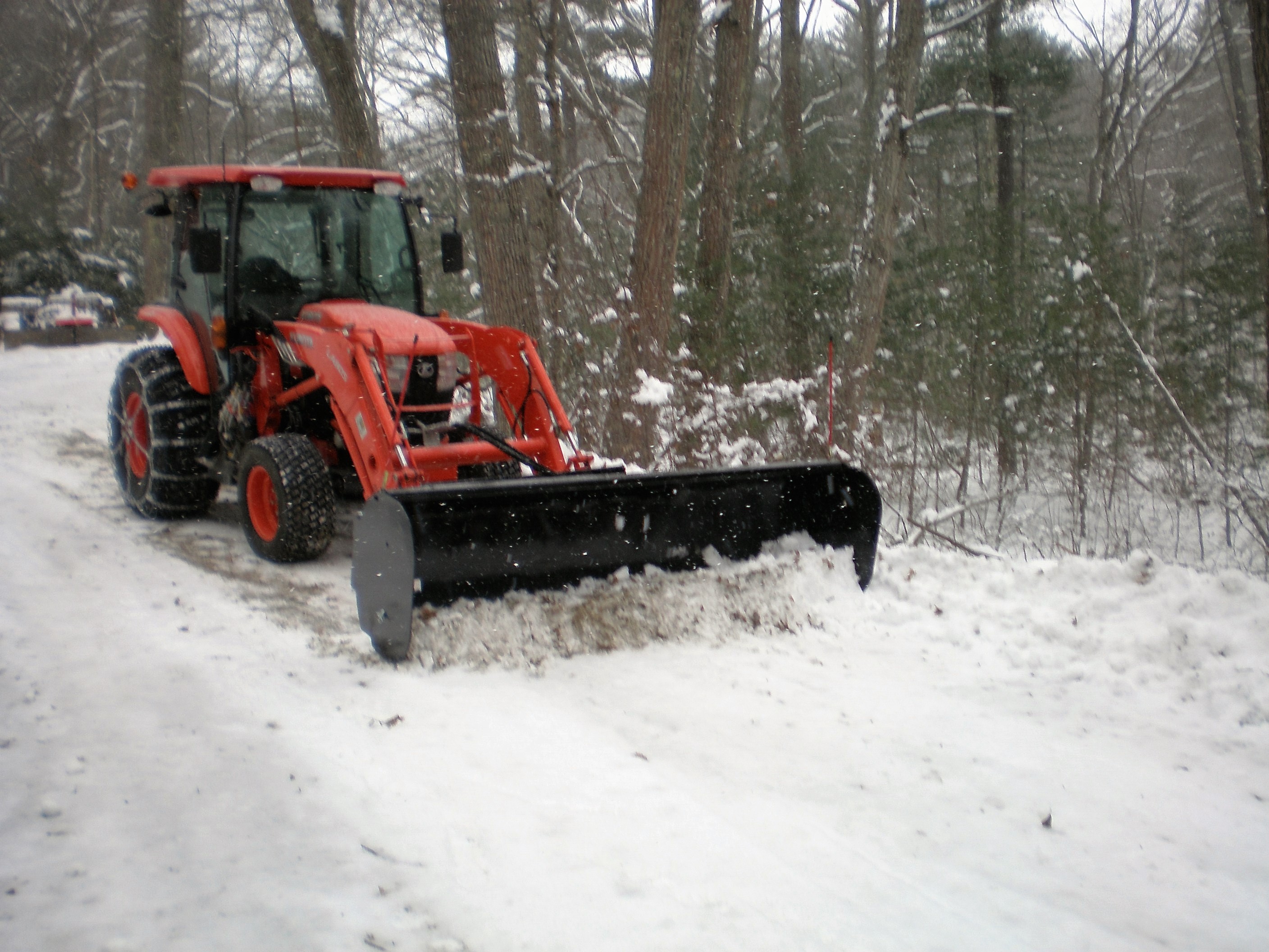

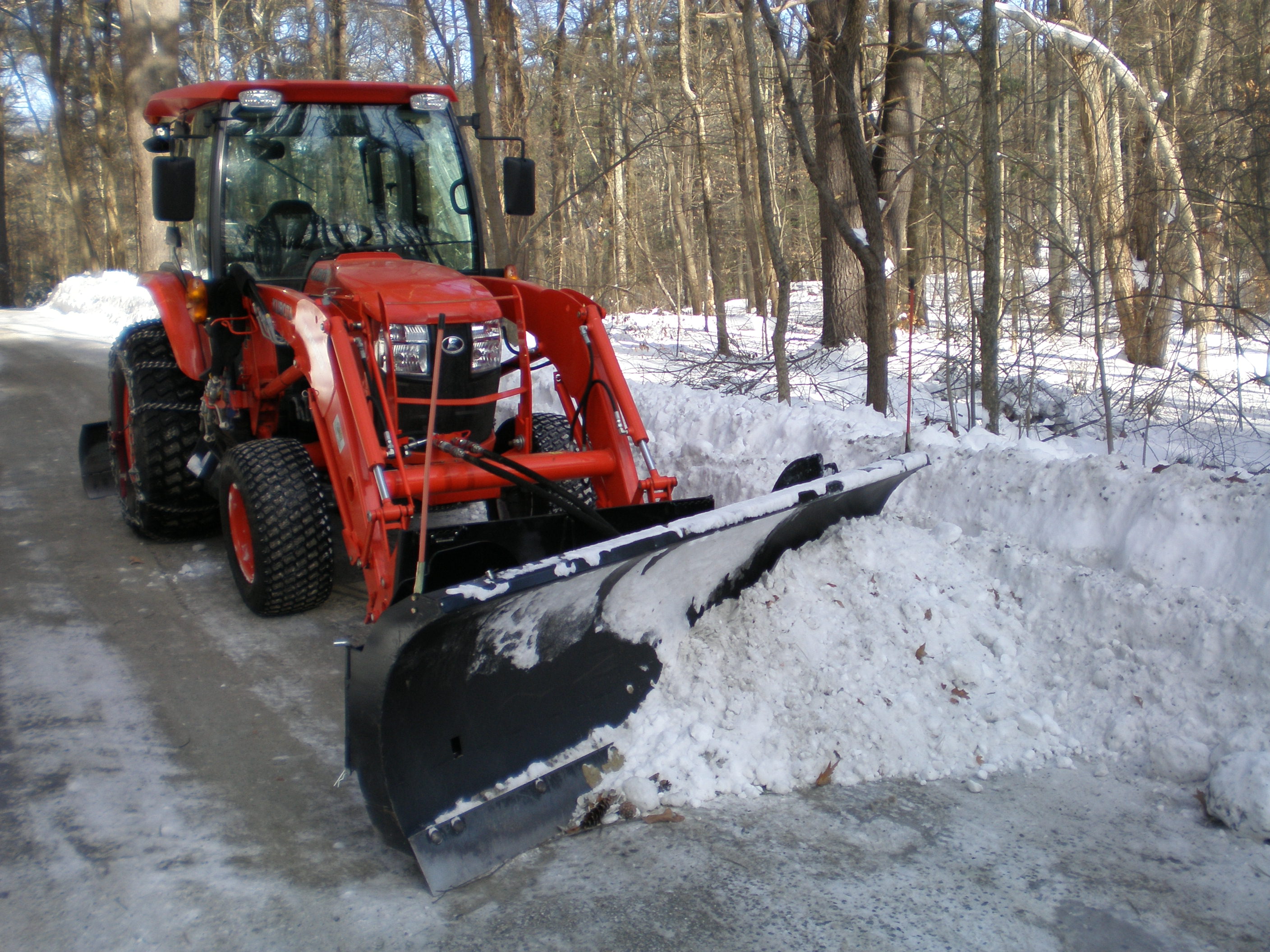

I have a 1000' gravel driveway and use a plow I bought from QuickAttach that converts to a pusher with retractable wings. Like nybirdman said, pusher's are for parking lots, you'll use the blade much more than the pusher in residential use. P1060004.JPGP1260005 (4).JPG
