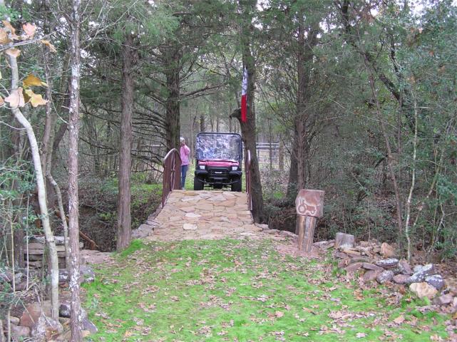

   / 9-25-04 memory stone how to: #16
The final resting spot for one of the stones, by the bridge over a gully in the woods in Lee County Texas.
Thanks Harvey!
   / 9-25-04 memory stone how to: #17
Good pic. Is that the project bridge yall built awhile back (where W_Harv and others helped)?
