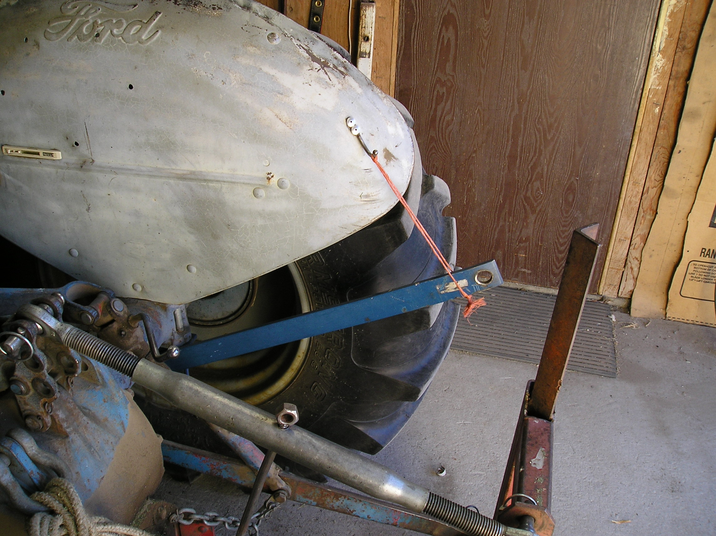

Here is what I have done to remedy your problem... Dave
