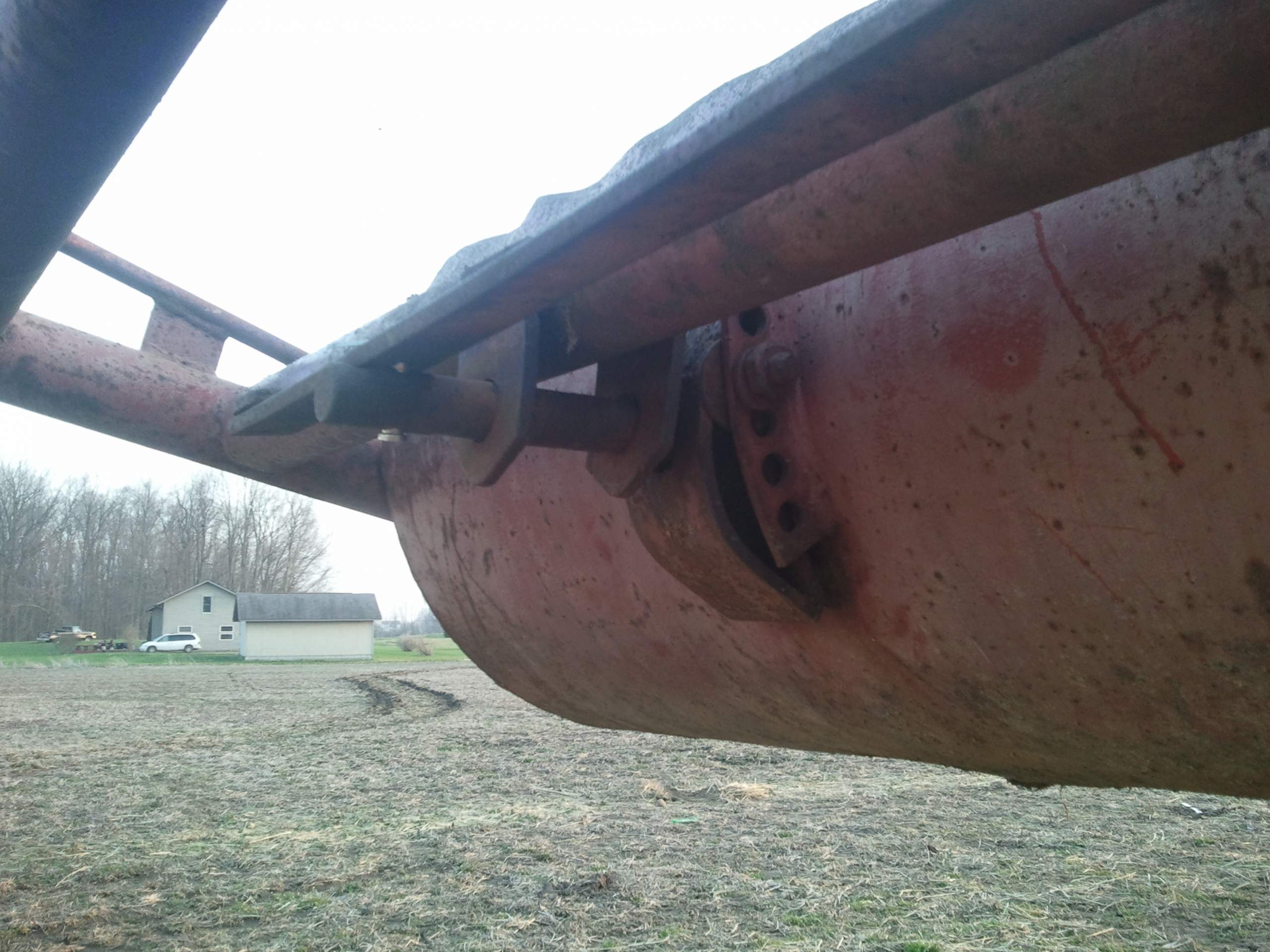

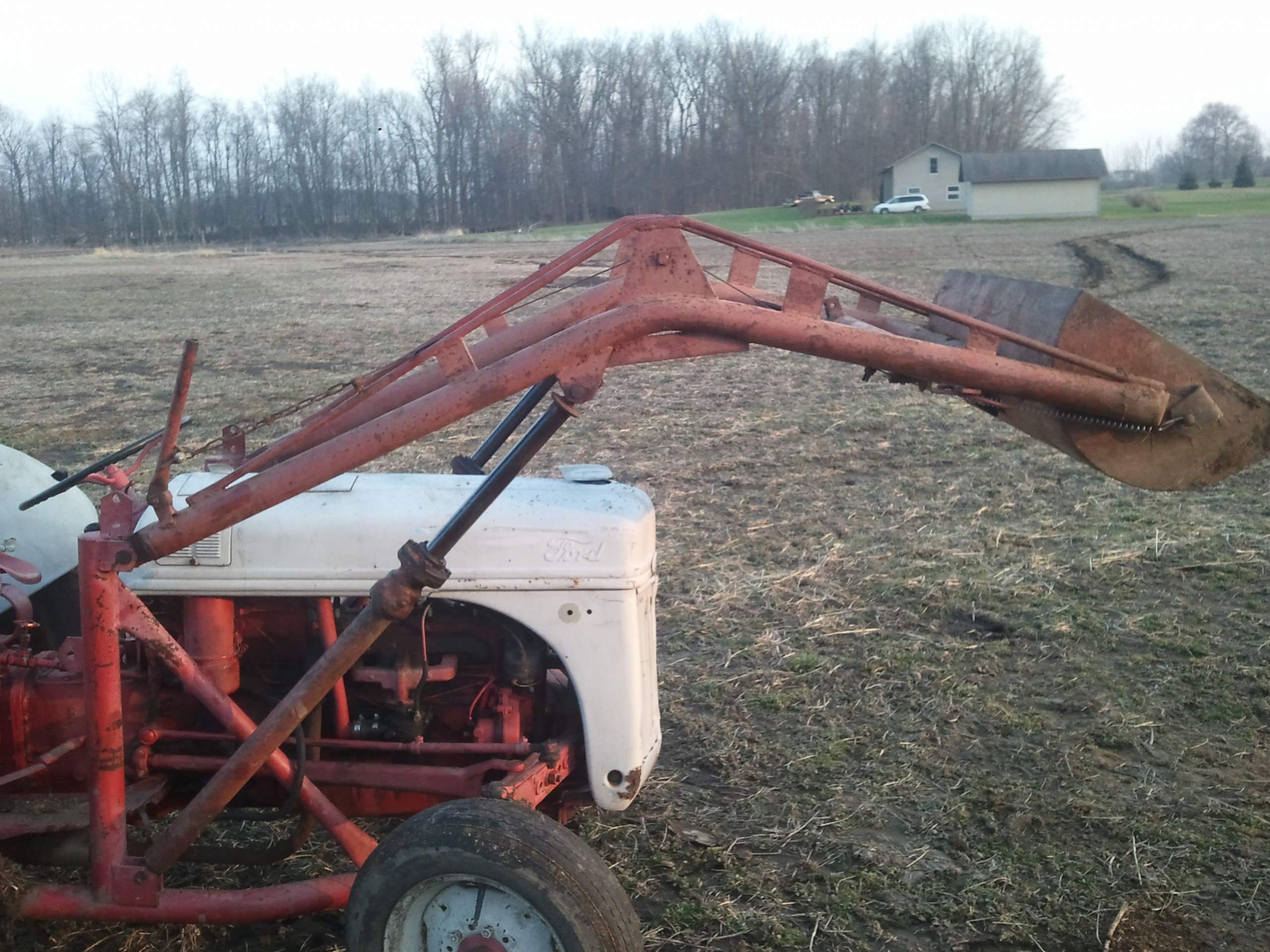

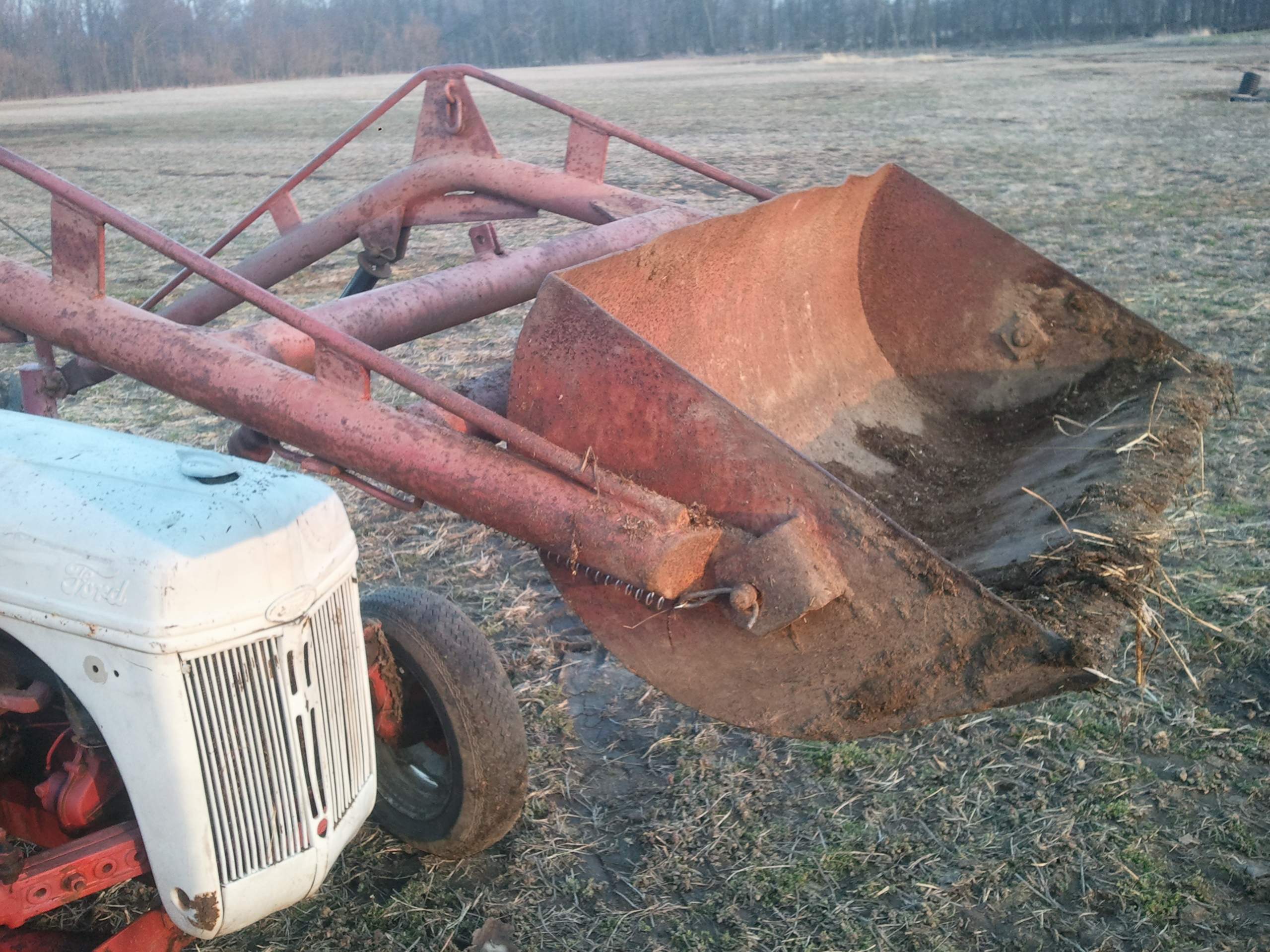

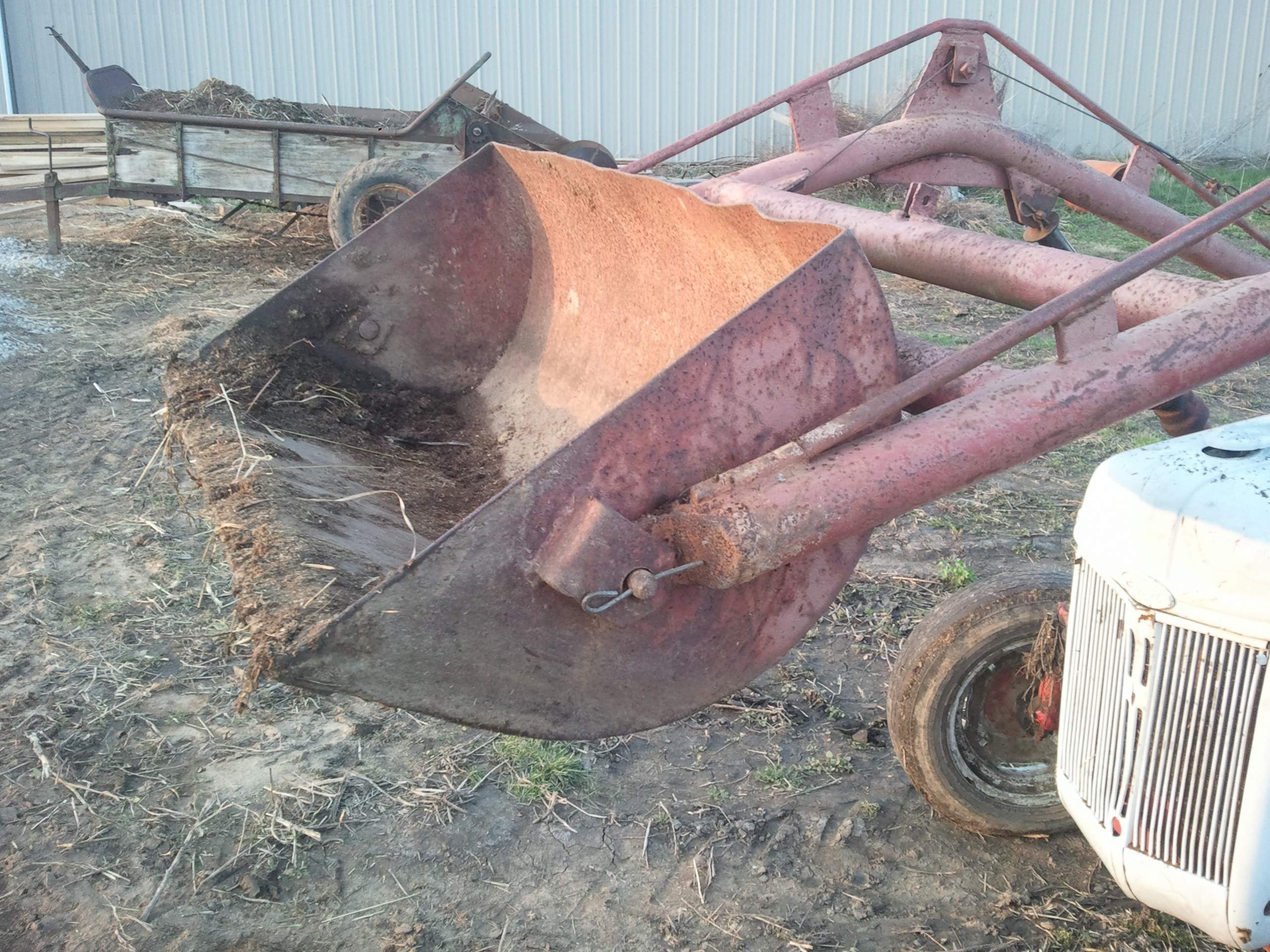

/ 8N Loader trip mechanism
See pics for loader.

/ 8N Loader trip mechanism #8
no wonder it's dumping backwards.. change the angle on the bucket. roll it forward a hole and check...
ps.. that spring setup needs work.. attach it closer.. much closer.. that spring is likely worthless in that setup.
work onthe pull cable routeing geometry it it is having problems pulling the lever that pulls the pin to dump.
