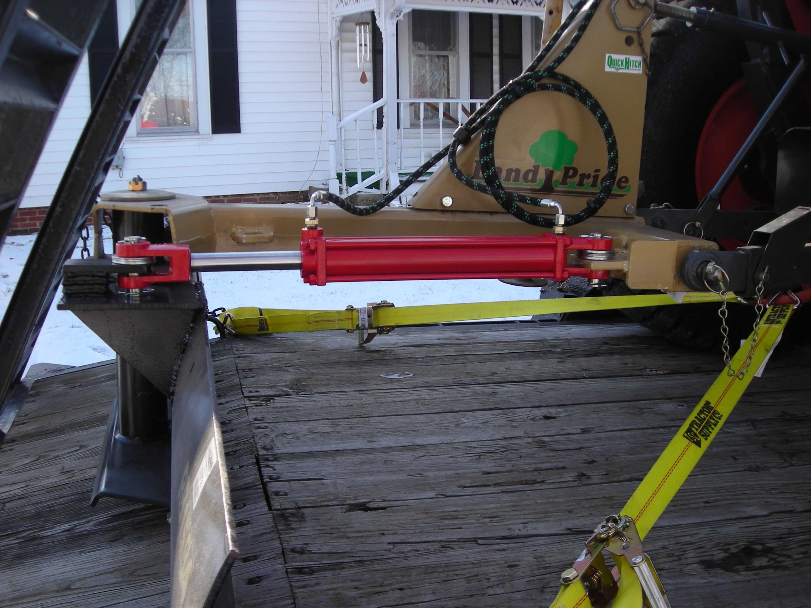

Just my :2cents:. But I feel that a good medium duty 96" blade would work great with your tractor. If you can get one that is in the 600-800lb range you would be pretty happy with it I think. As was already mentioned, any good blade is going to have a boom long enough to be able to pivot 360 degrees. I have a 108" blade and it pivots 360 and I believe that even their 10 footer does also. Take a look at these models of Land Pride just to get an idea of what you should be looking for.
Land Pride RB35 Series Rear Blades This blade is close to doing a 360, would need to double check with Land Pride to verify.
Land Pride RBT35 Series Rear Blades This blade would be the one to get if you can swing it. Very good blade.
Other manufacturers have similar blades, this were listed to give you an idea.
Remember, when it comes to new implements, you usually get what you pay for. ;)

Blades are rated to match horsepower. I would be very careful to buy a blade heavy duty enough for your tractor. If you bend it, it is worthless. I like the Landpride that was mentioned. Wish I had one! You also may want to consider adding hydraulics to control the tilt and angle. It adds more costs, but will vastly improve the function if you are expecting grading that requires finesse. Please let us know what you decide and how it works.
