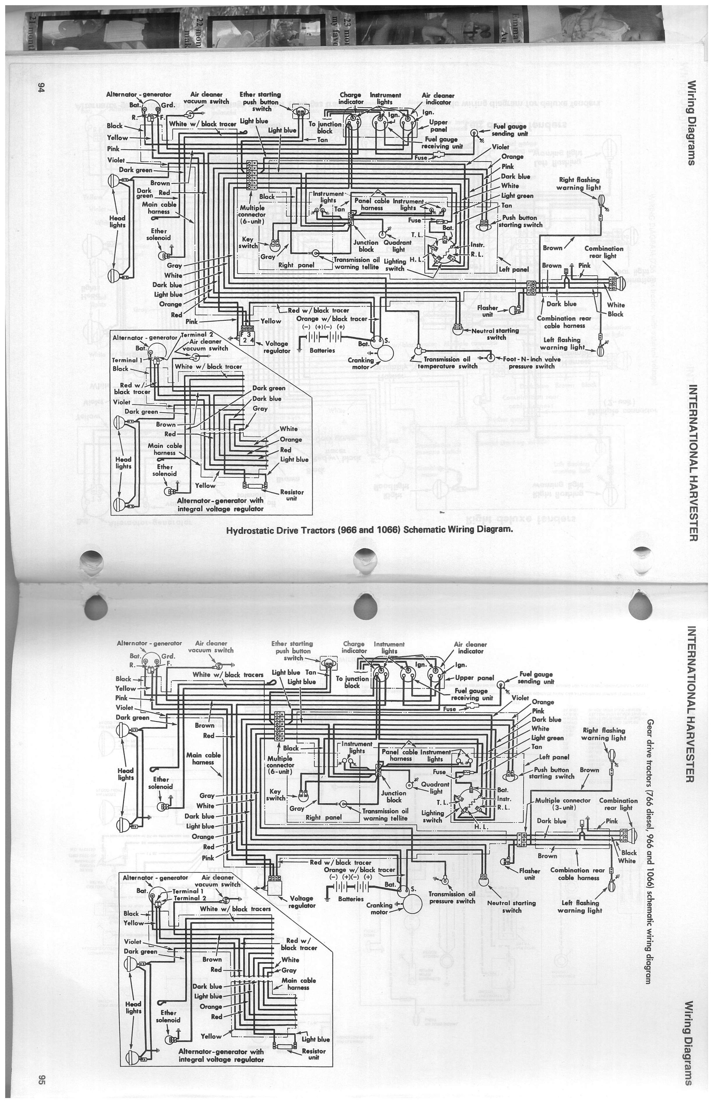

Like I said, the manual I have is a condensed service manual and covers about 12 tractors from around 3 series. The labels on the attached images don't say 886, but I assume it's the same for the 886 and other IH tractors covered in this manual.

Success! I got the batteries tested and one needed a charge. I charged them and went out do some testing. I probed around on my key switch. I got .03 ohms resistance on the switch and then installed the batteries. I could get 12v to the switch, but with the switch in the start position (not run) I couldn't get 12v on any other terminals on the switch. This didn't make sense to me. With the tractor in neutral, I manually depressed the starter safety switch that is normally depressed by the clutch, but still no 12v on any of the other terminal on the switch. I decided to move on and get access to the starter and noticed a wire lose on the solenoid. After carefully tightening that nut, the light that normally comes on when you first turn the key to the run position without starting came on. The tractor cranked right up. I was just about to try the direct application of 12v to the solenoid to bypass the switch and was glad to not have to try that. Thanks for your help and willingness to help.
