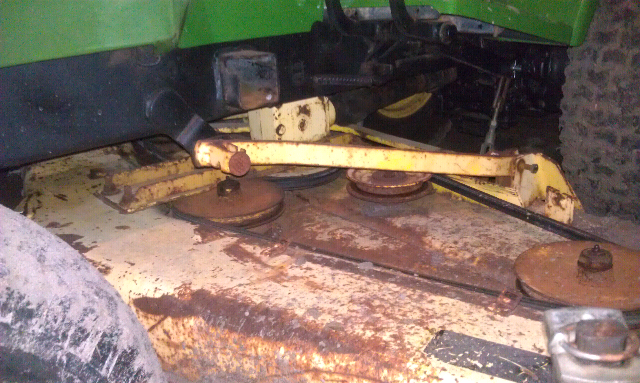

Hey all, just bought an 88 855 2wd, came with a 4' box blade and a 72" mowing deck and I got for a steal. In any case, I'm trying to ID the mowing deck so I can get a new belt. This belt has a huge chunk out of it.
My problem is I don't know which deck this is. Much research has shown me that there are three different decks with 4 different belts.
I'm hoping somebody can help me go about a positive ID on this deck. Should there be a plate, serial number, etc I can check?
Thanks!

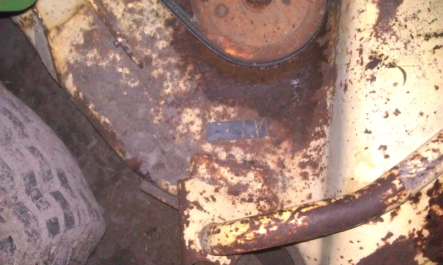

   / 88 855 - mowing deck id #2
yes it will have a Deere Serial number tag, on most decks like this it is near a caster wheel mount. Should be silver w/ black writing about 1 x 3"
I'm guessing that plate would have been..... here?
Oh well, I may just remove the belt that's on there now and measure it.

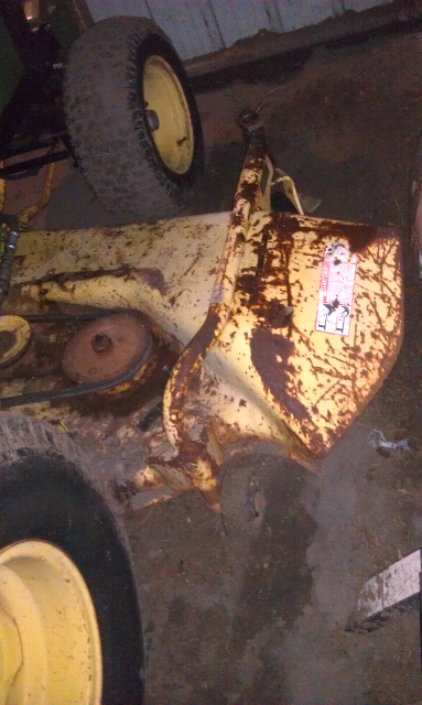

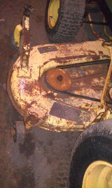

If it helps, here's a couple more pics...

   / 88 855 - mowing deck id #5
With the "formed" discharge chute made to the deck, I'm guessing yours should be one of these
72" MID-MOUNT ROTARY MOWER
(855 COMPACT UTILITY TRACTOR)
1986 MODEL (SN M00296X537001-555000)
1987 MODEL (SN M00296X555001-575000)
1988 MODEL (SN M00296X575001-595000)
M89884 should be the belt, it's gonna hurt! Best I remember it's around $140.00

Is that not the id tag on the outside of the front right wheel support? If I remember correctly that where mine used to be.
Many many thanks to you both! It is the 1988, and the I'd tag was right on that front right support.
