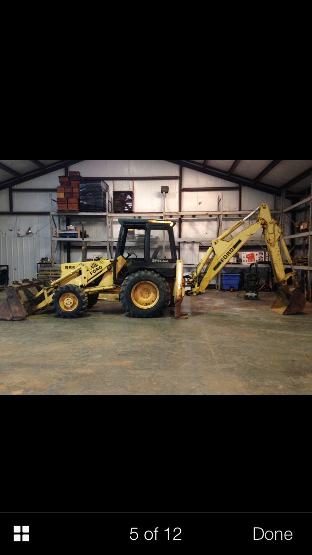

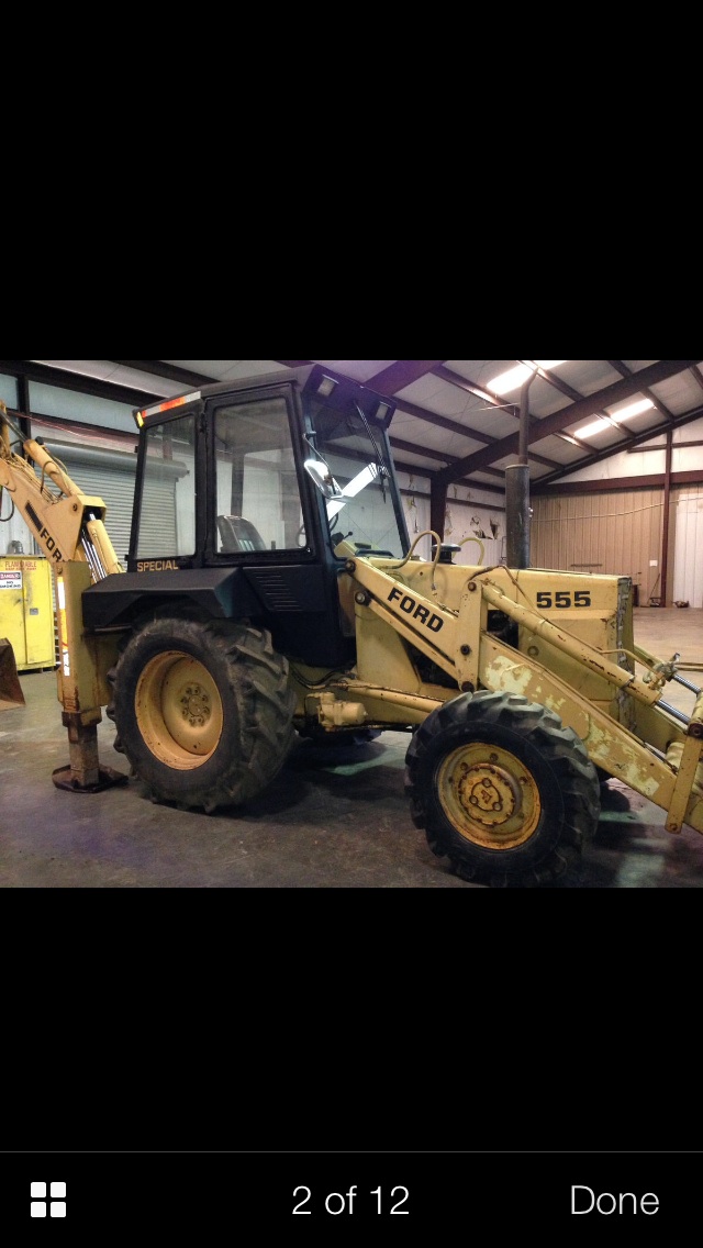

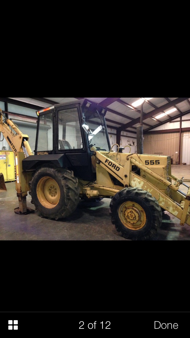

I've recently purchased about 60 acres of wooded, hilly land here in Southern Indiana, where I plan to build a home. I'm looking for a used backhoe to get things going with. My first job will be to cut a road and clear some land, and this is all very hilly, wooded land. I'll need something big enough to push over some rather large trees. The next job will be to dig for septic, trench for electric, then I'm not sure how much of the foundation / building digging I'll do myself, we'll just have to see when the time comes. I've been doing my homework and I'm pretty sure that 4WD and a 4 in 1 bucket are necessities for me, and the extendahoe would certainly be nice. I've got my eye on an 86 Ford 555 Special, and was hoping I could get some general input from you all on it.

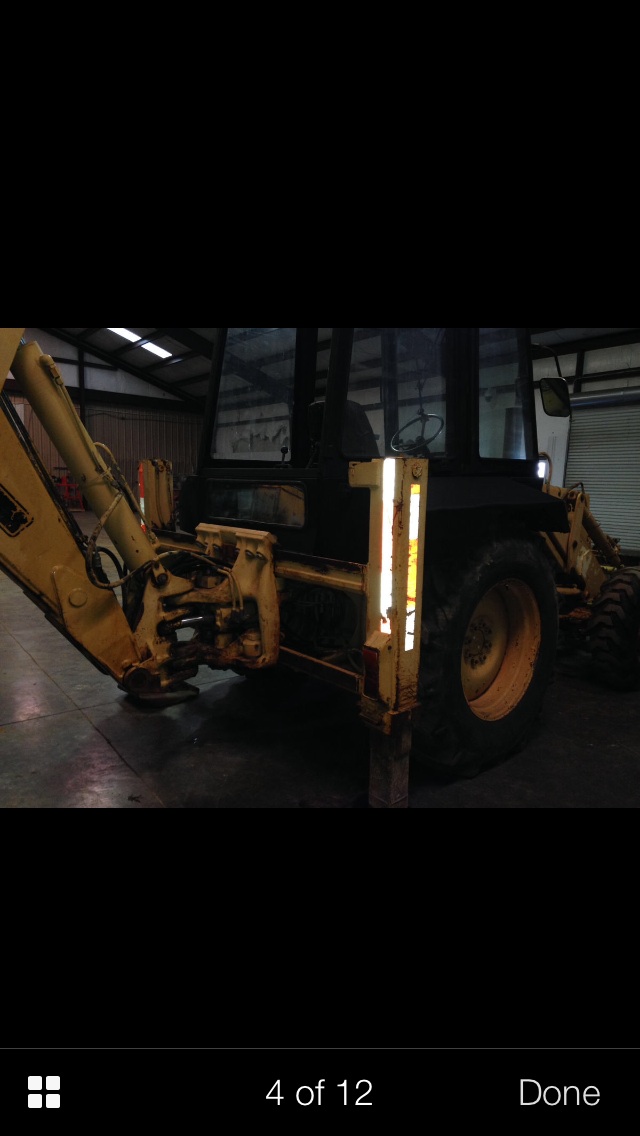

It's 4WD, 4 in 1 bucket, and extendahoe. Says it has 2800 hours, 15,000 miles on it. I talked to the guy who has it, and he said he's just a reseller, didn't know much about the history of it, but he said he operated it, and everything worked, except he said the boom on this backhoe moves side-to-side, and he couldn't figure out how to operate that part of it. He also said that one of the clamps on this side-to-side mechanism is leaking a little, as is the dipper cylinder. Other than that, he says this thing is in good shape. Asking $13,500, and it's about 270 miles from me, so I'll have to figure out what delivery would be - anyone have input on that?
I've never operated a backhoe, or any larger equipment. I'm not concerned about that, I'll figure it out, but I won't know what to look for if I go look at this thing, or how to operate it. Any advice there would be helpful. I've worked maintenance in an engine reman facility in the past, so hydraulics are no mystery to me, I'll feel comfortable checking all that out, and fixing what needs it. My main question is, how do I run the thing? And is there anything in-particular I should know about this specific model machine? And, if anyone in south-central Tennessee that's experienced would like to earn a few bucks, I might be willing to pay for a professional opinion.

The price for the machine seems really good. The side shift backhoe is useful for working in tight quarters. However the stabilizers that go straight down do not provide as much stability as the arm style outriggers. The tires look in good shape, and the price is a steal. I do not know how he got the miles as they do not have an odometer. Ford 555 parts are easy to find. I would buy that if I needed a backhoe!

I thought it was odd to see mileage too, but there is a picture of the speedometer, and it has an odometer in it. Thanks for the replies, guys! I was beginning to wonder if anyone was going to talk to me.. Looks like I'll be going to take a look at it this week.

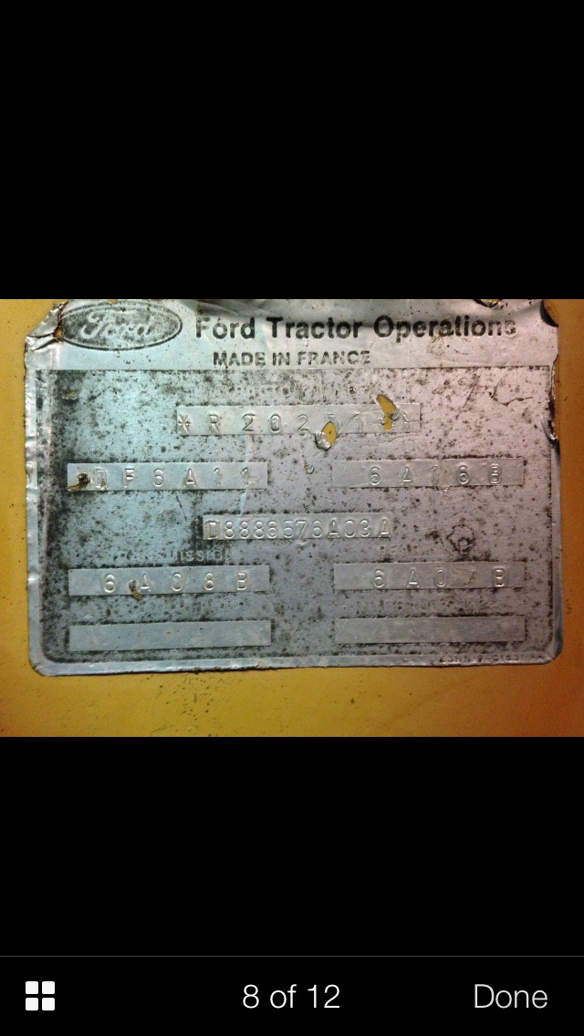

Speedometer and side shift tell me that this machine was built for a market other than North America. I'd question how many side shift specific parts are available here, as I have never seen or heard of one in my area, and the dealership I work at has been here over 40 years and sold literally hundreds of Ford and NH TLB's.

Interesting thought. I have the serial no, would that show where it was sold? Anyone on here know where I could look that up? I'll ask around, see what local dealers have available for parts.
/ 86 Ford 555 Special Backhoe #7
This is looking like a European spec machine. I would see what type of engine it has in it. This might be an entirely different machine than the US spec 555. That would explain the price difference if the parts where hard to find. What is even more confusing is that the odometer is in miles. The data plate says "made in France". Perhaps this was a European unit brought into the US hence the "special"?

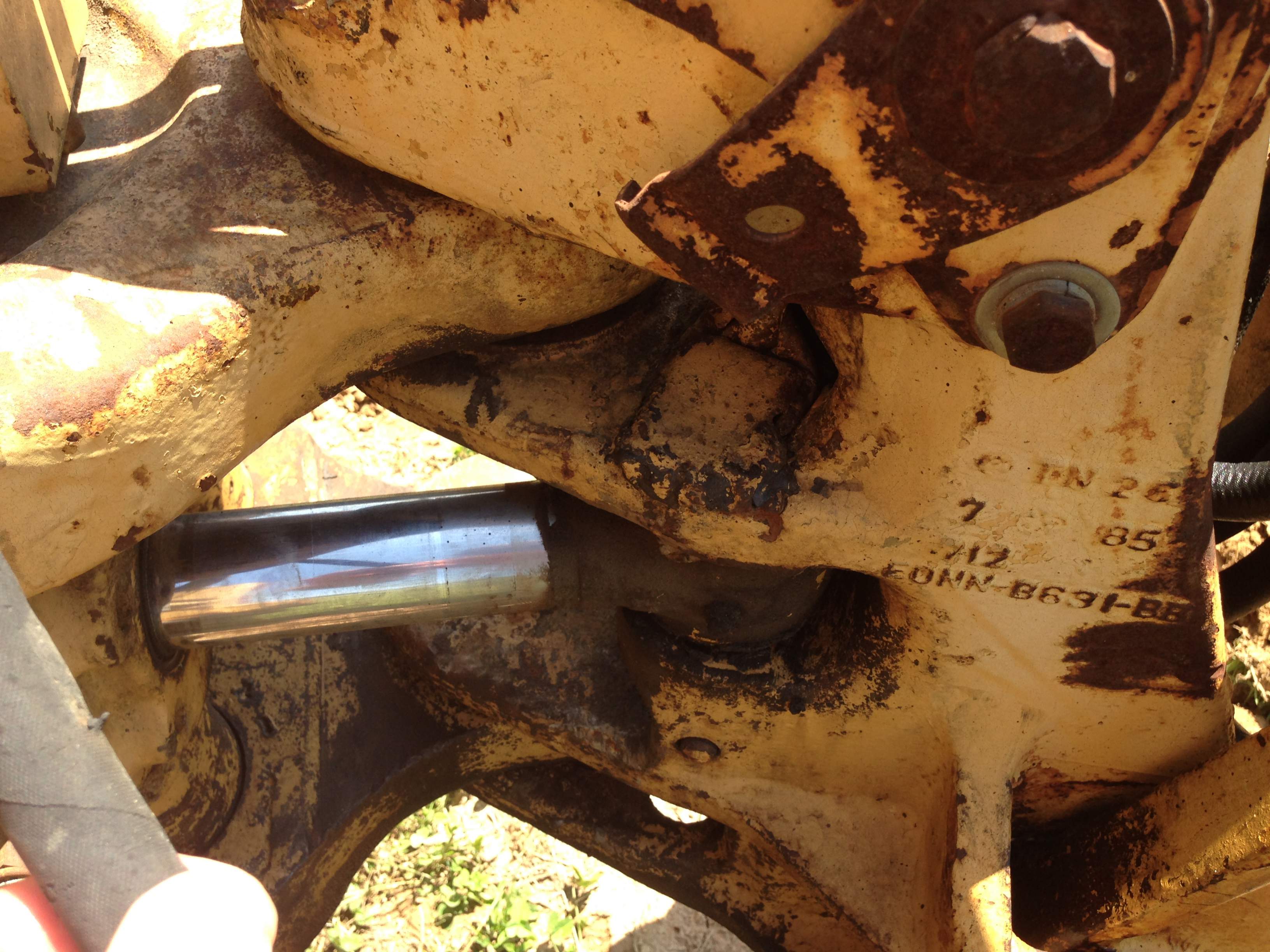

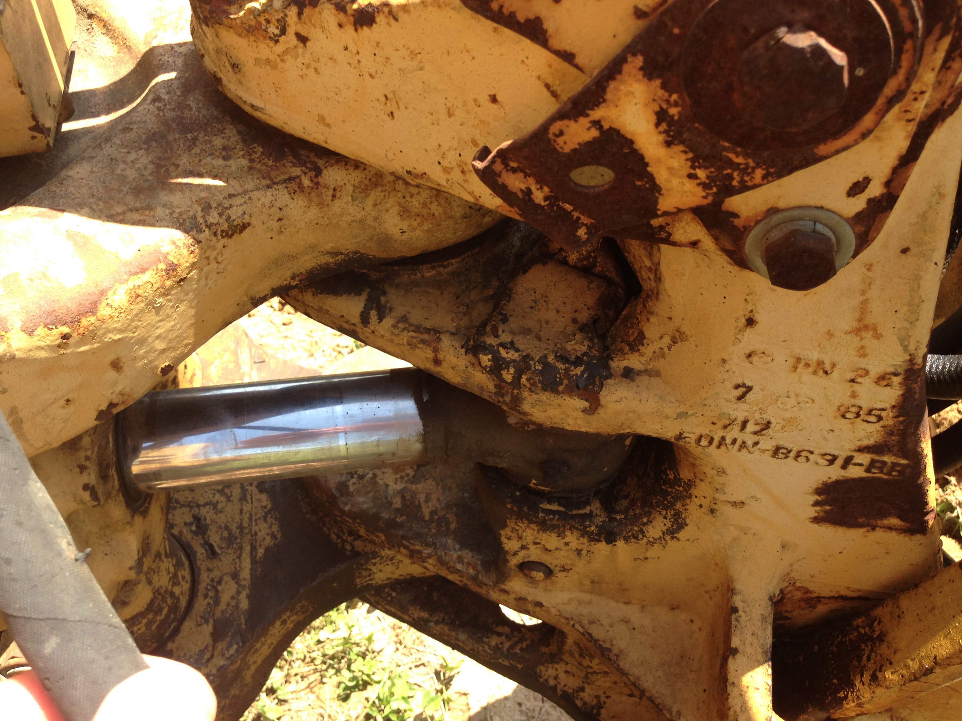

First of all, there are several cylinders leaking. The worst leak is the clamp cylinder for the side shift mechanism. I ran the machine for about an hour, and there was a patch of fluid leaked on the ground afterward. I'd say the cylinder was leaking at a rate of about 1 drip every 5 seconds... A considerable leak.
The dipper cylinder also has a fairly considerable leak, and I found that it actually has some surface rust on the cylinder shaft, obviously causing hte leak. This isn't leaking as bad as the clamp, but still running down the boom.
One of the boom swing cylinders had oil on the cylinder shaft, but wasn't enough to drip.
One of the stabilizers had fluid on it, I'm guessing from a leaking cylinder.
Both power steering cylinders had oil on the shafts.
One of the front bucket clamshell cylinders had an oily film on the cylinder shaft / not really bad.
I don't know what's normal, or acceptable as far as leaking cylinders. I have an industrial factory maintenance background, and any of these leaks would have been an issue and put on the list to be fixed. Is some level of leaking acceptable on a backhoe? How quickly would a leak like these progress?
Possibly more concerning is that I found what I would classify as considerable play in a few of the pins / bushings. I have videos and pictures below that will show it. The two boom swing pins were my biggest concern. What is the remaining life expectancy of these? How hard / how much would it be to replace them? The play in the bucket bushings seems less concerning, because it should be easier to get to them and do repairs..

Also, for some unknown reason, they welded a plate on top of one of the pins / bushings.

Looks normal for an old machine and tighter than my 1983 JD 310b 60 HP backhoe. I replace hoses when they blow or I have to remove them to address another issue. What kind of price is the seller wanting?
