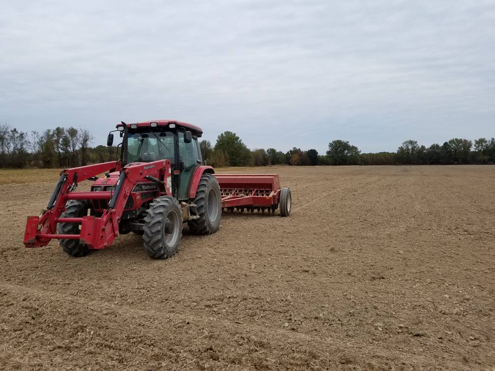

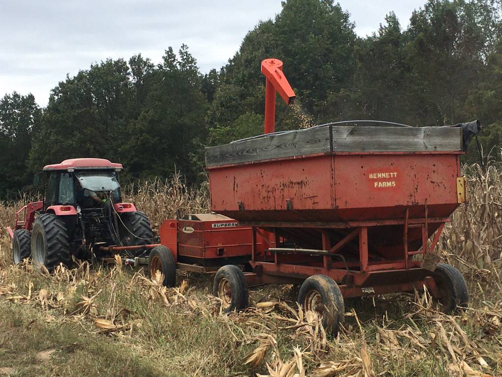

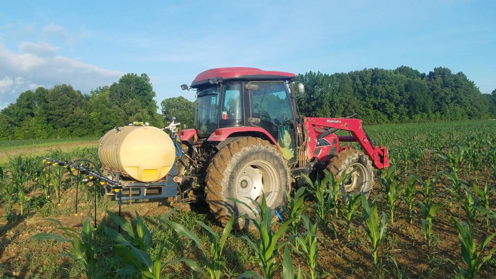

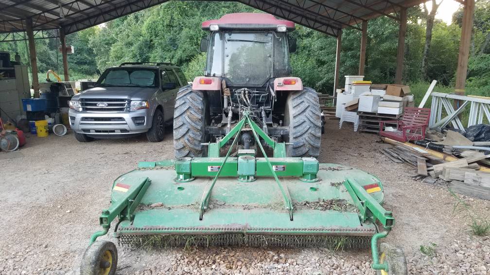

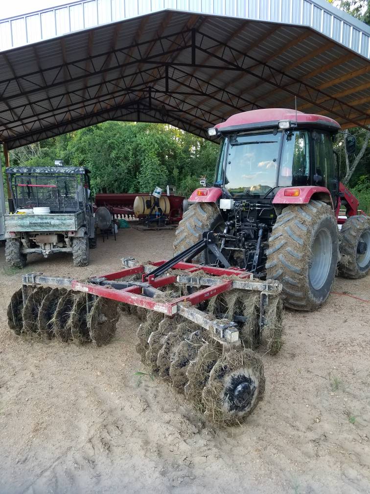

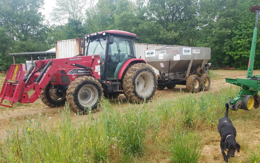

I have a 8560 that gets used.
It is a stout machine, gearing is mechanical so no shift on the go under load.
I disk, plant, 3p sprayer, harvest and mow with it.
Keep clean fresh fuel in tank, service and grease per manual.
Put almost 500 hrs on it without any issue other than fuel line from tank to pump had pinhole that lost prime. Easy fix.
FEL is strong but slow.
Cons-
Uses 2+ gal/hr fuel under load.
Needs more gears for constant speed control (spraying/fertilizer application)
Cab is small but functional.
Condenser coils have to be kept clean for cold AC
(Radiator Genie every 10 hrs)
Good tractor IMHO 20190628_191048.jpeg20190501_135536.jpegView attachment 62999720190902_190343.jpeg20171031_150749_001.jpeg20170730_190107.jpegIMG_0881.jpeg
