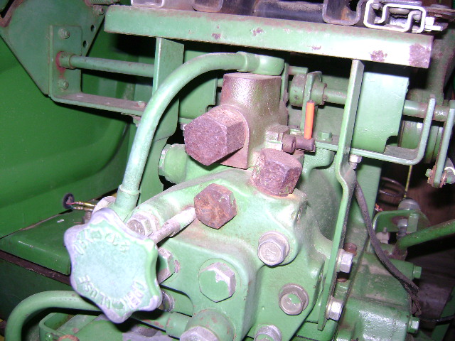

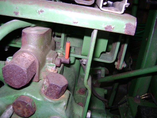

The knob under the seat is just a shutoff valve, there should be a small lever type thing just above it. This lever will control your rate of drop and speed, maybe not making myself clear. The knob should be open all the way always except for cold weather warm ups for the hydraulic fluid as specified in the operators manual. I will try to get a picture and post it later today.

The red lever is the speed of drop control for lighter or heavier implements. Forward slows the rockshaft drop, rearward increases the speed of drop from the owners manual.

yes, I have noticed the red lever, I had not recognized as a lever though. It is and has been in a vertical position like yer photo. I am understanding this as the position. No power steering. I am having a hard time finding manual believe it or not. (although I have not yet visited a dealership).
After cranking this evening, it was very sluggish, it did lift a couple times (while on a maybe 2000 rpm idle) but lost lift pretty much after a couple.

Ok, the red lever located under seat does function. When set all the way 'forward, 3pt raises but does not lower implement (as far as I could tell), when set all the way 'back, it acts the same. When set to a vertical position (like the photos above), 3pt performs.
