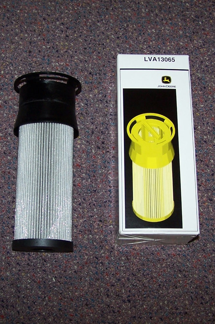

I decided to change the engine oil and filter, and the hydro fluid and filter at 50 hours. It's not really due until 200 and 400 hours respectively. But I figured it would be cheap insurance. Turns out this insurance really is not that cheap.
The attached bill shows a total parts cost of $220.20. The single biggest expense was the hydro filter, which is $85.49. This is not a typo. My dealer is a relatively high volume CUT dealer with two locations. They did not have this filter in stock and had NEVER SOLD ONE BEFORE! The parts guy said people don't bother to change this filter because it costs too much.
Is this true? Has anyone else ever changed this filter on their 3X20?

That filter is more like a screen that can be re used. I had it on my Ford 1700. It is basically on mine was a stainless steel pleated filter much finer than my electric shaver screen. I used a toot brush and some diesel fuel and I cleaned to new condition,

KB, for what it's worth, my 3320 was coming up on 50 hours and I looked at the individual prices for the filters and almost croaked. I did find a filter kit on e-bay that contained two engine oil filters, one hydraulic filter, one air filter and one fuel filter for "buy-it-now" price of $119 shipped UPS ground for $10.75 total $129.75. Looking at JDParts, the individual part prices are...
Filters Air, engine primary RE68048 $22.99
Filters Fuel filter MIU800645 $12.04
Filters Oil, engine M806419 $7.56
Filters Hydraulic filter LVA13065 $92.96
Total, $143.11 w/ TN tax $156.35
The seller's handle is "thegreendealer".
Not a whole lot in savings but sure better than a poke in the eye with a sharp stick, I guess.

Folks, change your engine and hydraulic oils & filters at the first 50-hours. Also CLEAN the hydraulic internal screen, This gets out most of the metal shavings that was in the interior housings when it was milled at the factory.
Then change your engine oil & filter every 100 hrs. up to 500 hrs. using any good diesel engine oil. Then use Delvac 1 made by Mobil and start the change interval at every 200 hrs.
Change your Hydraulic oil, filter and clean the internal screen every 400 hrs. and use JD Hy guard Low visc.

I am about to hit 200hrs myself. I bought the $100 kit from my dealer that included the $85 trans filter. I think this kit is the only way to buy filters for the 3X20s. My dealer after ordering my kit said they will be doing the same for their fluid changes in teh spring since it such a good value. They did not know it existed for the 3X20 series until I had them order mine.
