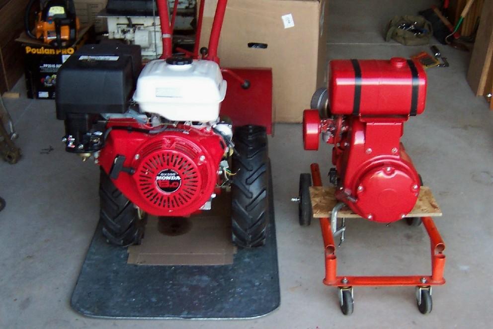

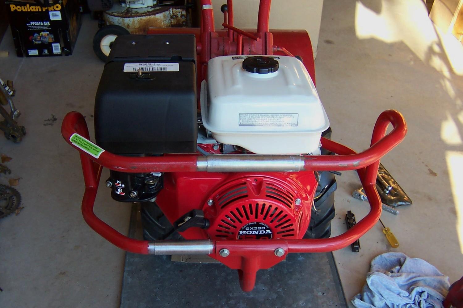

I replaced the 7 HP Kohler engine on my Horse tiller with this 13 HP Honda engine.
I've since named my tiller: "Atilla the BeastMaster"
More Power!

Hello Crazy,
That looks like a very neat installation to one of the best TroyBilt Models. I especially like the way you reworked the bumper. People forget that the TroyBilt sold well over a million just Horse model tillers before being acquired by MTD in 2001. I good solid 1980's to early 1990s Horse tiller is well worth restoring and maintaining. Thanks for sharing your update to a 29 year TroyBilt. Enjoy Atilla

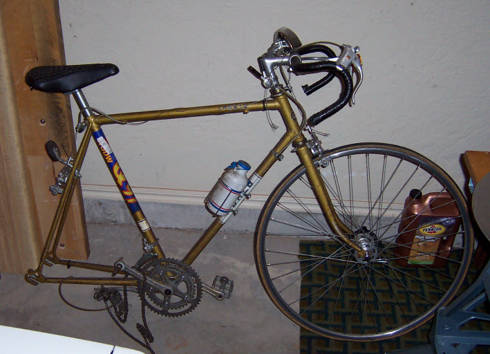

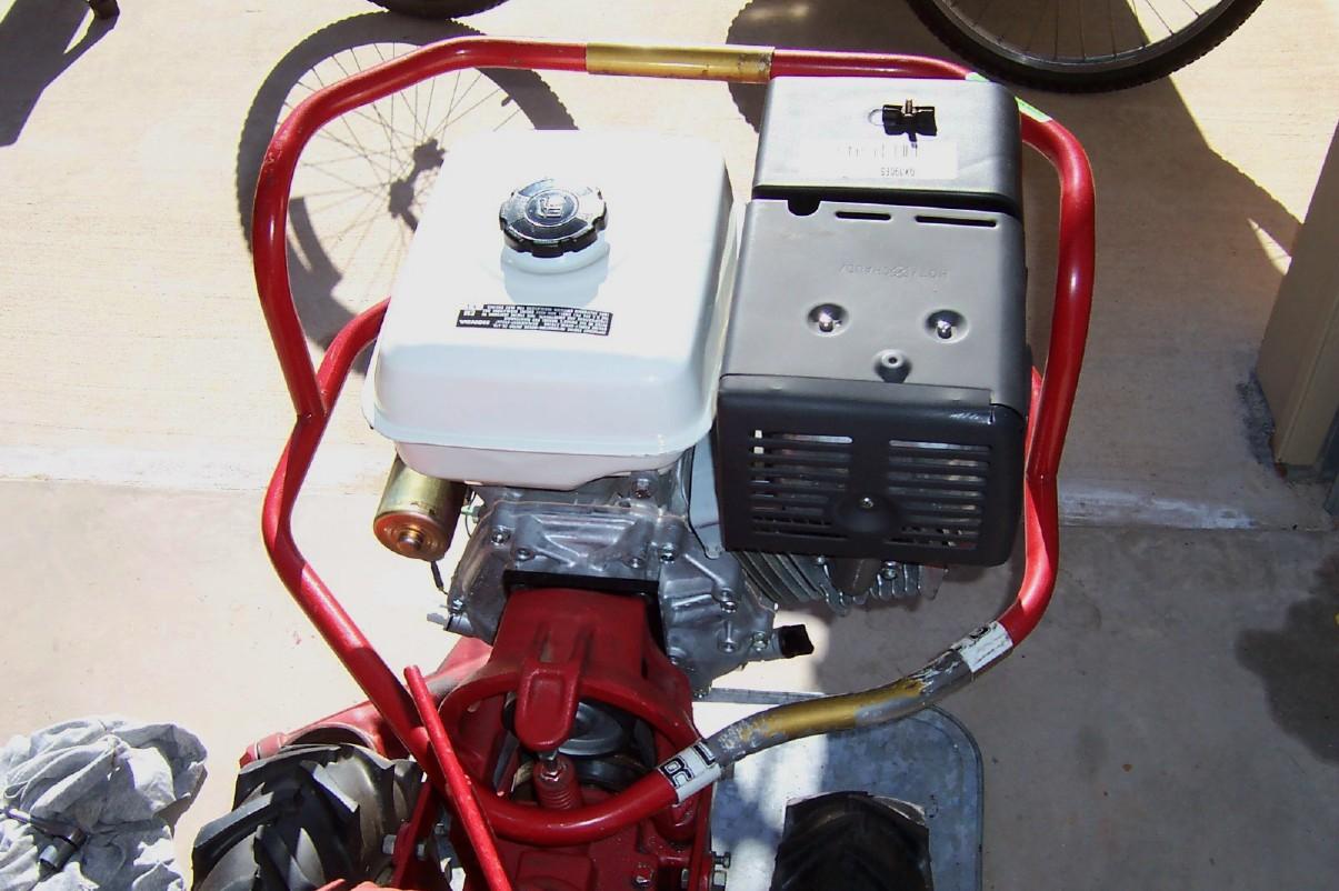

Thanks BCSHOP and good eye spotting the bumper mod. Just in case anyone wishes to do something similar I'm posting some pics of the process. I used a junk bike frame for donor tubing and formed it with a 3/4" electricians pipe bender. JB Weld holds it all together.
I'm looking forward to plunging Atilla's tines deep into the fertile Oklahoma soil.

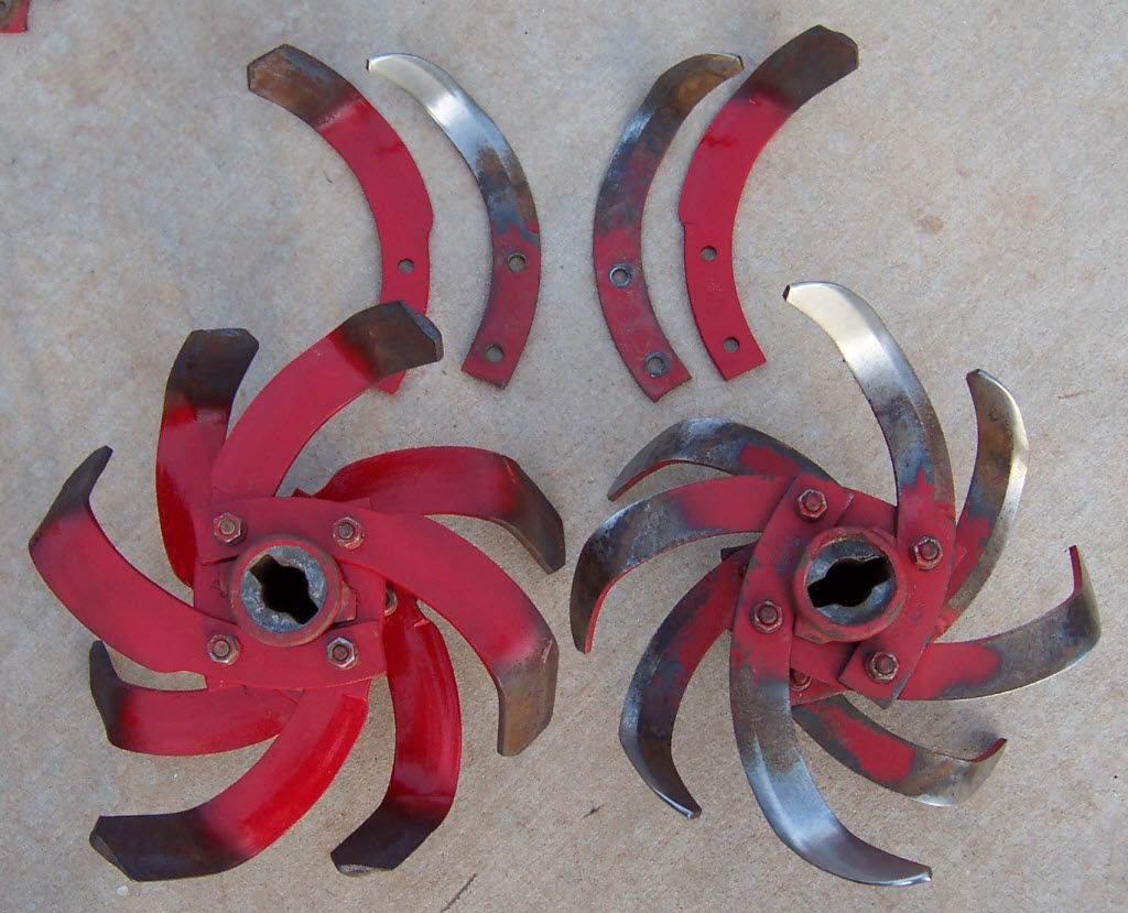

On this site: http://www.mytractorforum.com/showthread.php?t=153157 there is a PDF file that shows the 7 HP was availiable from 78 on and somewhere around 87 the 8 HP Kohler Magnum was offered. I like the 7HP Kohler but I'm tilling deep in heavy clay with the HD custom tilling tines and it really is hard on the 7 HP. See attached picture for comparison of the standard vs HD tines. With the HD tines you're moving a lot more soil. I laugh when I see some of the tiller demos on Youtube. The soil looks like sandy compost. Who has soil like that anyway.
My plan is to rebuild the 7 HP Kohler and keep it for awhile. Maybe I can pick up a TB tiller with a bad engine and repower it.
