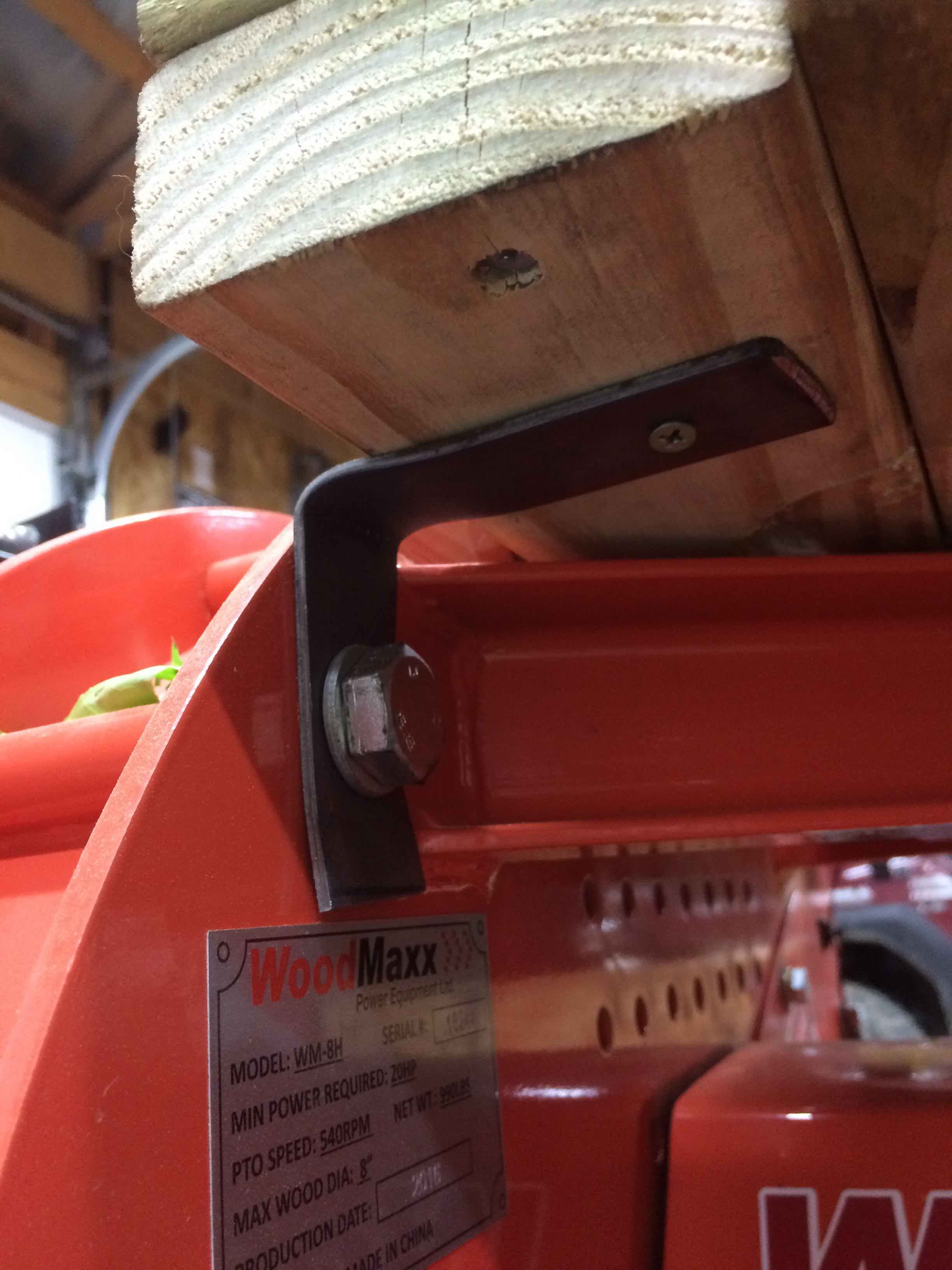

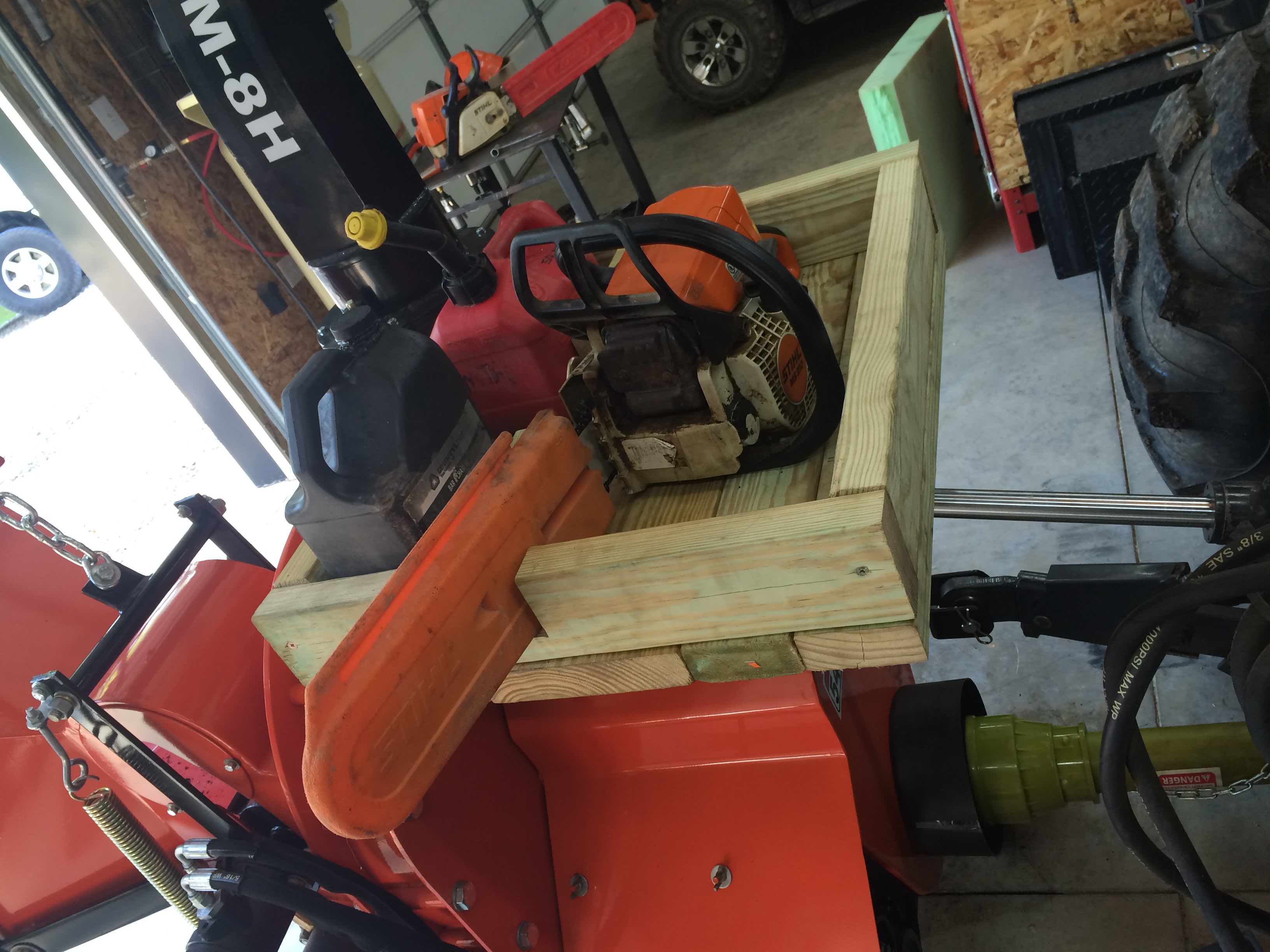

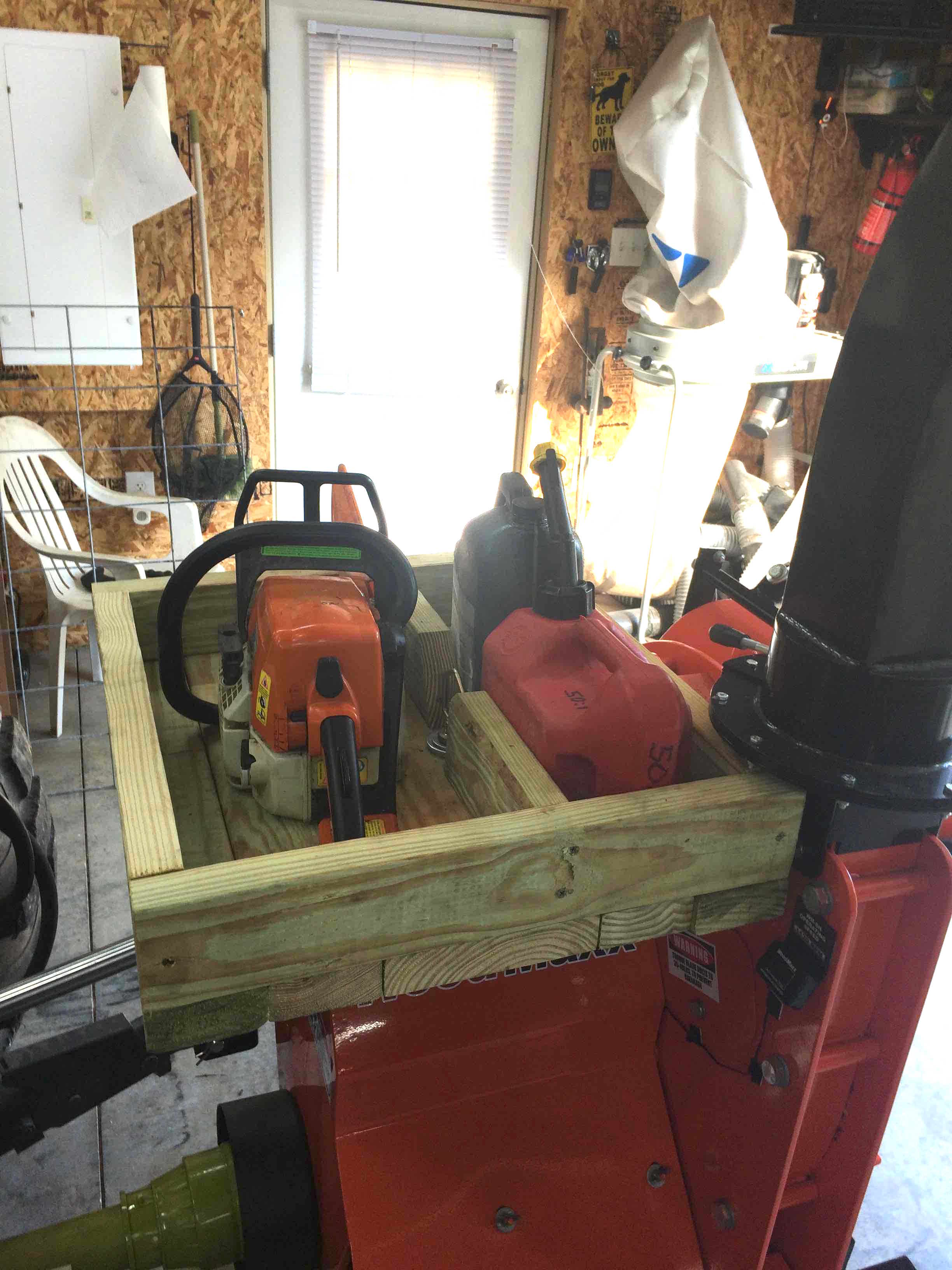

The one thing I noticed when I was chipping is I need my chain saw/oil/gas so I can cut some other trees and get them cleaned up. Off to the shop we went for a quick addition. Here is what we came up with. Nothing fancy, just used some left over wood from the archery target holder I build for my son. I mounted it with one "L" bracket that uses an existing bolt on the chipper and the pin that holds the top link attachment point on. It comes off with one screw and pulling the hitch pin. Could be easily taken off in 1 minute. Nothing fancy but keeps the items I need close at hand and will hold either of my chainsaws. Seems like something Woodmaxx may want to make out of metal and offer as an accessory.

Hey Code54, I really like your saw box idea and wished I had thought of something so simple when I got mine.
Would you make it any different now that you have used it? Where did you put the L bracket? I thought I just might secure mine in the middle like you did at the pin, but also up the back side where the " lift pin" goes. Whatcha think?
Hope this helps some - basically I pulled one of the bolts that hold the housing together and just made a quick "L bracket" up and ran that main housing bolt through the L to hold it in place than ran a single wood screw through the top of the "L" and into the bottom of the rack. Figured if I needed to remove it I could just take that single screw out then pull the pin and it is off.

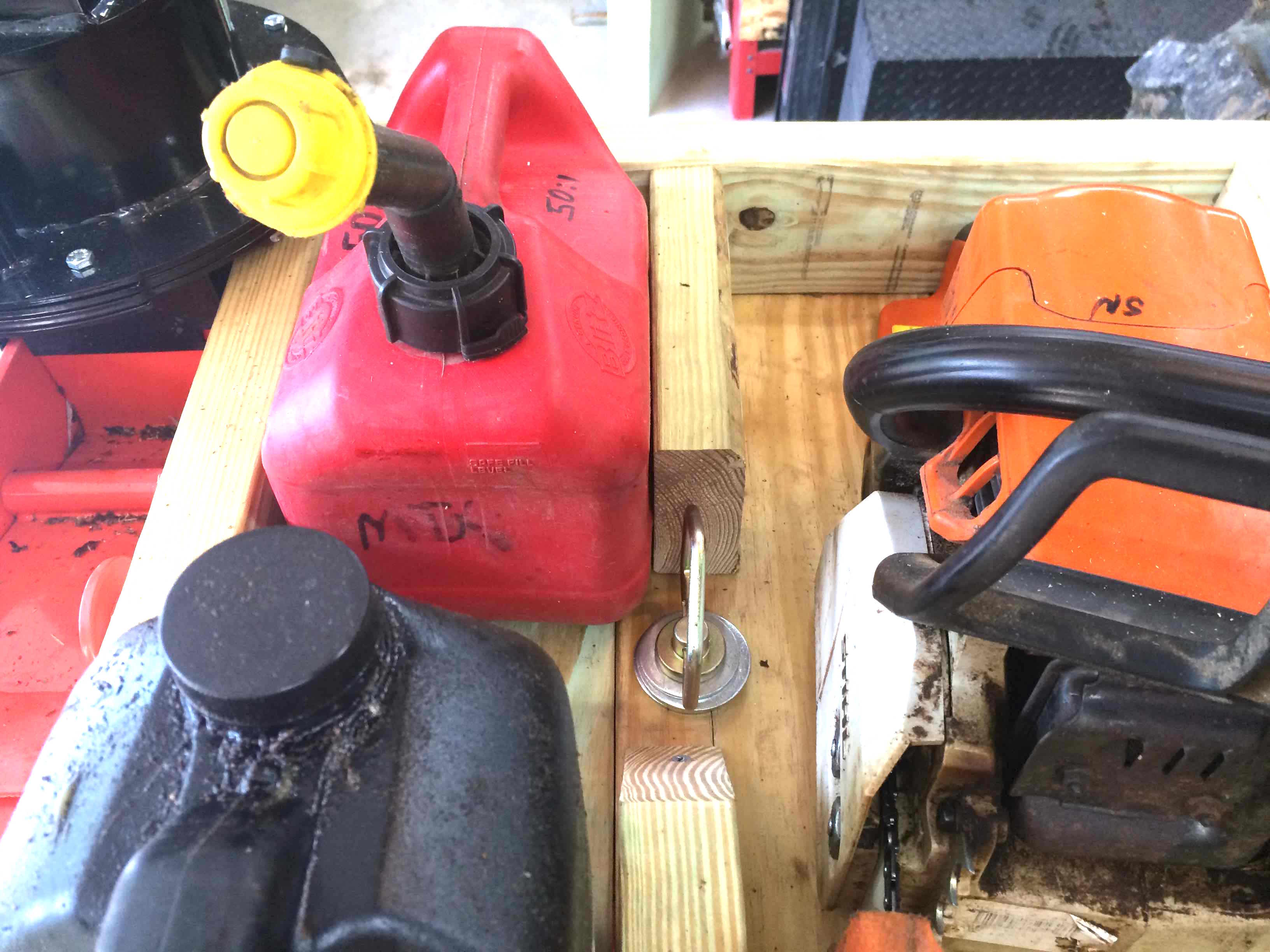

I would like to make up a nice tray out of ⅛" plate, power coat it and put a nice rubber mat in the bottom of it. Figure on the bottom I can still use the "L" bracket but instead of using a screw I can weld a treaded post on the bottom of the rack that will drop through the top of the L bracket (where the screw is currently) and then have a nice threaded knob to screw on and hold it in place. Thinking I will do that this winter when I have more free time and want a little project.

Sorry - as for the design, so far it is working really well. Holds either of my saw, a small 1 gallon mixed gas can, the bar/chain oil bottle, pair of gloves and I can toss the files in the little area where the saws sit and they don't seem to move (drove about ½ mile one way the other day and nothing really shifted around)
May add a hook for my helmet so I can hang it when taking a break (One of those Stihl ones with the face should, hard hat and ear muffs built in - works great for chipper use)
