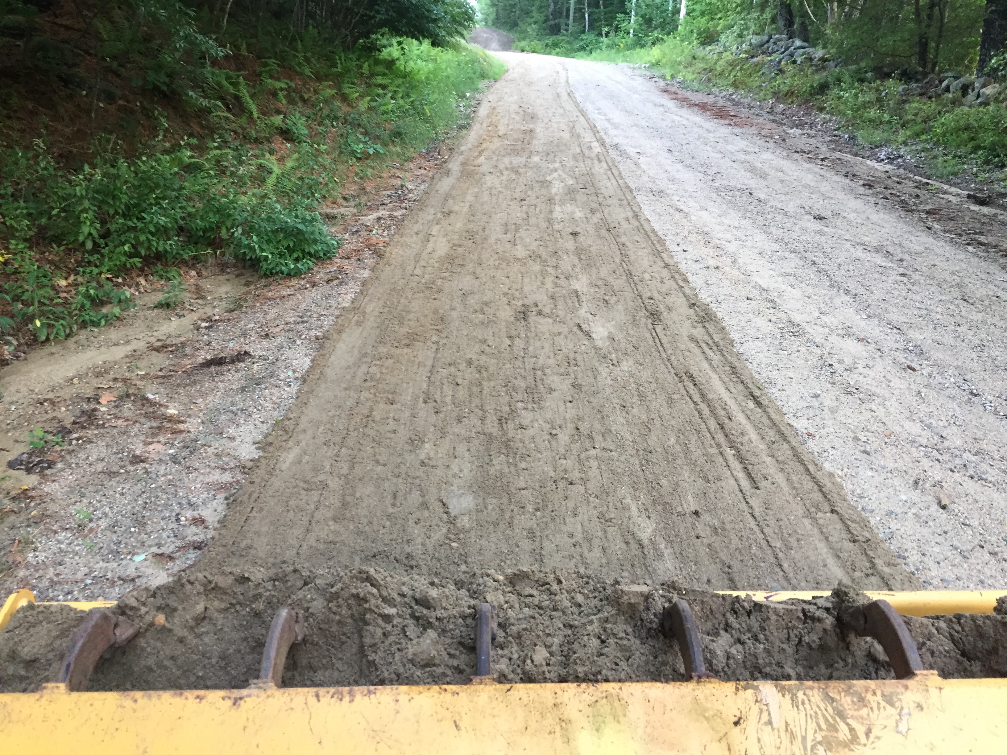

Here is one of my home built LP

You did a great job on that build BMan! I’ve always thought that this is the type of implement I would certainly build myself.
As you suggested, I will probably be fine with it and use it as is, but if for some reason I think it’s too big then I will use it as a model to build one off of. (Like I’ll ever get the time to do that)
I’ll certainly post pics when I get a chance to use it. I should be picking it up early next week.
