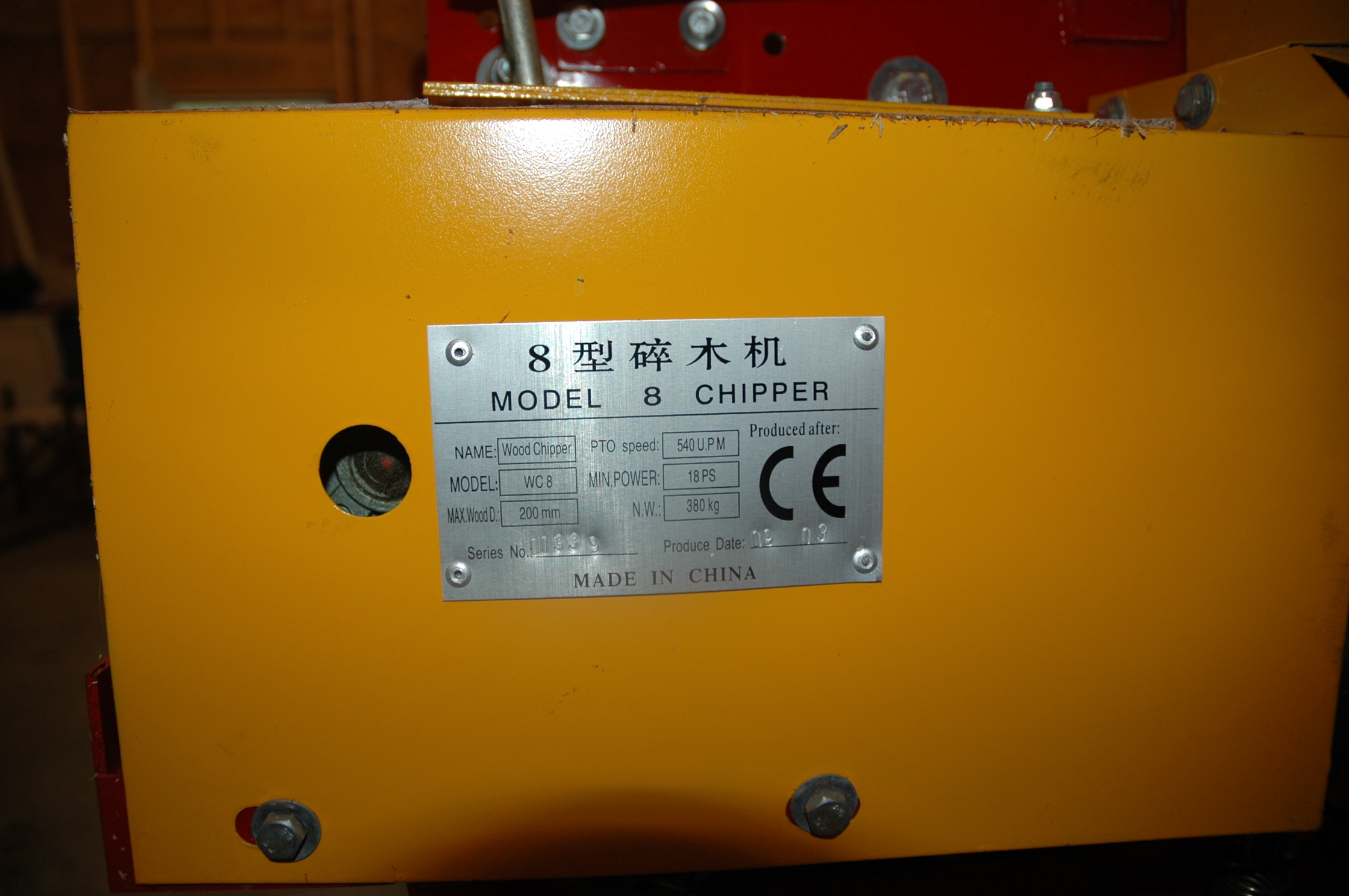

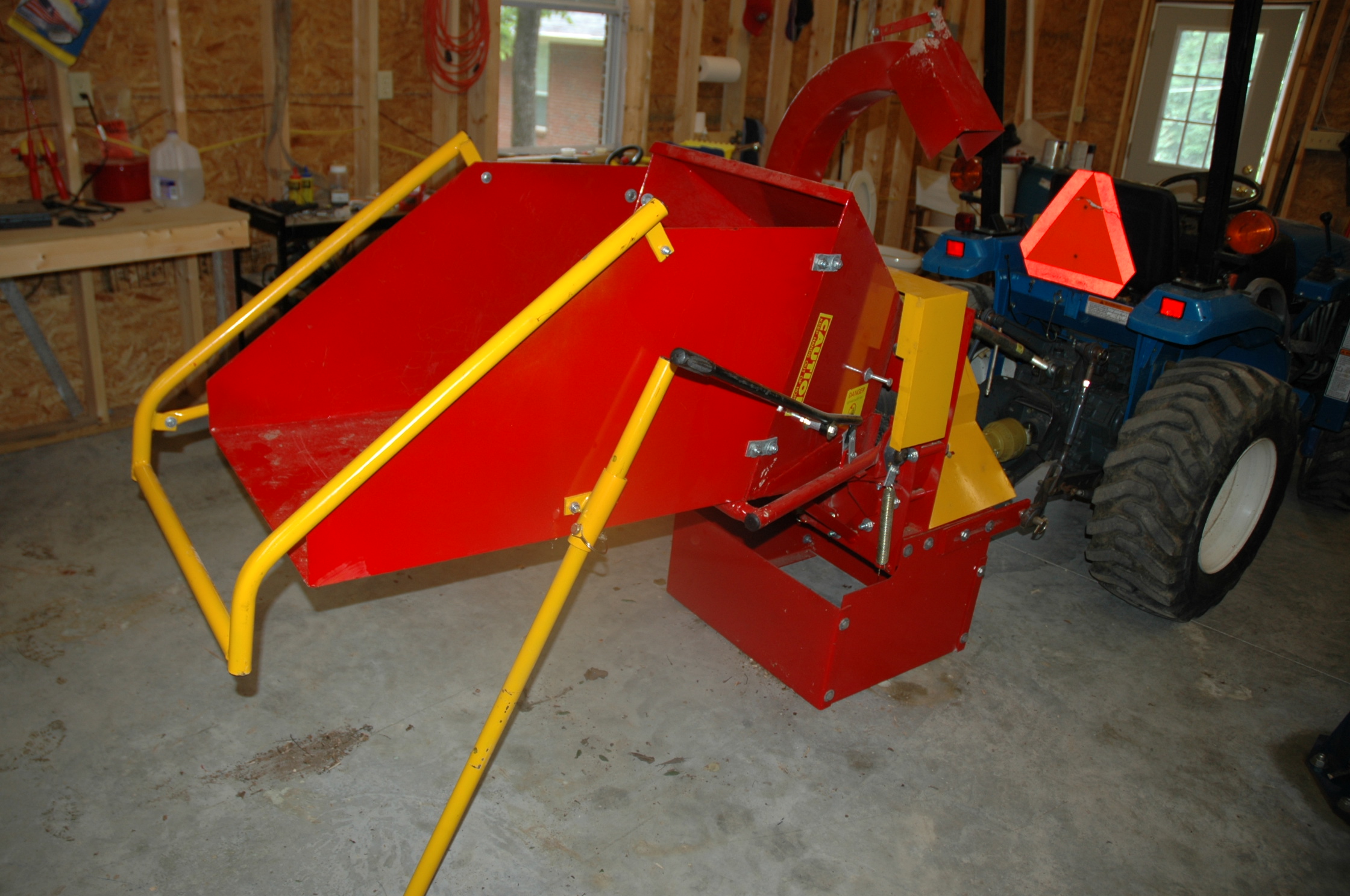

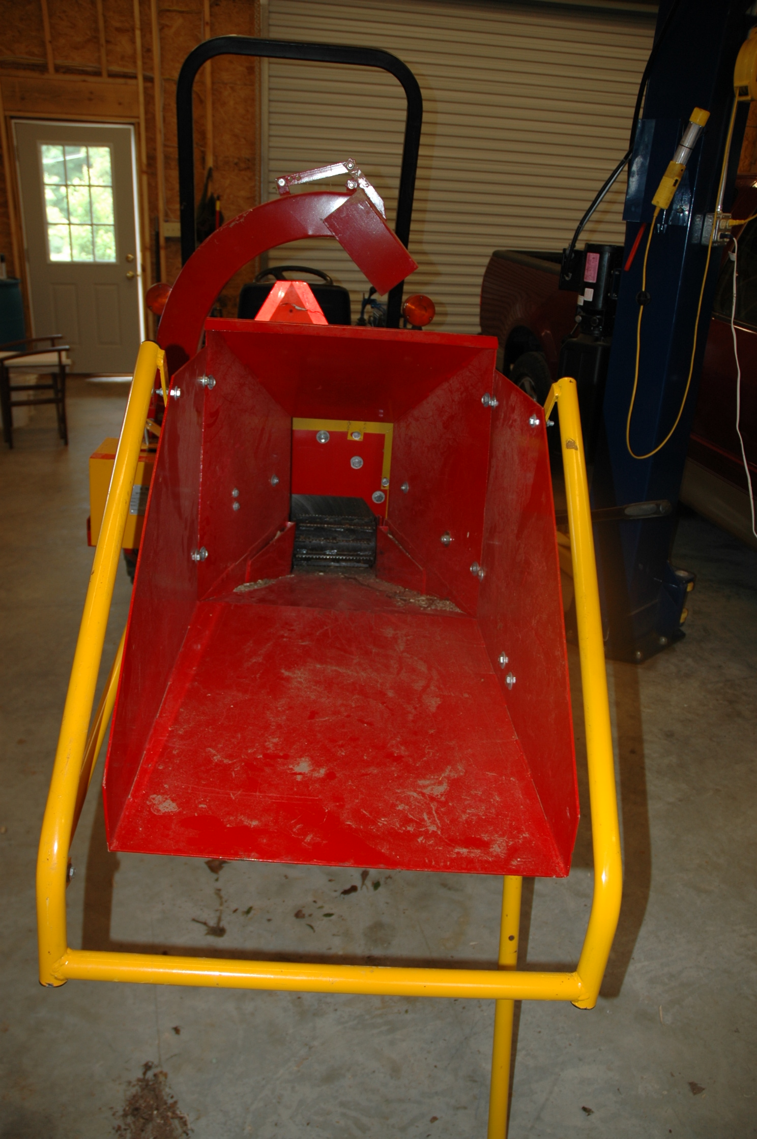

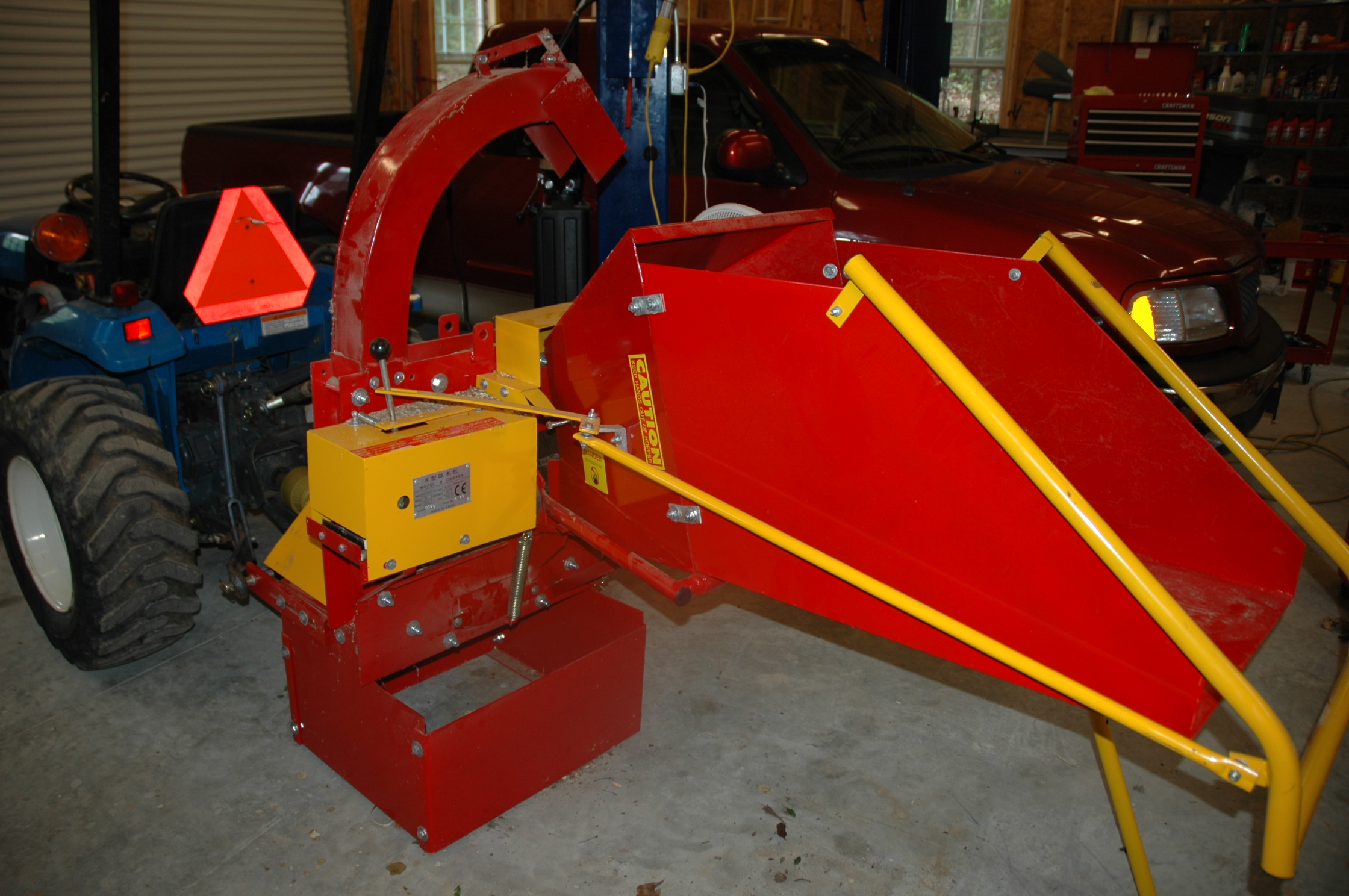

Mission complete. I took the loading chute off to make it easier to reach the allen head bolts. It also helps to remove the belt cover. When I did that I discovered two pillow bearings I had not previously found and greased.
I also removed the springs on the in feed and it lets it lock up and out of the way. You do not need to work on both sides of the wheel at the same time. You remove the lock nuts from the tractor side and then the allen head bolts unscrew from the rear.
I used my belt sander to sharpen the blades and did not turn them over at this time. It was very easy to do and produced a nice sharp edge.
I attached a picture of the model plate on my chipper. I added some pictures of the chipper itself. It is different than the 6' model with the safety stop bar around the chute.

Boy, the Chinese have really gotten carried away with the extended feed hopper!

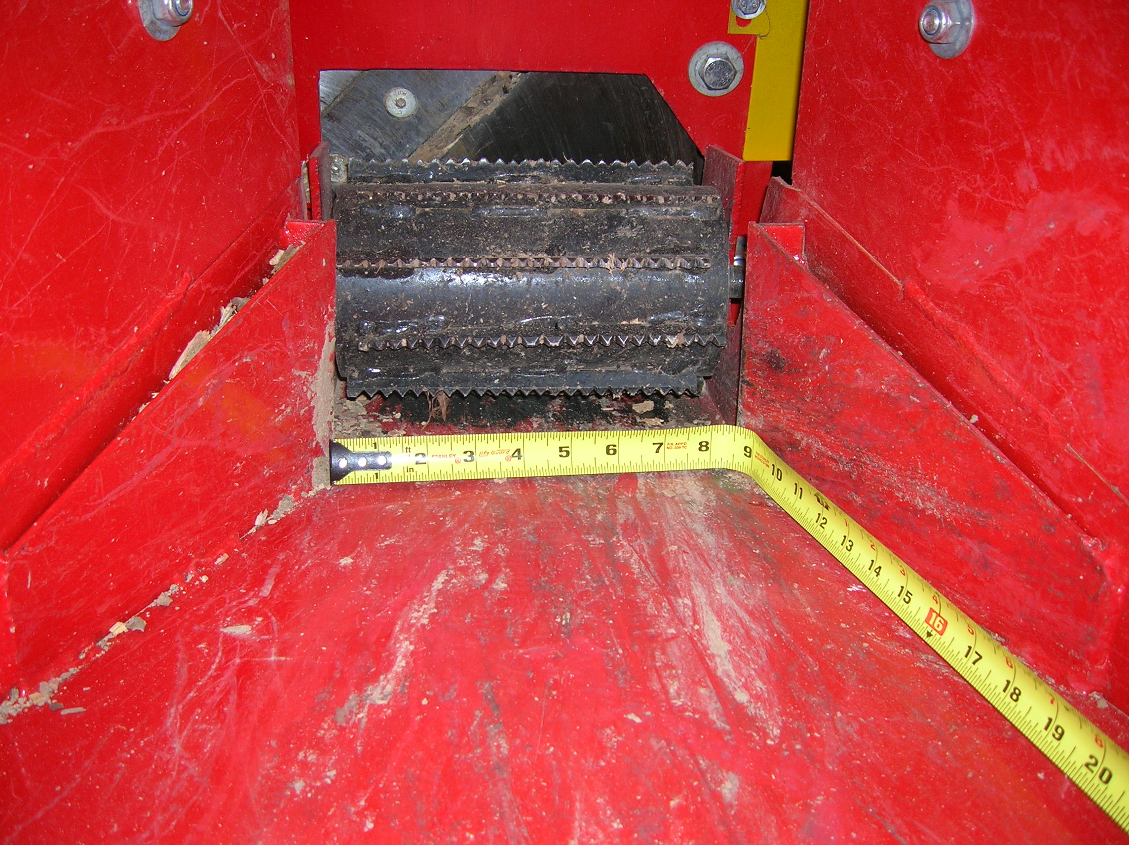

My dealer insists that my chipper is a 6" one that is mis-labeled with a 8" tag. I am still emailing back and forth with them. Here is a picture of the throat of mine. Sure looks like an 8" one to me.
   / 8" Jimna chipper #10
I bought a 6in from Circle G about 1.5 years ago. When lifting the feed roller it measured right at 8 inches.
