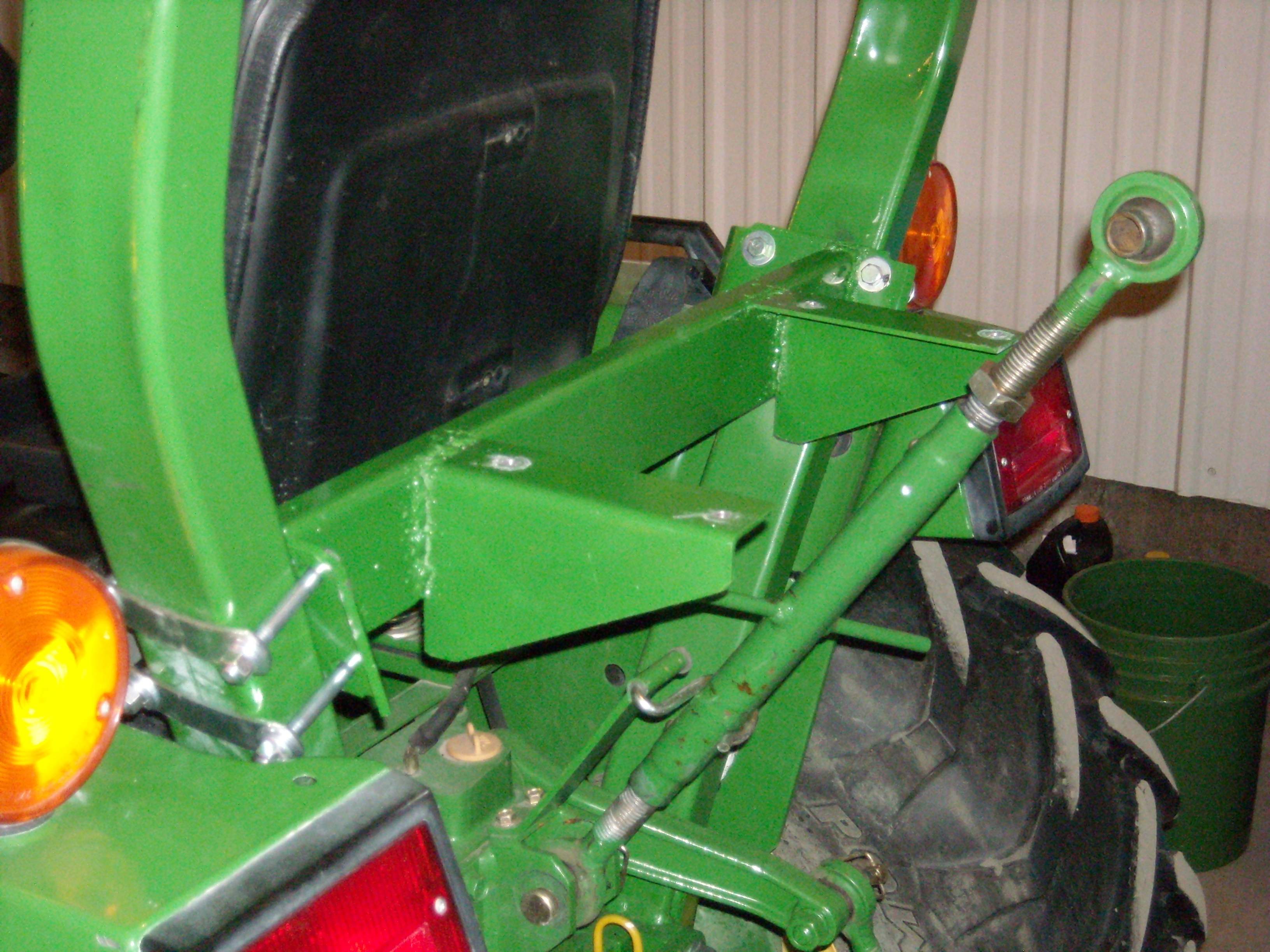

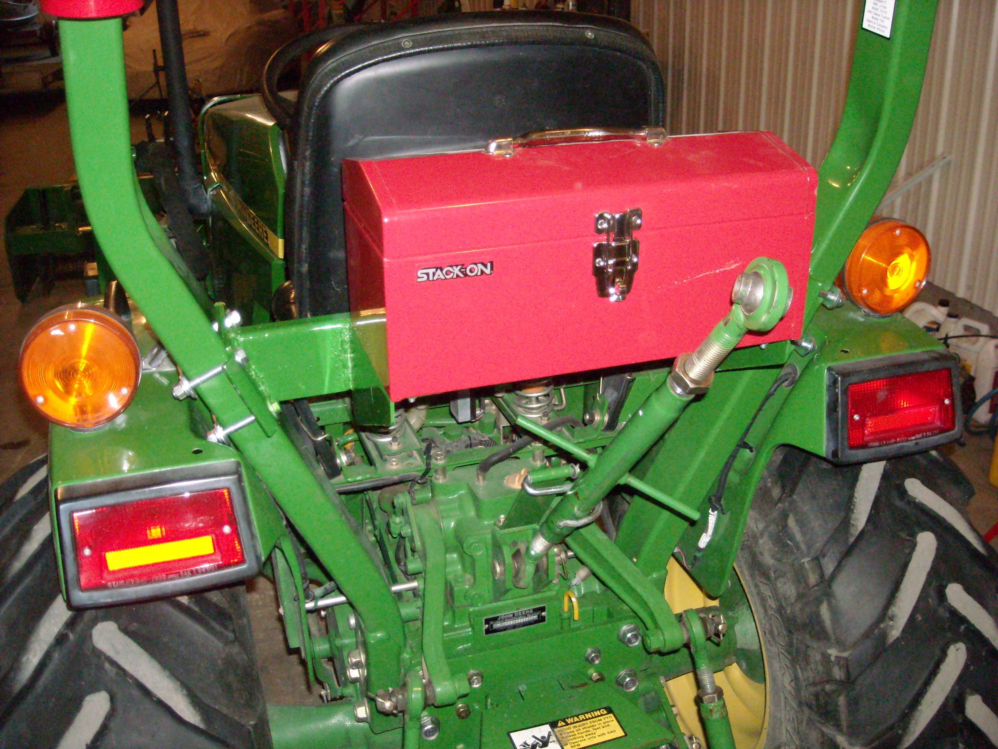

Finally......I got a tool box. :D I saw an earlier post where a TBN contributor posted about a similar location for a box but I cant find his name anymore. (thank you!) I made some small changes to make it a bit easier for my limited ability to fab...but this is much like his mount. The angle of the ROPS makes it a bit difficult to size the cross-mount between the uprights, so I used a 1x3 angle fabricated from some 3/16" steel for the crossbar, then stitch welded a 1" flat bar at the bottom to form a c channel (as I could not find any 1x3 tube available. I also had some angle brackets fabbed from 3/16' sheet. The whole deal cost me about $50 including the box....plus considerable time to figure out how not to interfere with the top link hook and to keep the seat from hitting the box (it just fits with a half inch or so to spare). I purchased some leaf spring mounts at TSC for the plate to weld the cross peice to and bought some U bolt straps for the other side (the "jury is out" if these are heavy duty enough). I'm pretty happy with the end result....other than my welding looks a bit crude (I need practice).

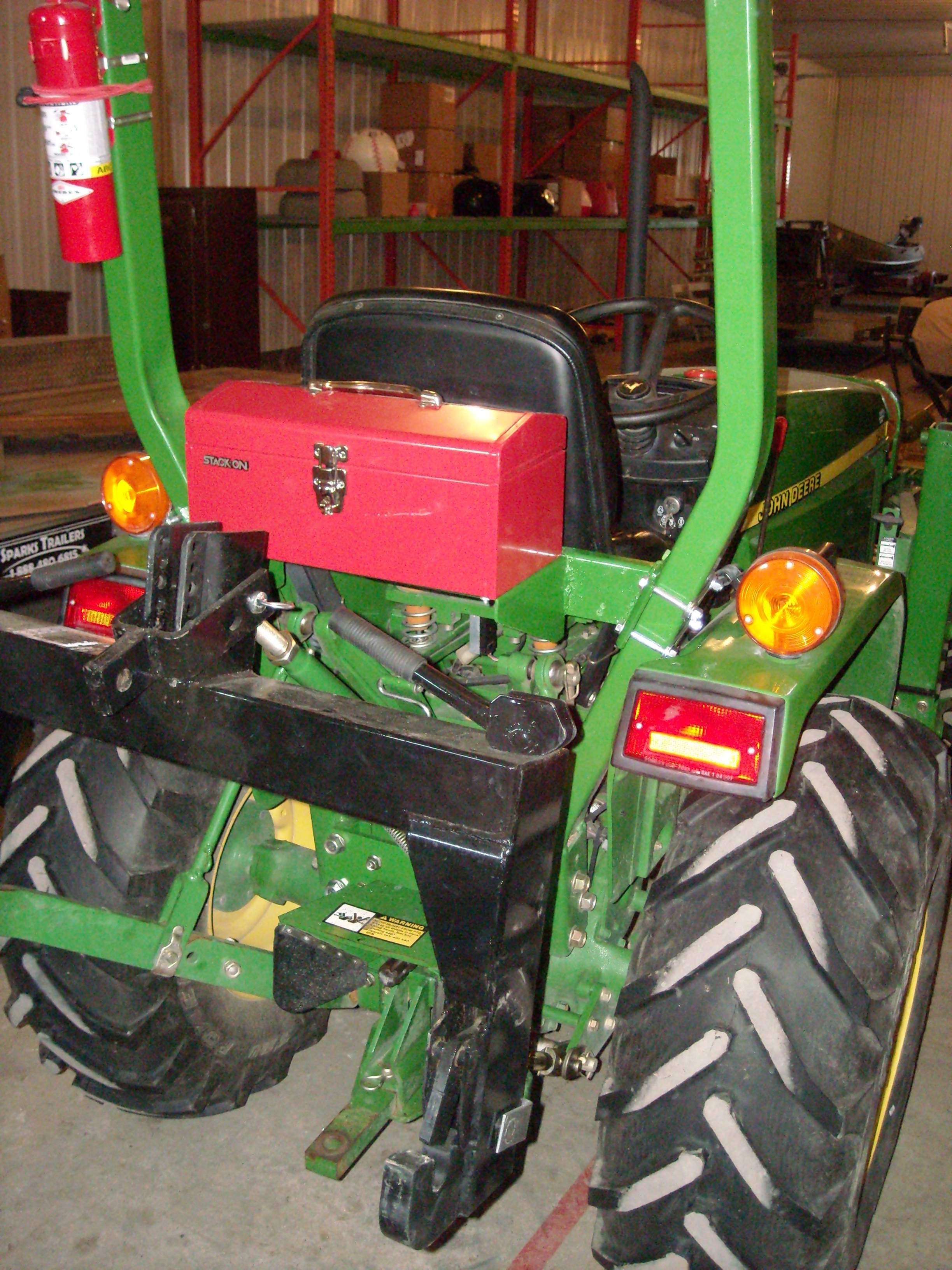

One more pic....cause I got one. The pic also shows my fire extinguisher.....something I like having available in the woods. I think just having one prevents me from ever having to use it. ;)

Very nice job Tom! Can you make me one?? :) One thing I would have done slightly differently would have been to trim off the bottom of the two angle brackets so they would be flush with the bottom of the main bar. That's just an appearance thing though.
Also, I think you have room on the main bar to weld a "boot" on either side of the tool box for the fire extinguisher so you could move it from the ROPS to the tool box bar. Just an idea I had.
Oh yeah, you gonna paint that red box green too?? I would!

Yep....was unsure how I was going to fab the cross piece (how deep I could make it)....so the angle brackets got a little deeper as a result. It all blends into the green....lol....but I may do as you suggest and trim 'em off.
On the fire extinguisher......I don't think I will do that as it will limit my visibility at the links for hooking up and such. The tool box isn't too bad....but I don't think I want anymore stuff to block the view. Thanks :)
OH....and AFTER you seen my welding you want ME to make one for YOU?...LOL I wish I could have bought one of these too. AND....I sorta like the red and green.....all decked out for Christmas 2009.

Thanks. The plates to which I welded the cross bracket are leaf spring "sandwich clamps" from TSC. (I cant think of the right term) Anyway, they are nice heavy-duty metal sections that are pre-drilled to match the ROPS. Then I used some U-bolt brackets for the other side and bolts to attach. These brackets are a bit light for this purpose....they bent a little when I torqued down the bolts....so I am not sure they will hold up. It probably would be better to make your own....cheaper too.
