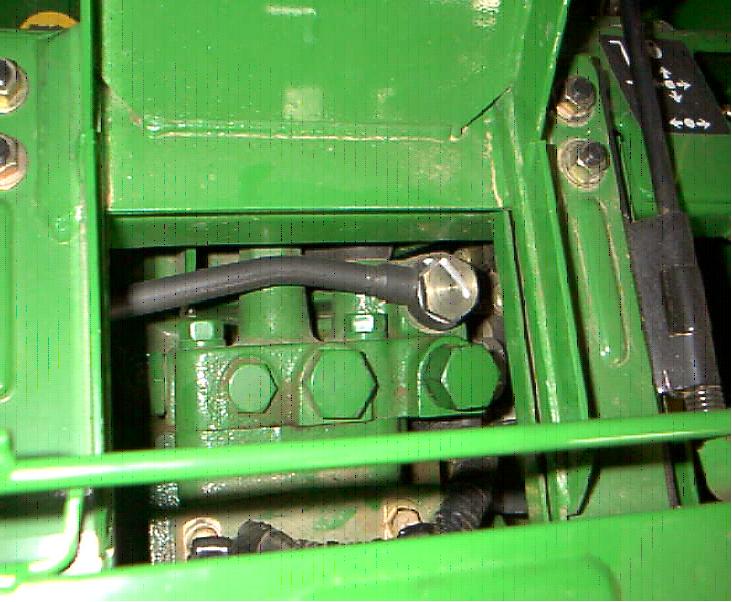

tpike35, or anyone who has done this...,
Can someone, or has someone, posted a picture which shows the pressure relief port where the shims go? I've ordered a service manual which hasn't come yet. I've got a hunch, but I want to be sure.
Thanks!
   / 790 - Raising Hydraulic Pressure #14
( tpike35, or anyone who has done this...,
Thanks!
Heres a picture. This is as if you're standing behind the tractor with the seat up.
The port is on the right. It's the larger one painted green, not the one with the hose leading to it. The shims go directly under the cap. Now, there is a spacer and an O-Ring that may fall out when you remove the fitting.
FYI, I installed one set of shims. There wasn't a dramatic improvement, but enough to keep me satisfied.
The next reply is another pic that might help you.

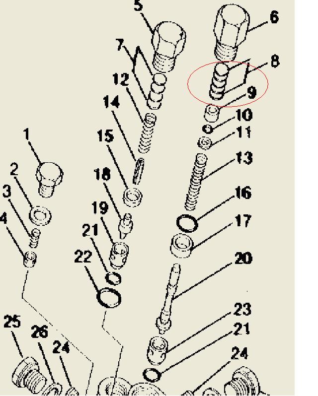

   / 790 - Raising Hydraulic Pressure #15
This is a pic of the shims installed (from the JD Parts website).
The shim are circled in red and identified as #8.
What you need to watch for it items 9, 10 and 11 falling out when you remove the cap. I lost that O-Ring (#10). It costs about $3 to replace.
BTW, my previous post only mentioned the O-Ring and a spacer...as you can see, there are actually 2 spacers.

   / 790 - Raising Hydraulic Pressure #18
Roy,
Thanks for the posts. I think I've got it now. That's the port that I was guessing it would be, but I wouldn't have known about all the "fly away" parts that might get lost.
