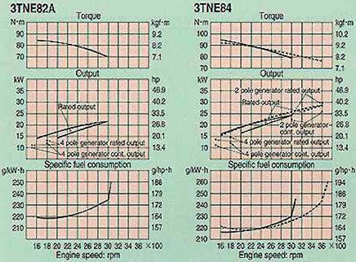

John Deere 790
New vs. Old
3TNE82 vs. 3TNE84

I looked over the graphs that you provided and have come to the conclusion that it would have been better to have had the old engine (3TNE84). It appears to have more torque, more horse power and operated at these higher power levels with about the same fuel consumption as the newer engine (3TNE82). Also since the newer engine is about 10% less displacement than the old, all other things considered you would expect it to have less power.
