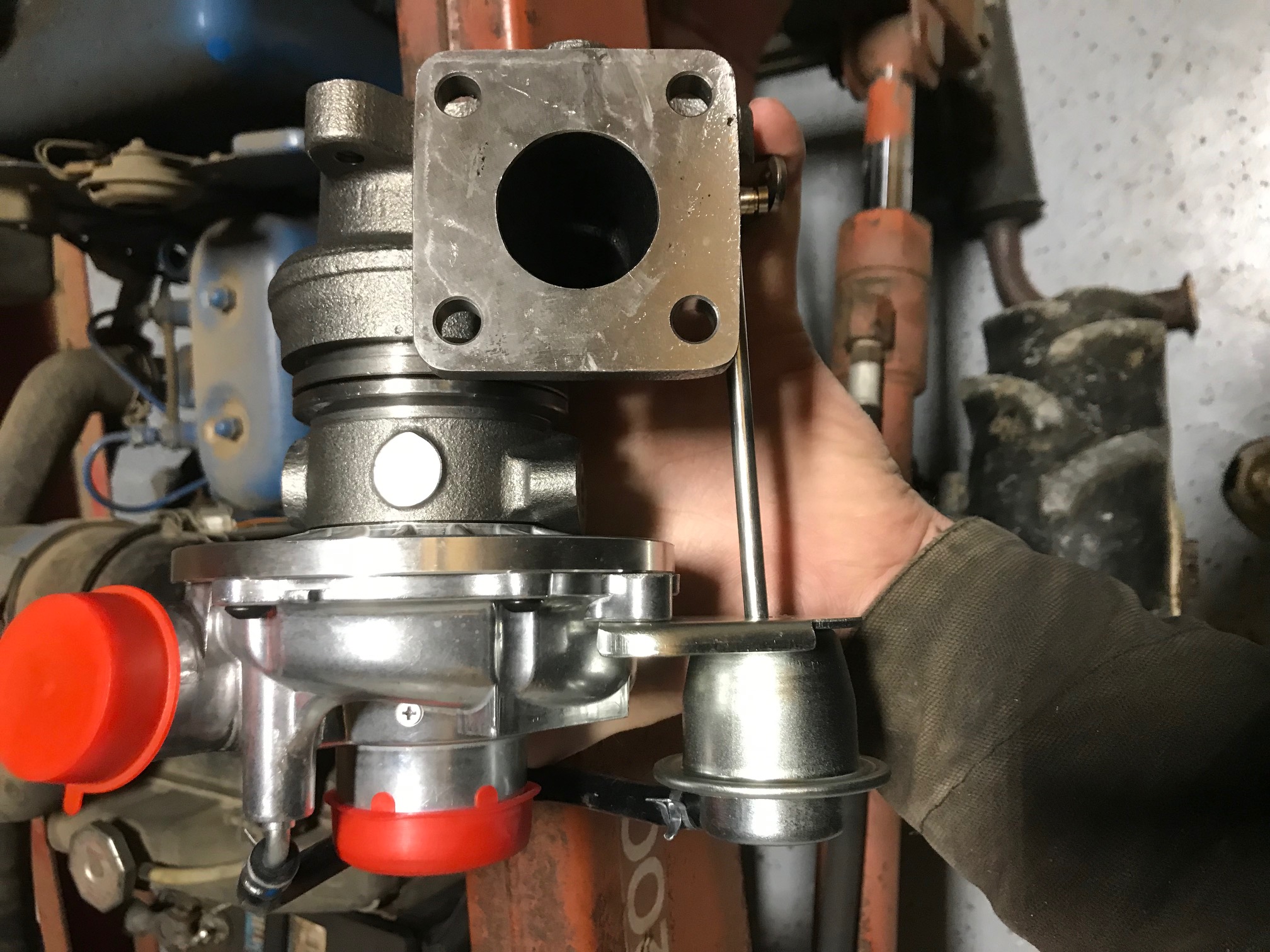

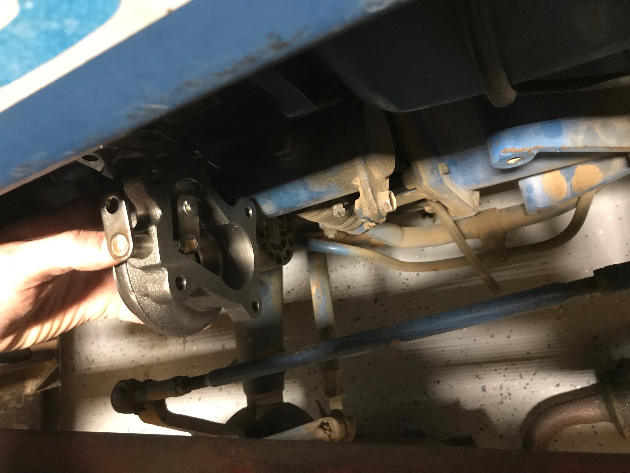

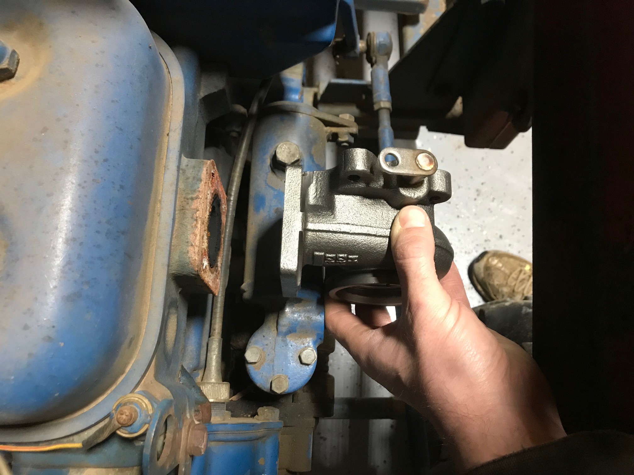

Turbo arrived, I promptly removed the exhaust and went to bolt on my new turbo... No go. We have clearance issues. See attached photos. I have a game plan for moving forward and will update as I gather more pieces to continue mockup. ENJOY
Here is the turbo. The exhaust flange is a perfect match to the head outlet BUT the 1300 hydraulic pump is in the way, see below.
Stock exhaust removed.
Hyd. pump/filter housing interference.
Spacing the turbine housing straight out away from the hyd. All photos following this are taken with turbo spaced out.
Intake filter will be reversed in the bracket to allow inlet to make a direct line to compressor. The stock rubber tubing will be cut up with other tubing to make the charge pipe and boost reference.
Looking down the side of the hood, turbine sticks out every so slightly but with far better clearance than stock muffler.
Flanges are being ordered to fab a custom outlet back into the factory muffler.

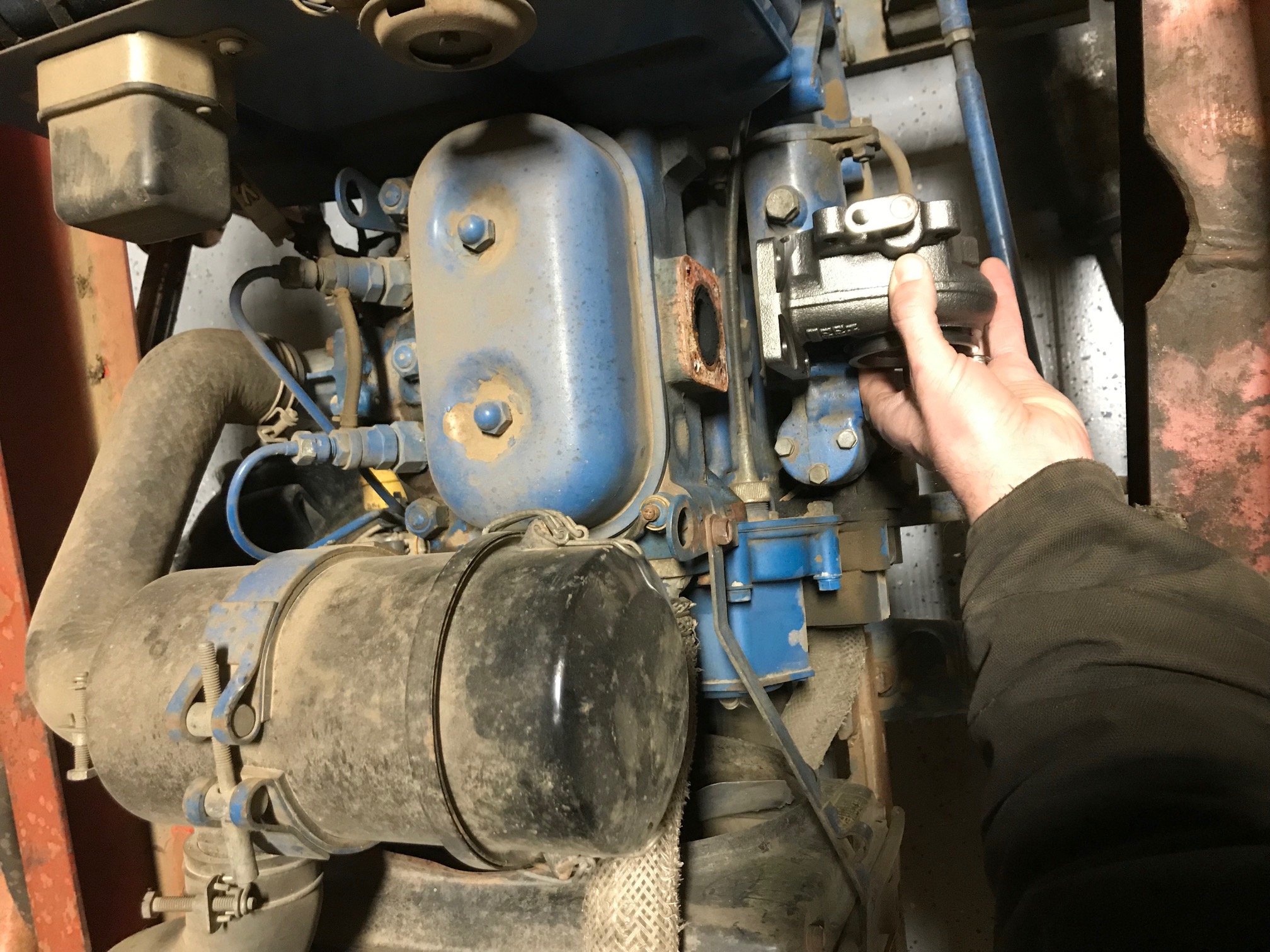

Showcattle,

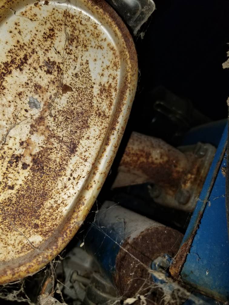

Do you still have your 1100? If so, would you mind snapping some photos of the hydraulic pump and exhaust outlet area of the engine? I am curious how much different it is to the 1300.

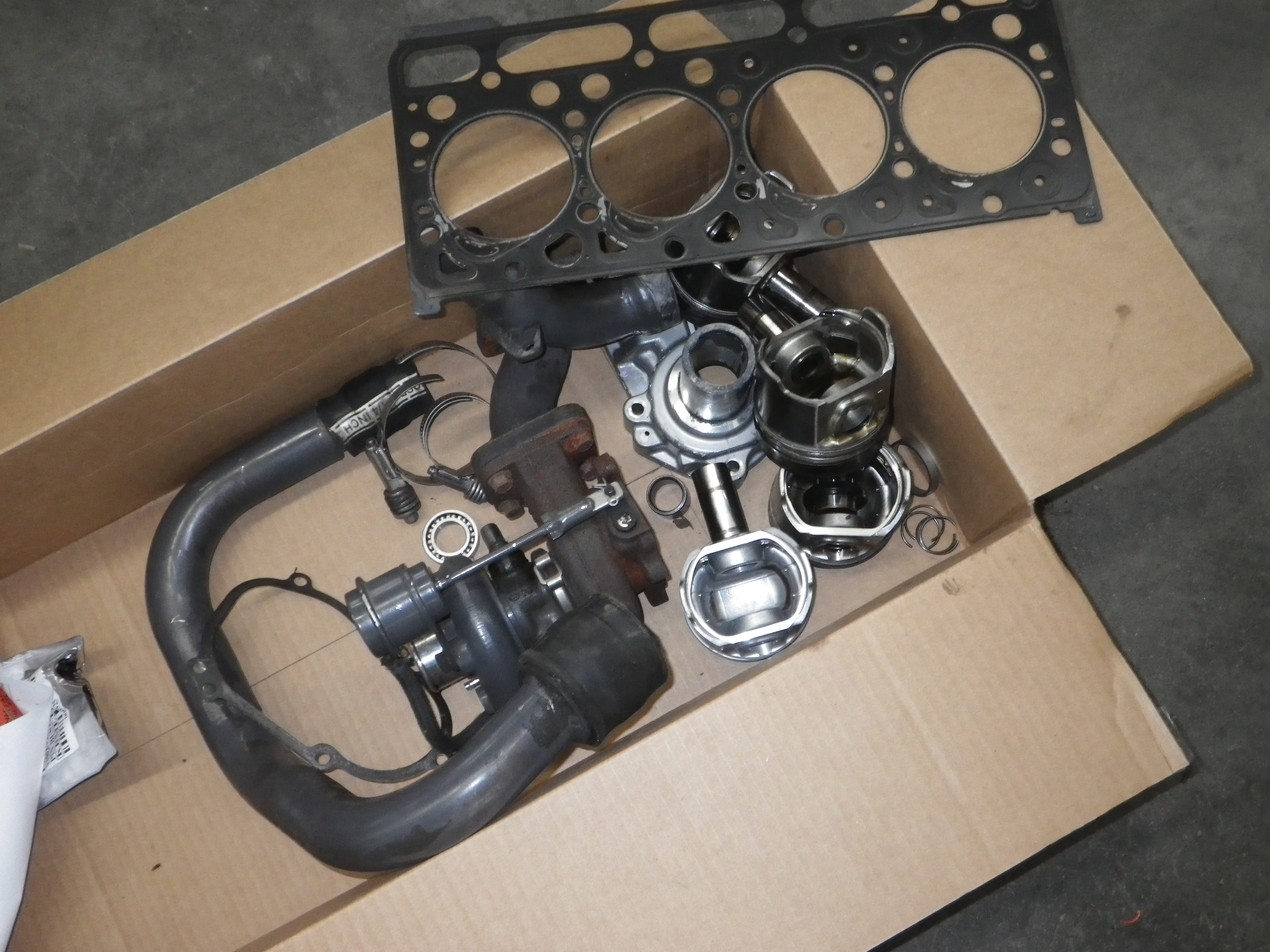

Here's a pile of parts I just removed/replaced on my L3940. I installed a turbo and cranked the fuel, went from 39 to 60 hp.
Engine went bad in 400 hours of hard working. Not saying yours will but most of my work is blowing snow at 3000 RPM full tilt, boost was 6.5 pounds no more. Timing was stock 17 BTDC and I checked it twice all 4 cylinders.
I noticed a little uneven running at idle and when I split the machine to replace a bad HST input shaft seal I figured I would check the engine for leakdown and found out 3 of the 4 pistons were damaged.
Turbo is off now just getting the machine back together and until I finish the thing I guess my wife can plow the driveway with a hand shovel after the foot os snow we got this week.
Also 3 of the 4 intake valves didn't seal correctly and the valves were perfect, the seats had moved around or something I am not sure why. I cut the seats and lapped the valves and they seal just fine now.
Regards, Fred
Good luck, be careful not to go crazy with the fuel setting.
Yes we still have it. I'll try to get pics later today

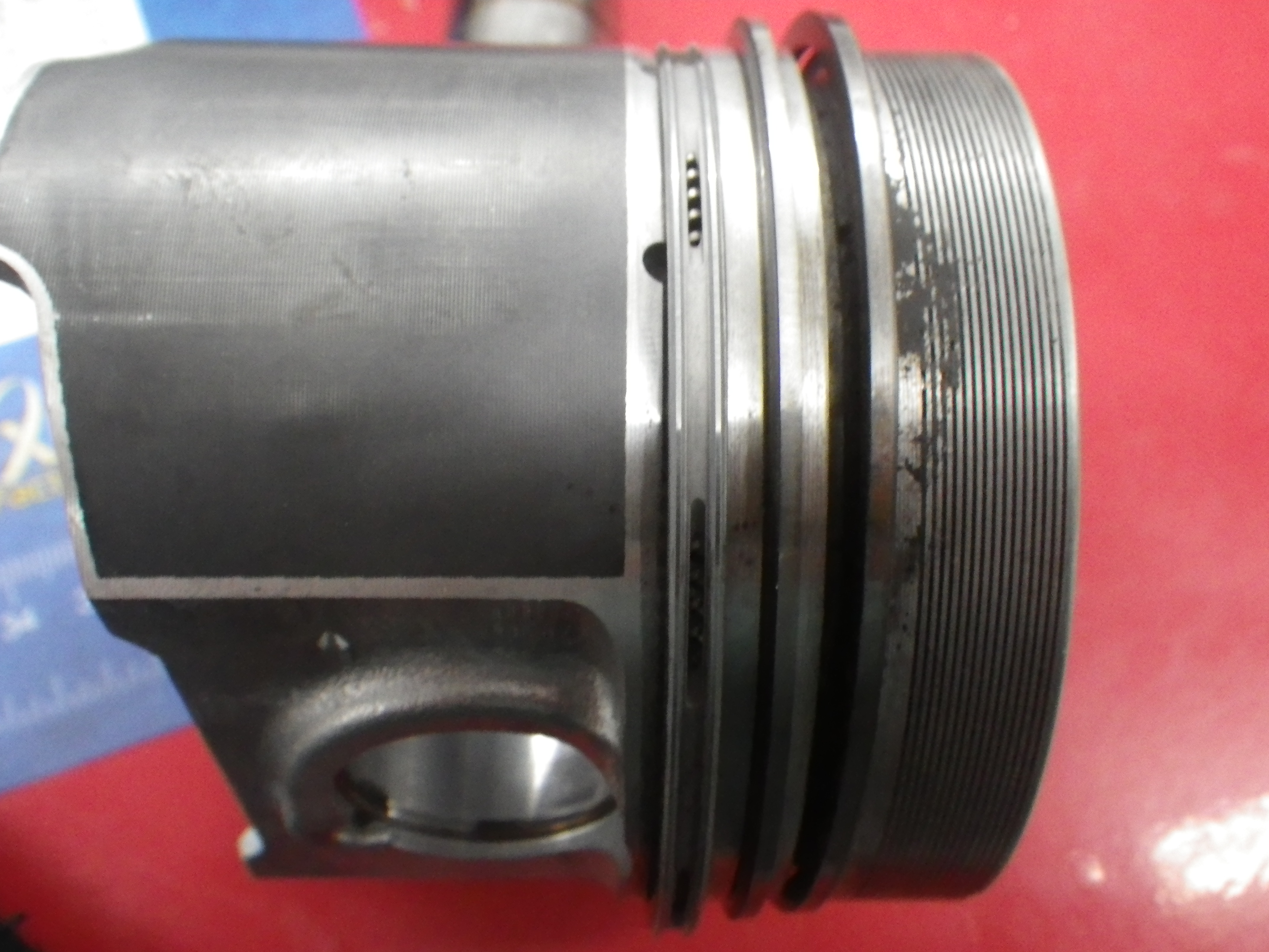

Any heat damage on the pistons?

I think too much fuel killed the cat. It only boosted 6.5 pounds. If a guy ran the machine normal and not full tilt it would be ok. In my case pistons with steel ring lands would be the answer for longevity.

Fred, It looks to me like without adding timing with increased fuel duration you may have been wetting the walls *Chasing the piston ATDC*. The oil scrapers look clean and clear (you definitely kept up on oil changes) so oil contamination likely did not cause the rings to stick. But as you know, once that top ring was no longer free to move, it was all down hill from there..
Edit: Also, the reason I agree with Fred it was not heat related is that I don't see scorching in the crown, no major sign of melting, and the skirts look to be in good condition, if it got hot usually the piston swells and there will be a lot of skirt wear.
Side note for those who don't know: Flat piston designs are not very forgiving to increased injector on-time or emissions in general. The newer DI technology, combustion chamber is in the piston not the head. Creates a better swirl effect and cleaner oil (less fuel wetting the walls) and lower emissions.

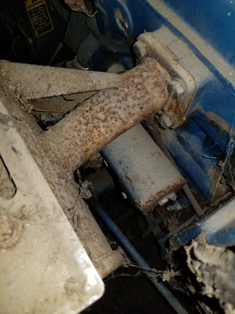

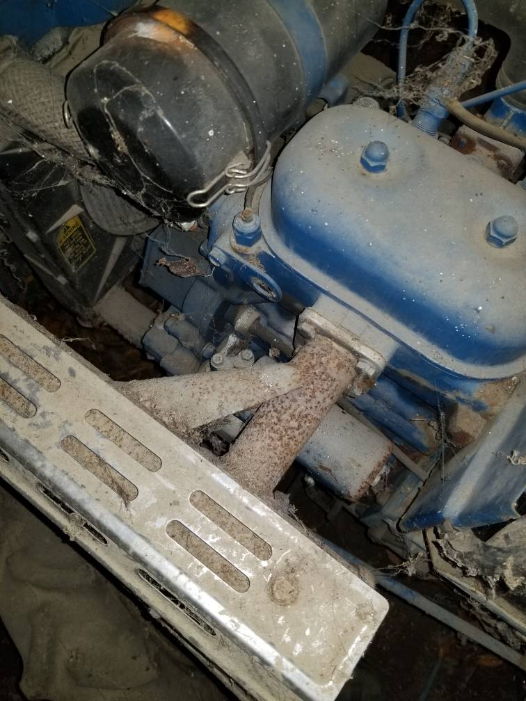

Sorry it took so long. Completely forgot until today. Looks very similar to your 1300.
Showcattle,

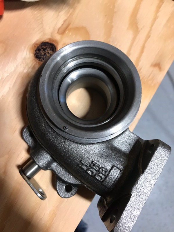

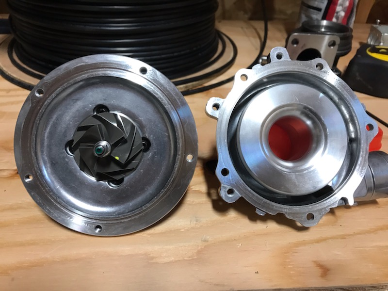

Sorry for the delay, I have a few other projects in the works right now. Main one next is finishing the lighting in my shop tomorrow. In the meantime, here are some measurements and turbo pics I promised early on.
This is the turbine inducer and exducer.
Exhaust inlet size.
Wastegate port and wastegate flapper.
Turbine Housing.
Compressor housing. I am not excited about the lack of seal between the back plate and the cover. Will likely do something here when reassembled.
Compressor inducer and exducer.
Does anyone have questions, want pics or measurements of another part of this turbo? Speak now before I put it all back together.
Thank you for doing that! Looks very similar in the engine but yours has the horizontal muffler.
Side note, has anyone here done an exhaust to route down towards the ground like more modern 99-00 tractors on these older shibauras?

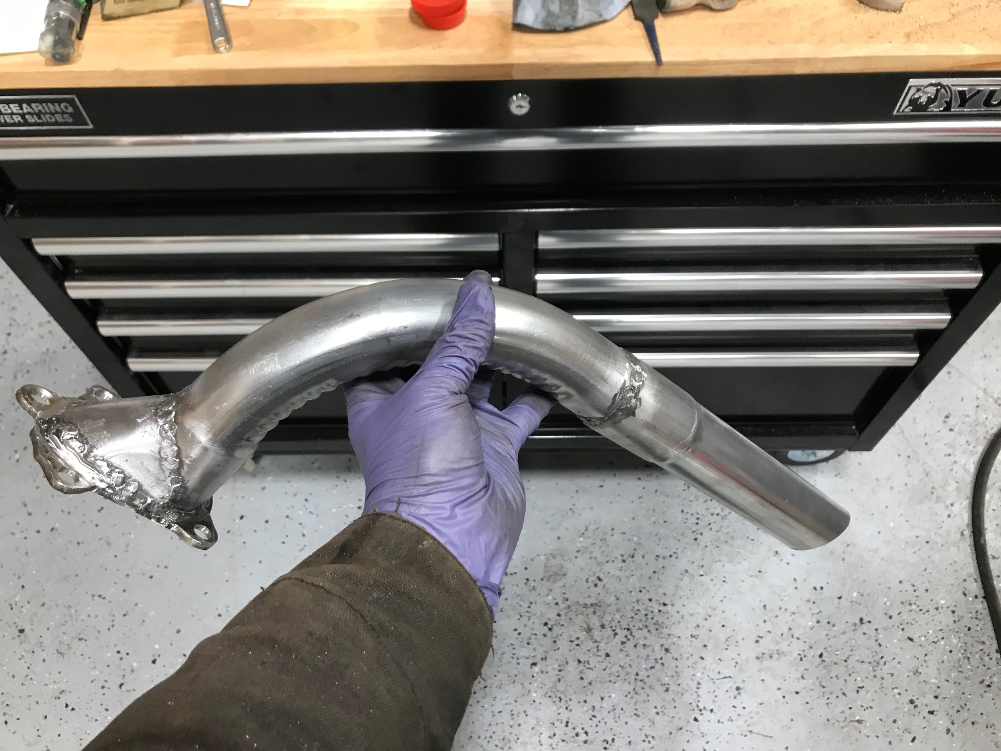

I can finally say with a 99.99% probability, that I have the only Ford 1300 that is turbocharged!!

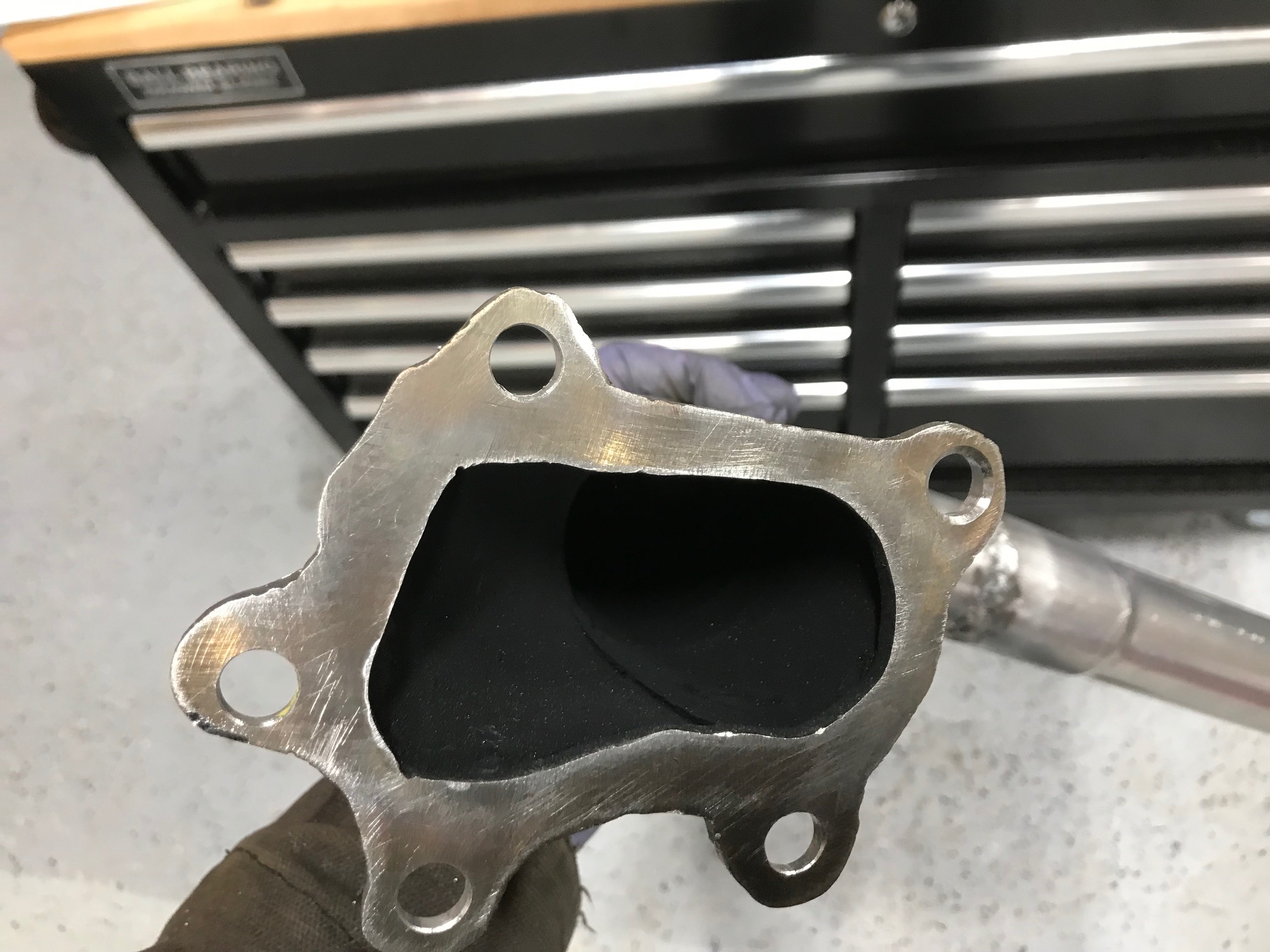

Here we can see the adapter I made, this extends as well as rotates the turbo upward. I did this to get away from the hyd pump and filter housing, then realized I needed to fit inside the loader frame channel. So the adapter was made (tacked) and the turbo was in place.
Enter, the downpipe. This again was 100% made from plate and exhaust pipe. The flange kit I ordered does not fit this turbo despite online seller claiming it fits. :confused2:
