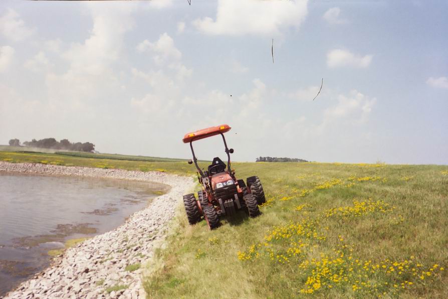

We pull a 72" 1672 rear discharge landpride finishing mower with a B7610. Works good. I mow as fast as it will go in low range full throttle most of the time. It has power to go faster If I want but most of the ground it too rough any way. The only time I run out of power is on a very steep grade or if the grass gets taller than the front tires. I think the 60" mower recommendation is more of a weight issue than power. But with some common sense it works. A 72" mower has some weight to it and if you make sudden turns at high speed it can throw the tractor around. I operate on some steep slopes and the weight of the mower wants to drag the rear of the tractor down hill and can result in side ways slippage of the rear tires. Running the tires wide in back and rear weight helps alot in that situation. We also pull a 5' brush cutter and have no problems. If you have relatively flat lawn and keep it mowed regularly you should not have a issue with a 72" mower. If you need to mow up and down some pretty steep stuff alot of the time stay 60". I installed dual rear wheels for safety and mow across the slopes which works out well. Mowing up and down pond dikes is not a practical option.

"I installed dual rear wheels for safety and mow across the slopes which works out well. Mowing up and down pond dikes is not a practical option. "
You installed dual rear tires on a B7610? I'd be really interested in seeing a picture of that.

This is a photo of the 7610 with the duals on. Have the little sprayer on it in the photo, sorry it's not a better photo it wasn't intended to be a tractor photo originaly. Tires are R4's. Rims are standard 8 hole ag rims band spacers custom rolled, held together with 4 "J" bolts that hook into eye nuts I have installed on the inner rim. They go on in about 2-2.5 min and off in less than 1 using a impact wrench. I install and remove them all the time. The tractor is far more stable on the slopes.

Another photo. If your really intrested I will get better photos. It's much steeper than it looks in the photo.

That is very impressive!
Thank you for the pics and description.
/ 7610 attachments #13
I'd never seen a tractor that size with duals myself, but it sure looks good.
