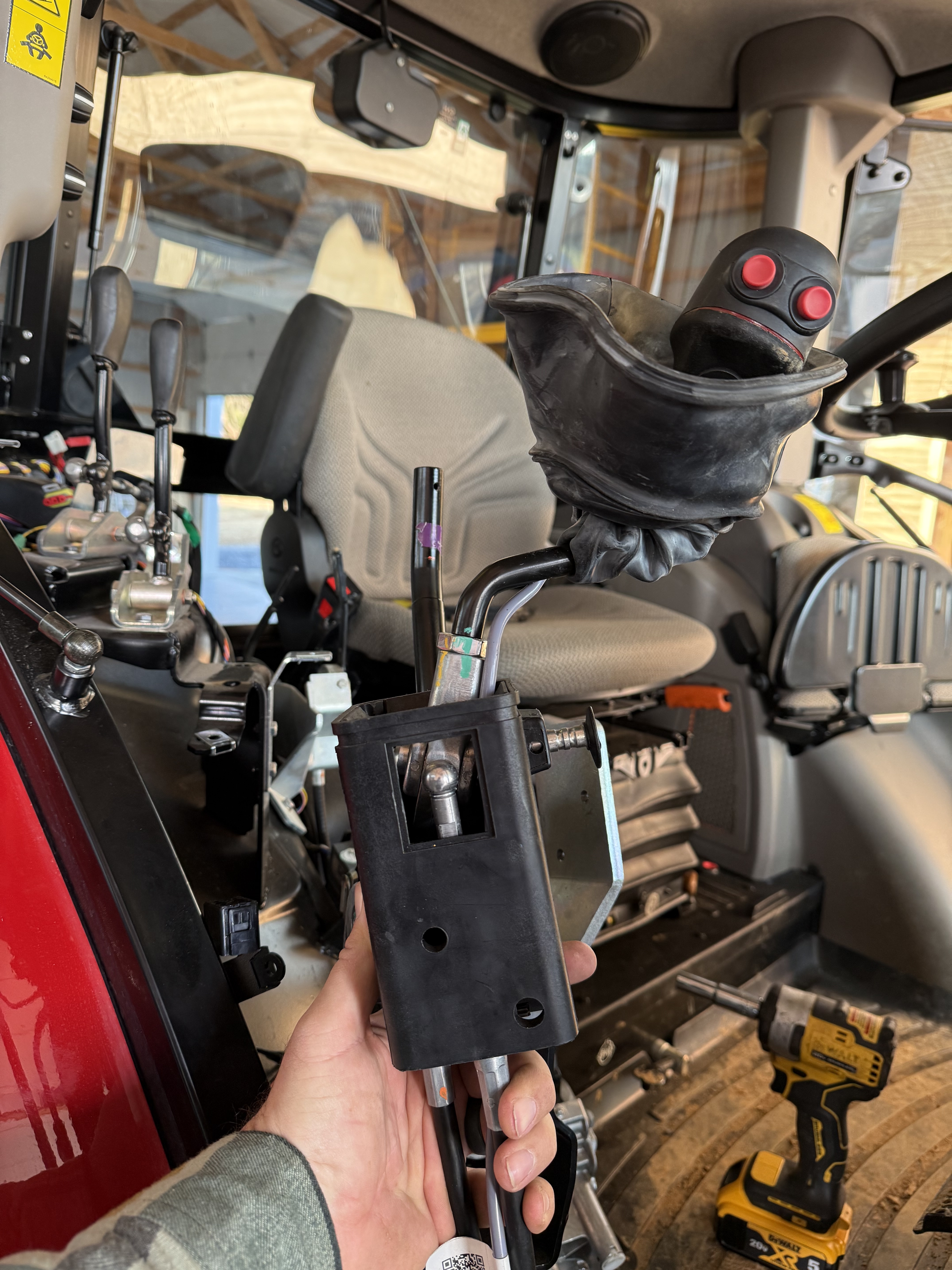

Need some help with my 2022 75C with 250hrs. Yesterday when moving the tractor something “clicked” in the loader joystick and now the curl up function won’t work. The curl down runs fine, but it’s like the curl up won’t move. You can see the joystick is even leaning towards the left as if it’s just sloppily flopped over to curl up. The little knobs on the joystick valve aren’t broken, I can’t find anything physically wrong looking with the assembly.
Broken cable?
I store my loader with the bucket curled all the way curled in, could it be the bucket is too far curled in and now the system can’t pull it back?
   / 75C loader issue #2
Can you see the loader valve. If yes can you observe the spool movement while operating the joy stick. Possible cable connection came lose or broke for movement in one direction.
Same on joy stick end. Does everything seem tight and operate similar to raise lower?
   / 75C loader issue #3
Most of those are cable operated, the 4 motions of the joystick use two push pull cables to actuate two valves. One for raise/lower and one for dump/curl.
Removing the boot on your joystick should allow you to see the cables and if they are function in the dump and curl. Then with a second set of eyes watch the physical valve it's self for movement on the spool centered when not operated, then pulled for one mode and pushed for the other.
