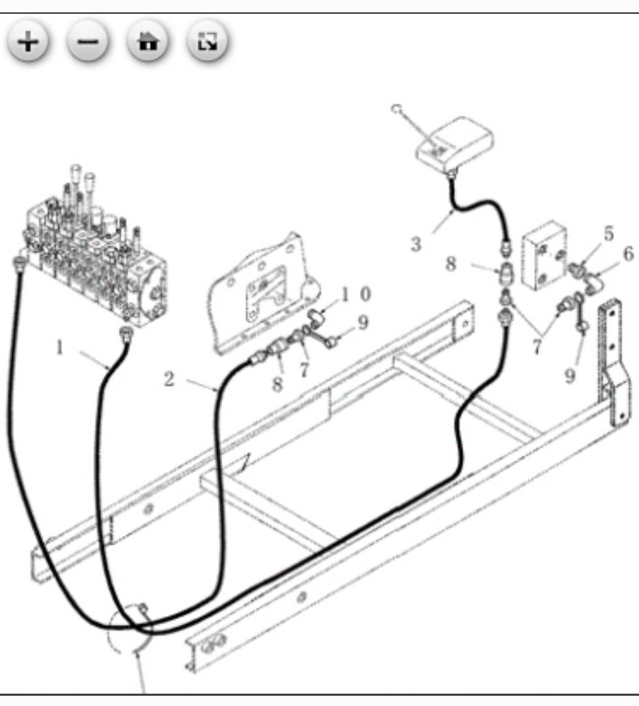

i was wondering if someone could tell me the difference. My 1520 Ford spec says 757B , but i have a chance to get a 757C. thanks for any info you could give me. it comes with the sub frame , although its off a 2120. i should beable to mod it to work .I dont have rear remotes, so ill be searching on here for a way to get the hyd hooked up too. i thought of buying a pump and hyd tank, if i can find one, and make it self contained, any thoughts on that would be welcome also
   / 757c vs 757b #2
Other than the B being made by Ameriquip (Arps) and the C being made by Schwartz (SML), you have similar backhoes.
If you can modify the frame to fit, then you can get the hydraulics hooked up easily. Take a look at the photo.
   / 757c vs 757b
Thank you for the info, and drawing, my hoe should be here this week, and i can finally got going on the install
