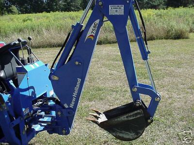

DieselMonk said:
I wish there were locks for the stabilizers there too..
I noticed the 758 has locks for the stabalizers, just like the lock for the arm. Has anyone tried adding the locks to the stabalizers?
See attached picture of a 758 BH.
I was thinking I could buy the locking plate and have someone weld on the stubs...
   / 757c BH ???? #8
On another post about the dropping boom, someone said they use a ratchet strap between the two.
