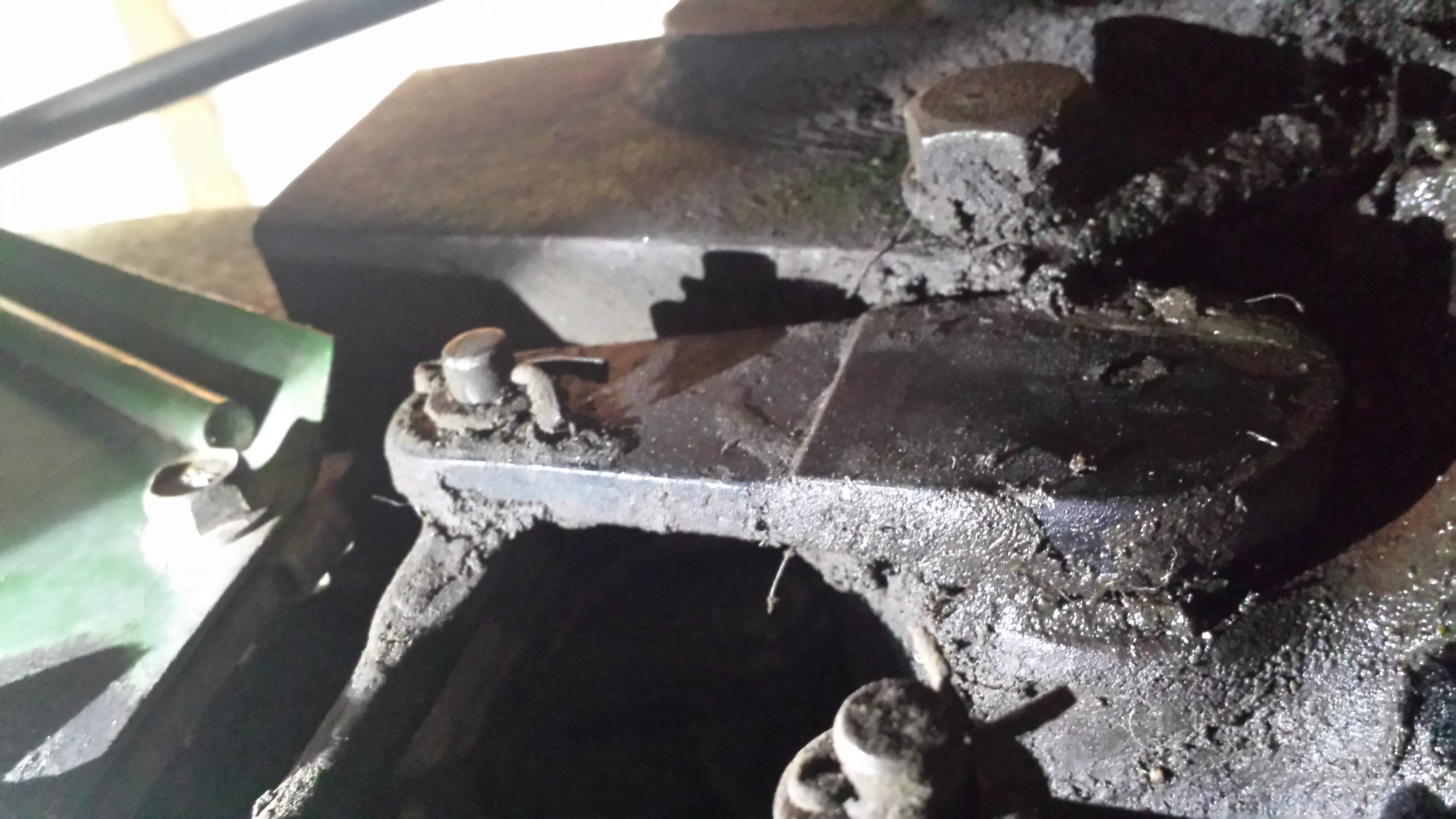

Recently picked up a 755 compact utility. It has a few small issues, I want to take care of.
First it is leaking hydraulic fluid from the shaft that the outside brake pedal linkage attaches to that enters the rear end housing. Is there a replaceable seal or ring that resides on the shaft that could be causing the leak? Ive looked at the schematics, and have found one view that showed an o-ring, and another that just shows a washer on the back side of the shaft.
My other issue is the hour meter/tach no longer works. Is there any place specific to trouble shoot it, or is it something that just needs replaced? Wasnt sure if there was a blown fuse or electrical short somewhere that could be the culprit for it not operating. All the fuses on the panel by the air cleaner are good.
Ive ordered manuals for it, just haven't shown up yet. Any help is appreciated.

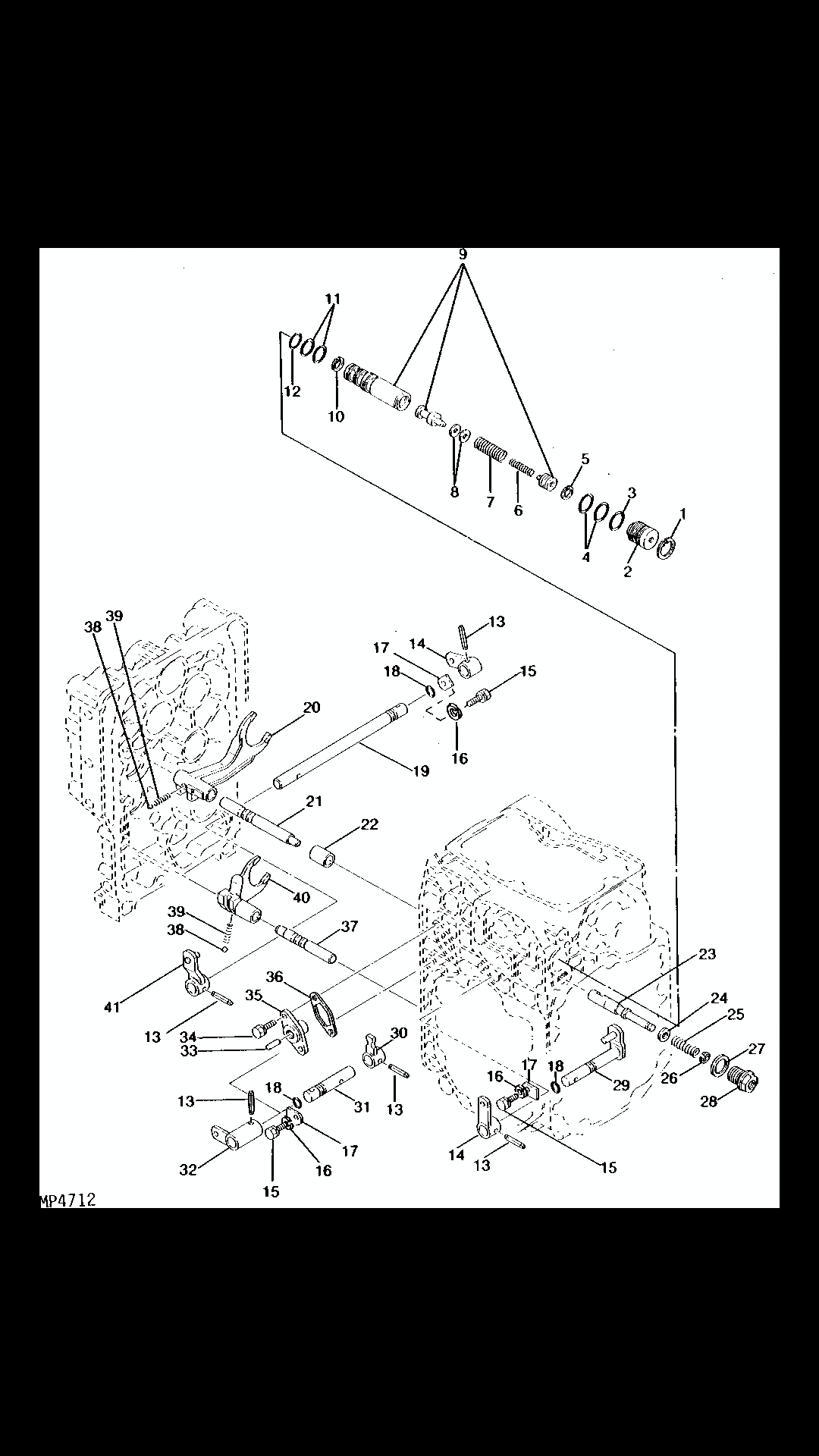

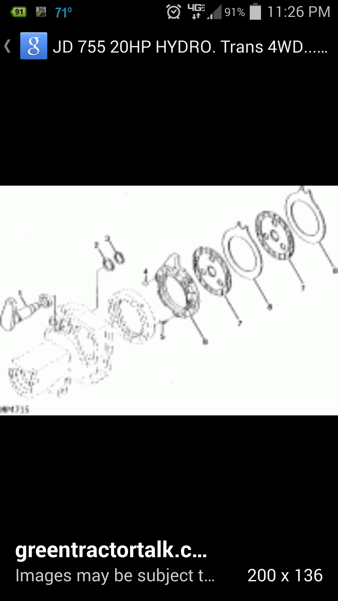

I figured out which seal is leaking on the shaft for the brake linkage after finding more scematics online. 3 trips to the dealer, 2 wrong parts ordered later.

Yea, thats where I found the correct part # for the seal. I registered on jdparts and started combing the schematics. The seal is listed in the transaxle housing schematics, it is also shown in the brake linkage schematic, but there was no part number with it. Found the part number in the transaxle schematic.
