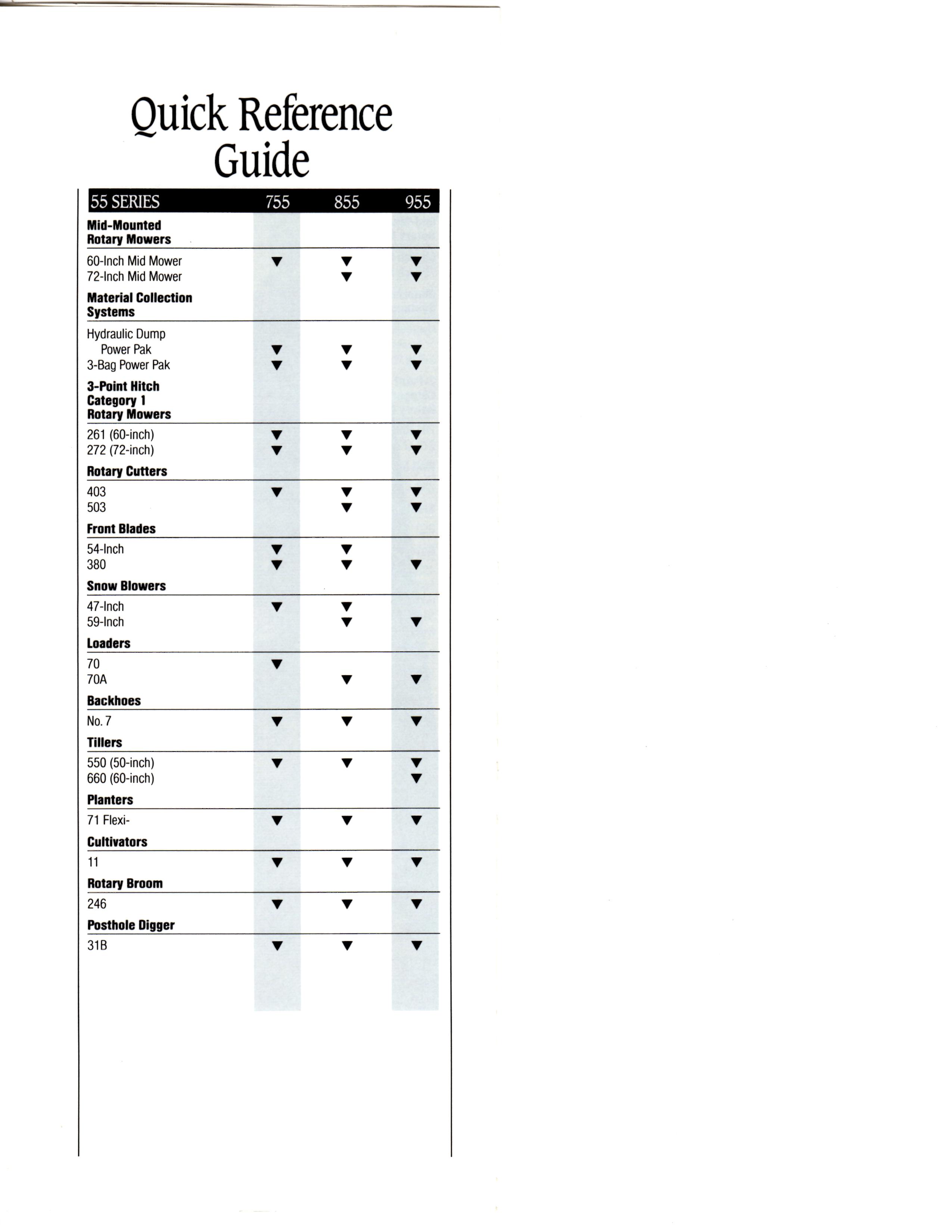

I have been offered the loan of a John Deere 261 grooming mower. This looks awfully big to me, will it mount on my 755's 3 point hitch, which I believe is a category one hitch. ???
The 261 was a JD factory recommended option for the 755.
