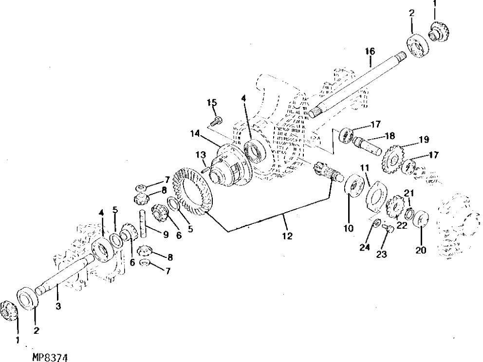

I wouldn't mind getting into one of the finals, or even a axle drive shaft replacement, but I don't want to get into the differential, and would rather leave that to the professionals.
I keep hearing from other owners, that most of the problems are usually in the finals. If an axle shaft on one side sheared, or a final failed near the hub, wouldn't the other wheel still pull until it hit something slick? I guess both finals could fail at the same time, or it is something that would affect both sides, like the Ring Gear, or Input Shaft.

No. The front differential is an "open" differential. The way it is designed, it will direct power to the wheel with the least resistance.

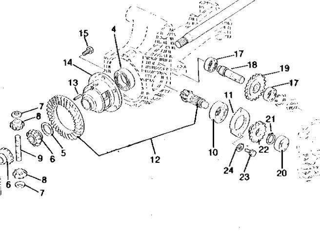

Removed the left part of the axle at the differential box, and you were right, all six of the bolts holding the Ring Gear were at the bottom of the case. Three had backed out, and the other three were sheared. In a way, it is fortunate that the bottom of the housing is rounded, a perfect place to hold the junk bolts.
There is no damage whatsoever, just need to replace the bolts and the case O-Ring seal.

Looks like I am lucky, no damage except for some scrambled bolts at the bottom of the case. I am lucky there was space at the bottom of the case for them to reside, or it could have been much worse. There is some scratching on the back of the case #14, but that is all, the ring gear and pinion look to be perfect.

The Ring Gear fits and rides very snugly around the differential gear case #14, and of course it was bathed in axle lubricant, so for the short time it had to ride around and around because it was not bolted down, it appears that no damage was done.
My guess is that no thread seal was used on the Ring Gear bolts originally, some came loose, backed out, broke off whatever, and then I drove the tractor a short distance on pavement with the ring gear in a weakened condition, and the remaining bolts sheared.
