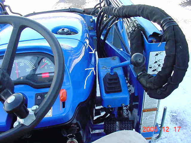

</font><font color="blue" class="small">( Glad to hear you got it to fit. I just noticed this thread and my first thought was that it wouldn't fit without some involved modifications. If possible could you post some pictures up of the modifications you had to do? It might be of use to some of the other members in the future. )</font> Some pics attached of the TC30 loader valve modified to fit the TC33 as you requested: Pictire 1 clearance notch in side cover for mounting pedestal:

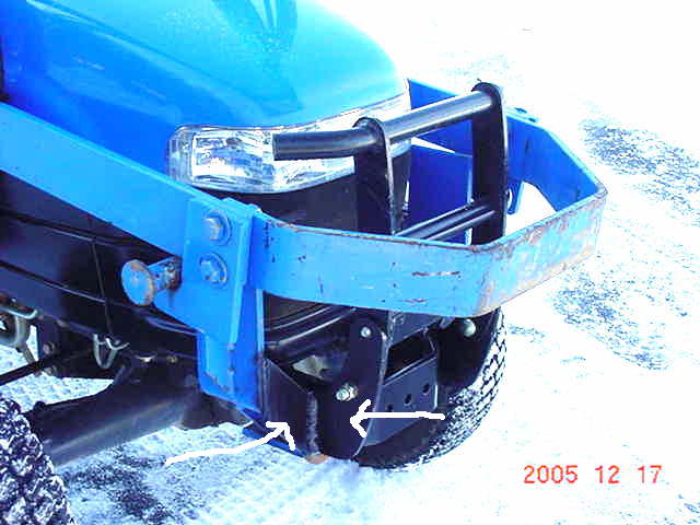

#12
picture 2 hood clearance

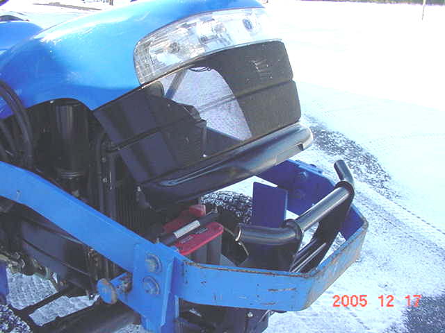

#13
picture 3 valve cover notched to clear hood

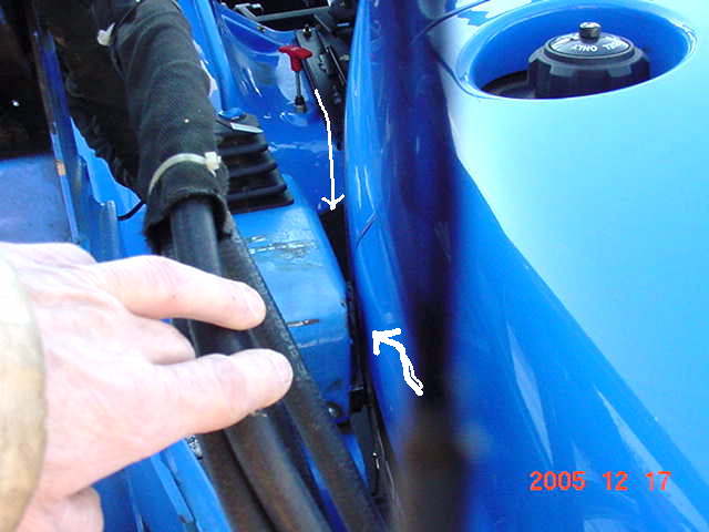

#14
Grill guard modified to fit front loader mount:
   / 7308 Loader Questions
#15
Grill guard open & tilted- hood clears !!
