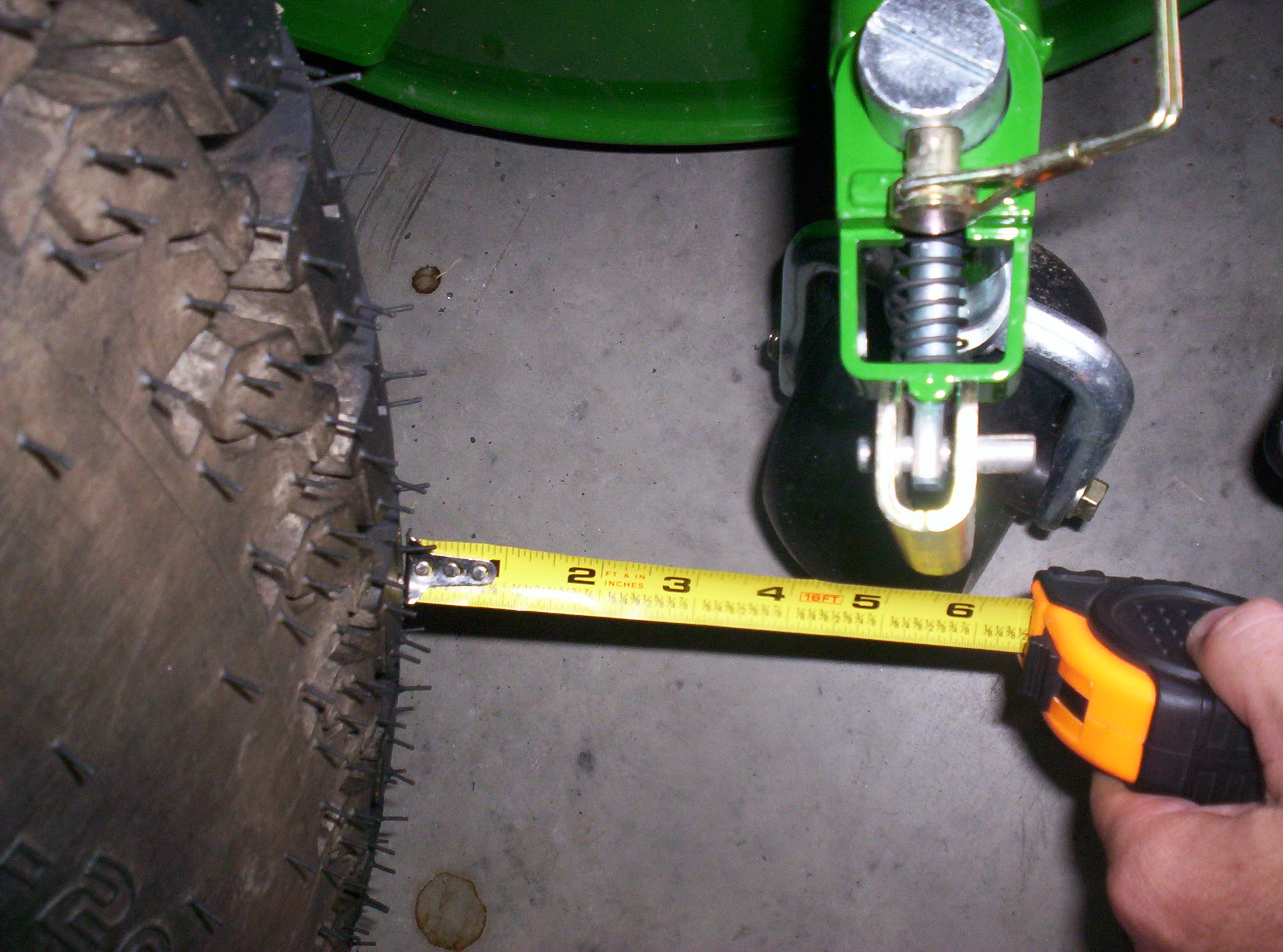

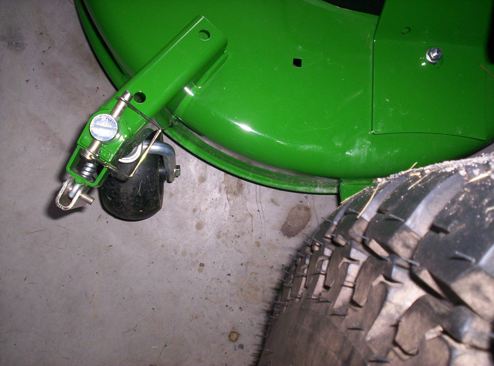

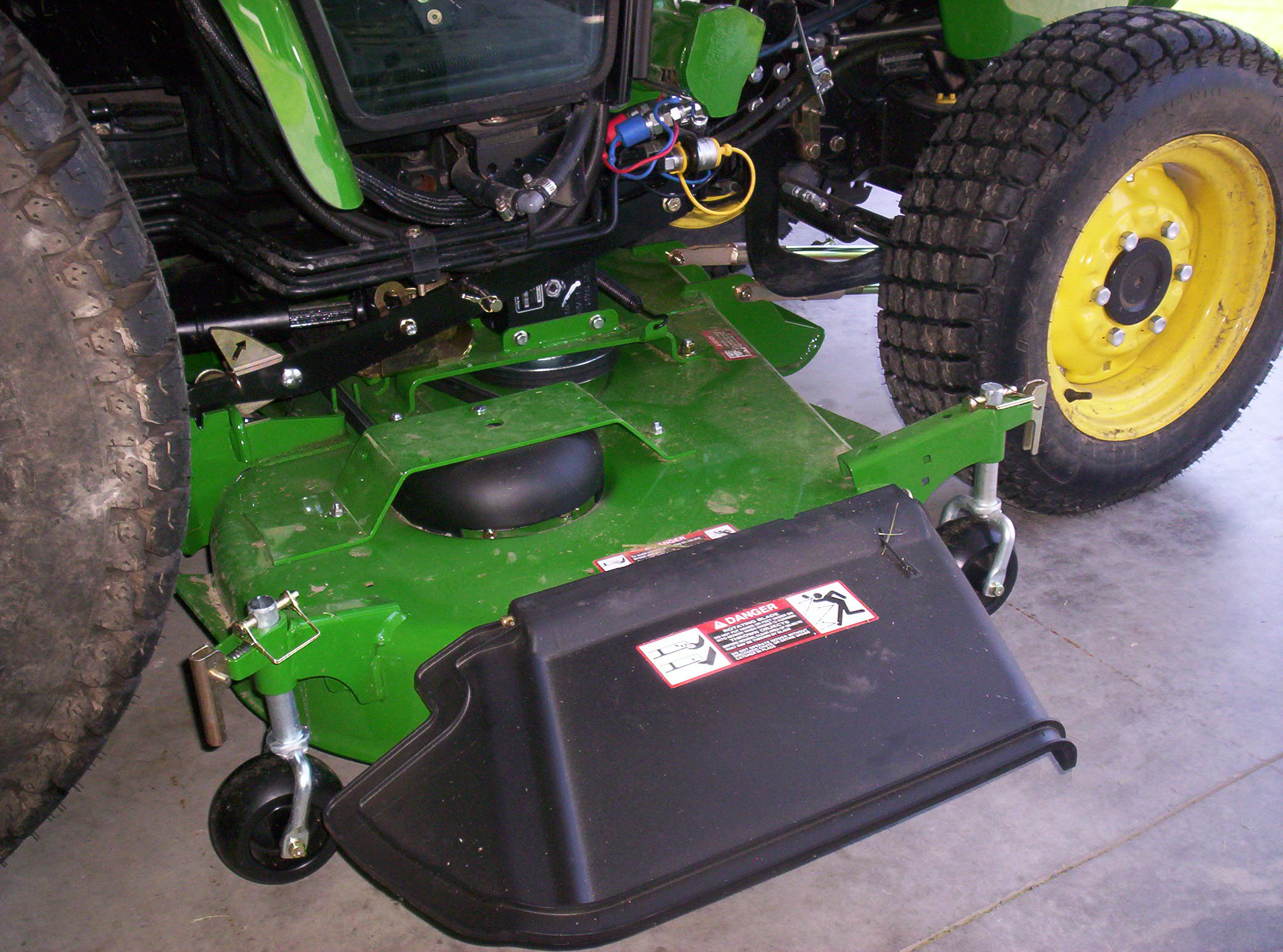

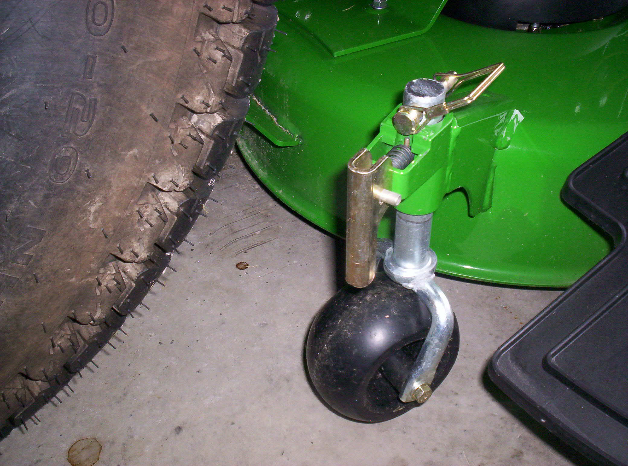

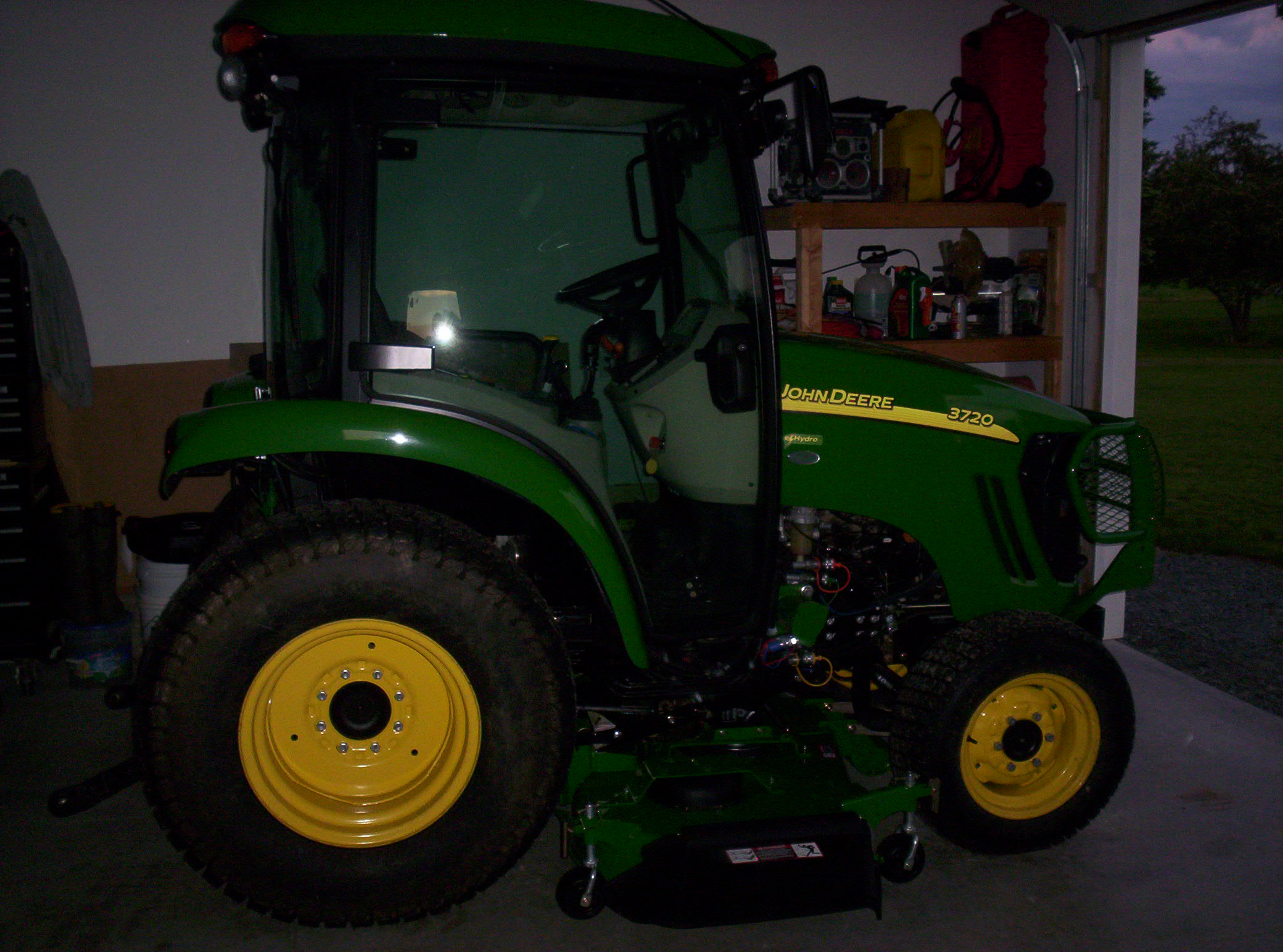

   / 72D Auto Connect MMM - Spacers and R4s? #6
Hello all, I am considering purchasing a used 72D Auto-Connect Mower deck. I am currently running R3 Turf Specials, but I think that if I purchase a 72D Auto-Connect Mower deck, the right rear castor wheel will be in the way of my right rear tire.I have seen that other forum members have these decks on the 3x2x units, but I believe it is with R4 tires and even they are cutting it close on clearance with the 72D Auto-Connect MMM. Does anyone have pics of their 72D Auto-Connect MMM and the tire clearance? Are any of you running spacers for more stability with the R4s?
Nuru,
Here are a couple of shots with R3s. I'll note that these (rears) are mounted in the widest position. Plenty of room. First two photos are of the right side and it's the closest to the tire of the two sides.
Nuru,
View attachment 322266View attachment 322267View attachment 322268View attachment 322269View attachment 322270
Thanks for the pics!
OH ok, you have the regular R3s vs the R3 Turf Specials like mine. My tires are quite a bit larger than your R3s. I think that right rear anti-scalping wheels may be an interference issue for my tires.
