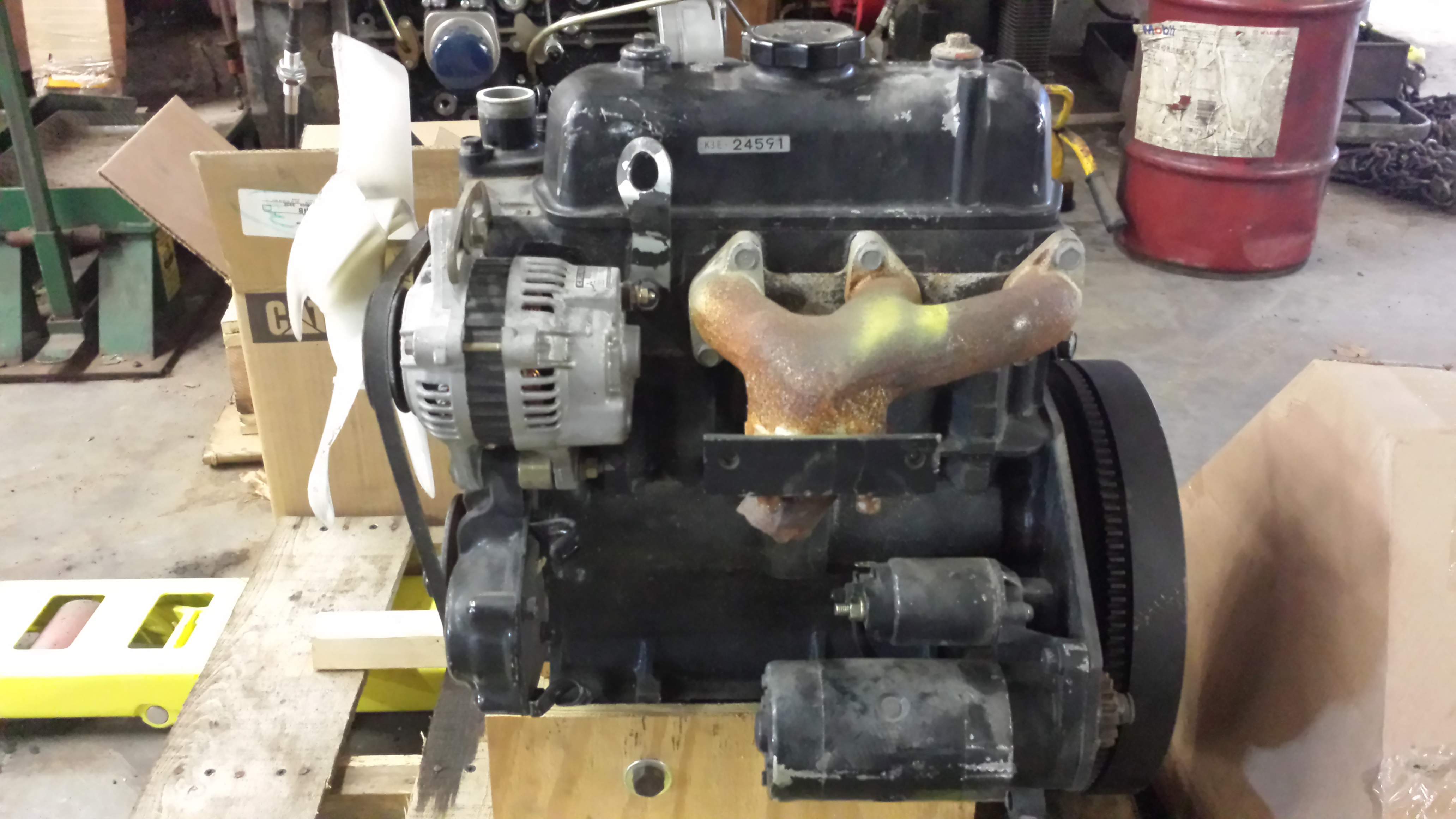

#28
UPDATE: Machine lost oil pressure (no light) and cracked the block… K3G is junk. I found a replacement K3E or F in Tennessee. Shipping soon. Will post pics of the install and finished product.
   / 7235 Help
#29
2014-12-13 10.07.33.jpg Here is the K3E ready to be fitted.
