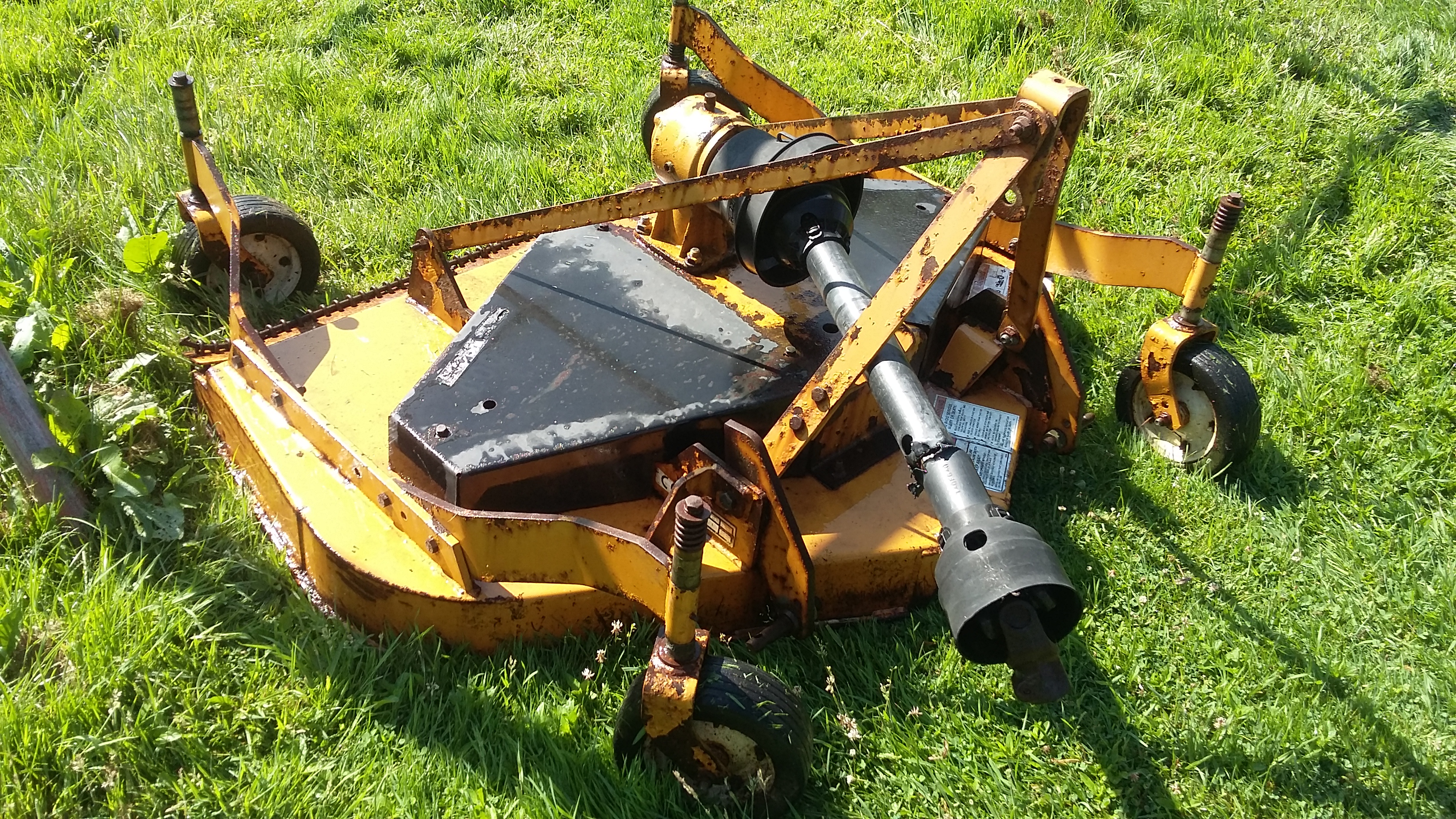

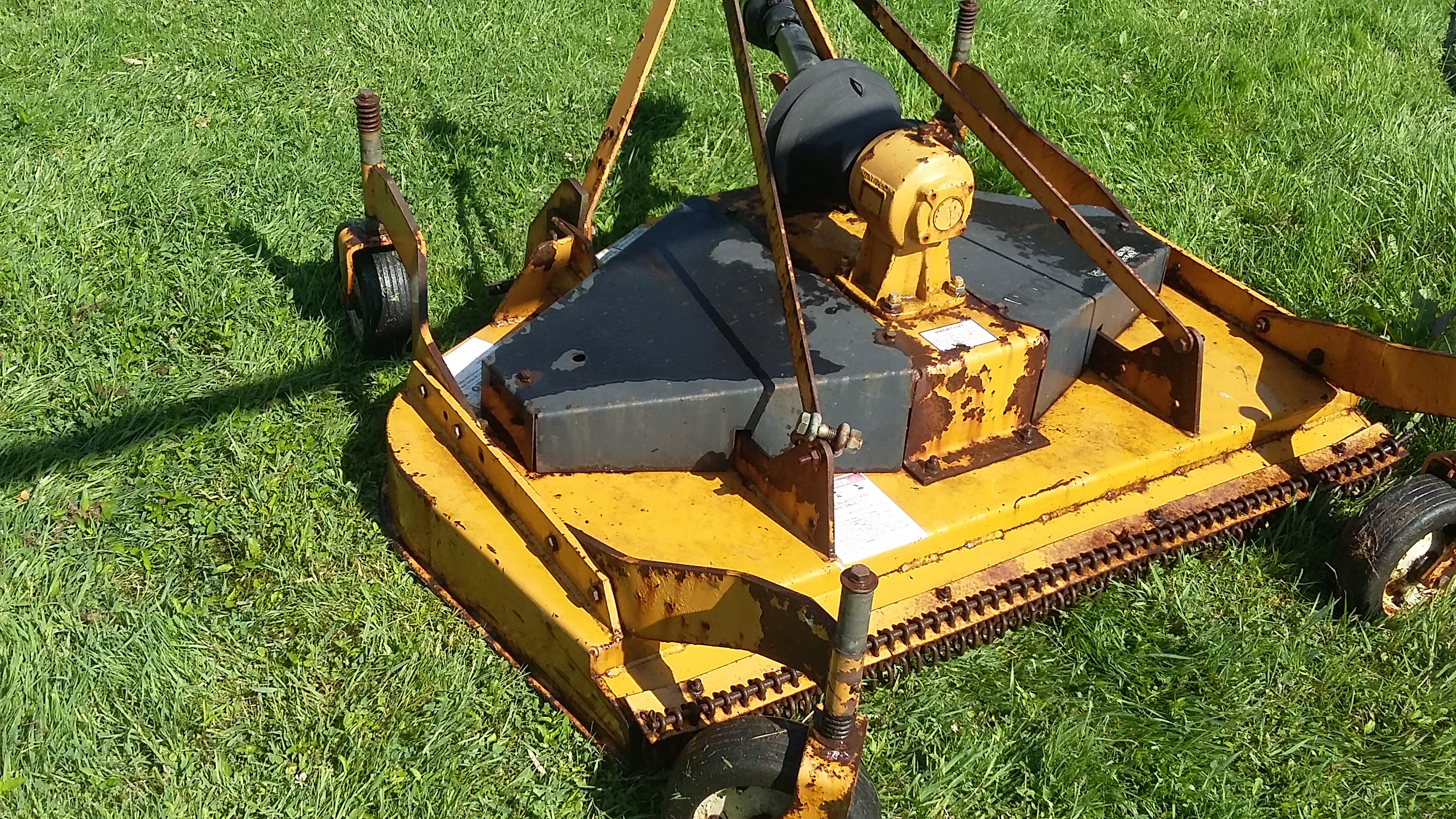

This is the one for $1000 locally, he says that he bought is used and that it was about 5 years old when he bought it, and he bought it about 5 years back. So he is unsure of the true vintage. The serial number appears to be 642736, would any of you know if this might be a good unit that was made before the RD became the economy model? Pictures are attached.... I think I am going to try to make a deal on this one. I can clean it up and paint it Kubota Orange and it will be as good as new once I change the oil in the gear box and replace the blades with some of those Gator blades.
What would you offer? He is asking $1000. I am thinking $800 would be a killer deal... would you even try to bargain lower?

I actually called Woods and gave them the serial number, this is a good one!
He said it has "Rollers and cups" not ball bearings like the current RD series. I also asked about service/replacement parts and he said that for this "new" of a mower, everything is available. Okay... what would you try to start at with a price offering... it's advertised on social media, so I assume that he totally expects to bargain to an agreeable price.
   / 72" Woods PRD7200 vs TS and RK and??? #17
What do the blades look like? That can tell you if he hit rocks or if it's been taken care of (somewhat). If they are bent or the cutting edge has not been touched... Did you look into the gear box and dip some oil out. If it's empty or if the gear oil is milky (mix with water), walk away.
That looks to me to be in rough shape. $800 would be the max, if he doesn't take that, I would give him my number and tell him to call if he changes his mind.
He is 2 hours east of me, in Indiana Pa. so all I have is these photos that he sent to me. I am assuming that if I get it for $800, I will immediately buy new blades, new belt, change the gear box oil, wire brush the entire thing and brush it Rustoleum Kubota Orange inside and out so that it is color matched to my new collection of toys... er... I mean tools. So, as long as the gear box is not torched, everything else would be addressed. How much is a new gearbox if that were to end up being junk? If it is only $150 for a gearbox from Woods, even that is not a total deal breaker.
Structurally, the steel appears sound. I see light surface corrosion only, no actual degraded material. Maybe I should have said $650 :(
