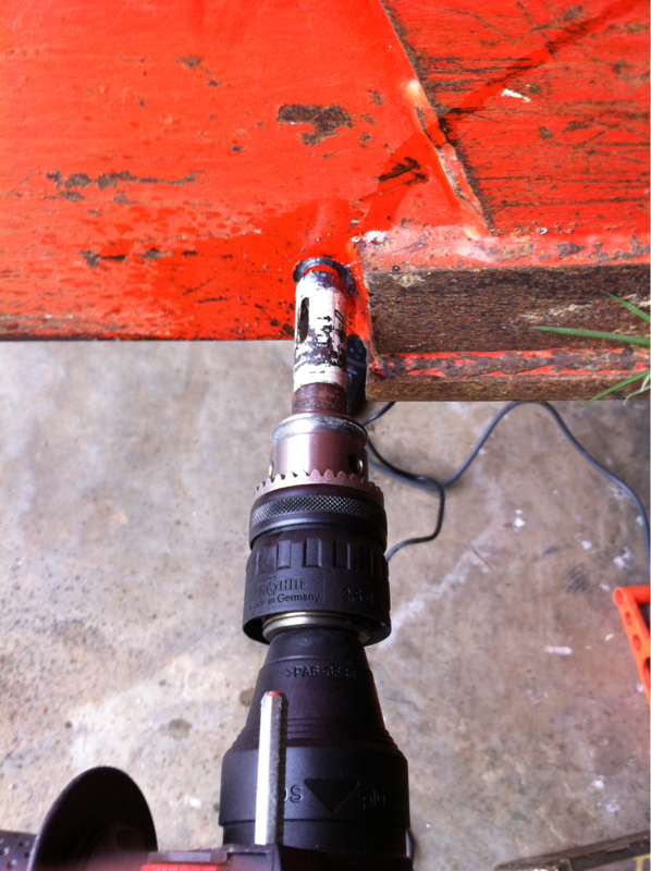

Well I finally got around to installing my new BXPanded Piranha tooth bar on my Kubota L3830 with 6' bucket. I'm including pics of the install.

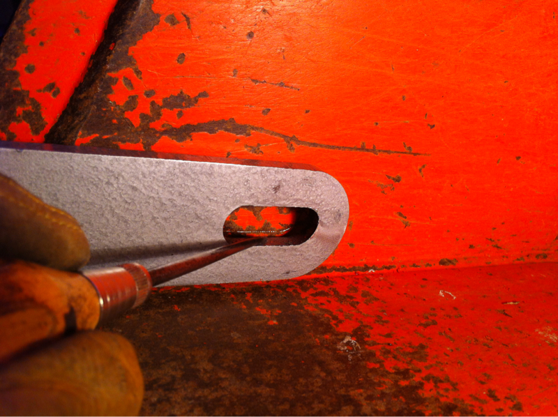

Install was fairly simple. I put the bar on the bucket, traced the hole with a scratch awl and then center punched for drilling. I drill pilot hole with 3/16" twist drill. Cut like butter. Then drilled 3/4" hole with a hole saw I had laying around. Worked well too.

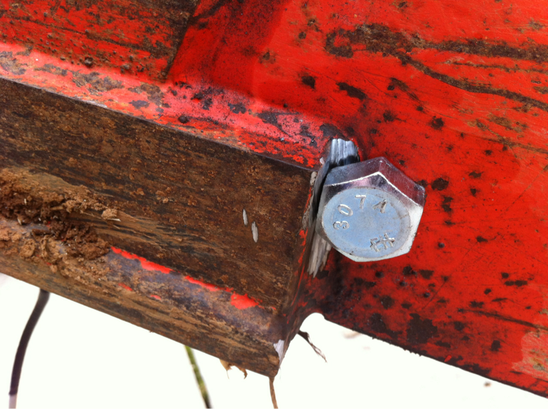

The only issue I had with install was the bolt holes were very close to the reinforced corners of the bucket. Luckily I only had to trim a small amount of weld and metal to allow for the bolt head clearance.

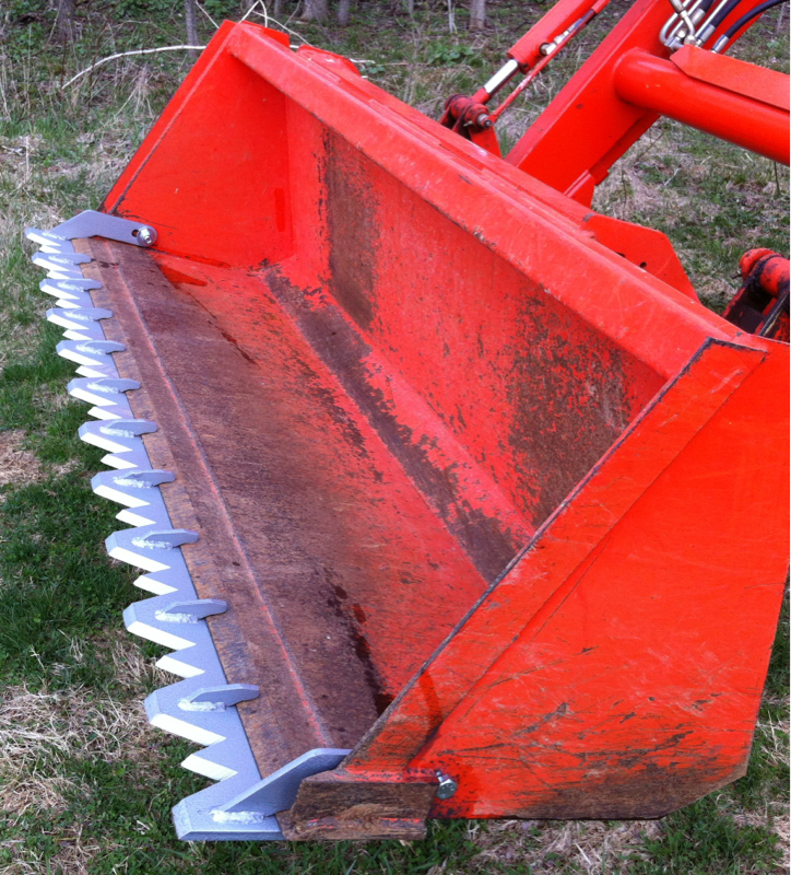

I tested the Piranha out on a dirt pile. Really digs in! I can run in 2wd and still get a full bucket. It's slices into the pile.
Also tested removing honeysuckle bushes. I was very impressed how the bar grabs the bushes and rips them out by the roots. Makes quick work of the invasive beasts!
I've not had much time with the bar to do much testing. However I'm impressed with fit and finish of bar and overall rugged build. And company was great to deal with! So far I highly recommend the bar. I think is superior over a standard tooth bar with points. At least in dirt, sod, and brush.

   / 72" Piranha Tooth Bar Install and Review! #6
Good looking install.
I was wondering how these tooth bars with only 2 bolts work for dragging in reverse, looks like the bar might flex out in the middle?
The bar is supported by tabs along the bucket edge... So it cannot flex. It would only flex if the bucket does. In fact it strengthens the buckets edge. The bar is very thick steel around 5/8" to 3/4" I believe. My size tractor will certainly not damage it.
Bolts are 5/8" so they should have no problem secure bar in place.
