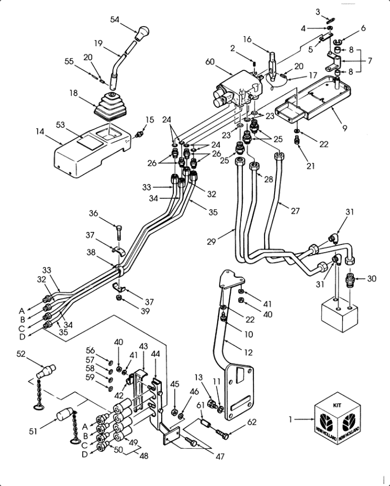

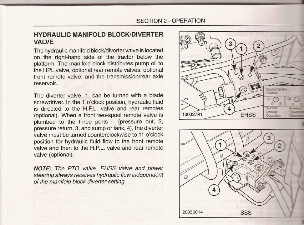

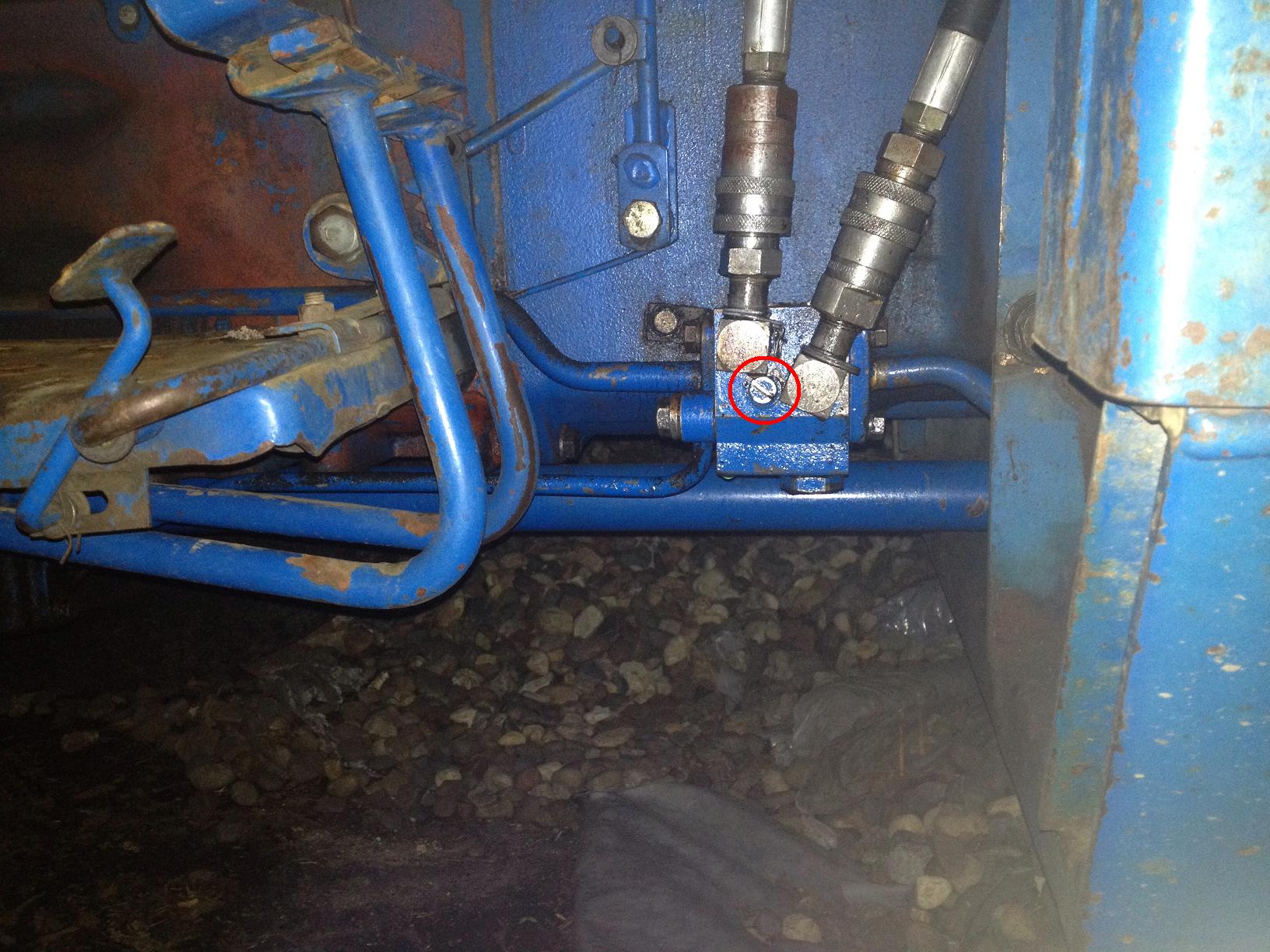

ok sorry I thought that it was pretty clear, let me try again... So my ford 1710 hydraulic Control/diverter Block on the tractor has two ports for hooking up hydraulic accessories See picture. One ports is pressure out, and one is pressure return. The loader Control joystick I am using from the 7108 loader has 3 main ports that are supposed to connect to the tractor. The other 4 are for the cylinders on the loader. So in the picture attached its line 27, 28 and 29.. From what I understand these three ports are for Pressure out, pressure return and sump or tank. I am not really sure what the sump or tank is. Can the extra port on the loader control joystick just be capped? I am curious if on the 1920, 2020 tractors have the hydraulic systems in series and my ford 1710 isn't and it s a parallel system. Thoughts??

Pressure is flow from the pump to the valve. The return on your 1710 will need to accept the power beyond flow from your valve. The return port from your valve should be connected anywhere you can get the oil back into the tractor transmission/rear axle housing without restriction. You cannot plug off the return and you should not tee the return and power beyond together.
/ 7108 loader on Ford 1710 #5
I am not familiar with your loader or tractor.
From what I see, I am guessing flow is into the valve in line x and returns in line y under normal operations and the third line z is a line for power beyond.

What is power Beyond?
/ 7108 loader on Ford 1710 #11
The only appreciable differences in the hydraulic systems is your 1710's lack of a return port for the loader control valve and the priority flow divider you have if your 1710 has power steering.
Power Beyond is the flow of oil exiting a valve that is available to downstream valves for use in hydraulic functions. In your application the PB will supply oil to the 3 point hitch valve.
Two hose loader valves such as found on a 770B loader installed on a 1710 would combine PB and return flow to one port and one hose. That is not good practice, not recommended for your 7108 valve and in my opinion (stated above) is not something you should do.

ok.. I guess I will have to find a place to tap into a return then. Ya I was curious as to why the earlier set up with the 770B loader didn't have the return to sump..I know my diverter valve goes to sump, but that is only pressure relief from what I understand, which is where I was getting confused I guess. You are right though my 1710 does return to the 3pt hitch valve as well. Do you know why the design change or what problems the older 2 port/hose system was causing?

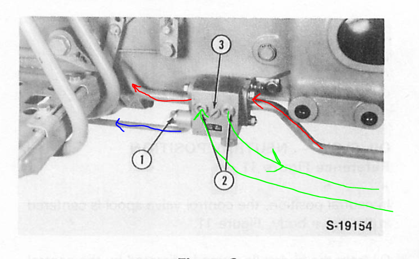

ok thats what I figured... just wanted to be sure. So I guess I will have to find a place to run the return back to the sump. Do you figure I could tie that line into the relief return to sump hard line that is coming off that diverter block? Shown here in the blue arrow? I didn't really wanna drill and tap my case with a new fitting if I didn't have to.diverter valve flow.png

the Hydraulics aren't as bad. You just need to figure out where to make the return go. I decided to run to the same spot as the relief off the diverter block near the back axle. I had an extended JIC fitting machined to match the banjo bolt, then I just ran a hydraulic hose to the end of it. So that fitting will see the relief of the diverter block (so if I over pressurize the system) and the return of the hydraulic control. You could just drill and tap the side of the transmission case as well too. I know some 1710s have a port already there.

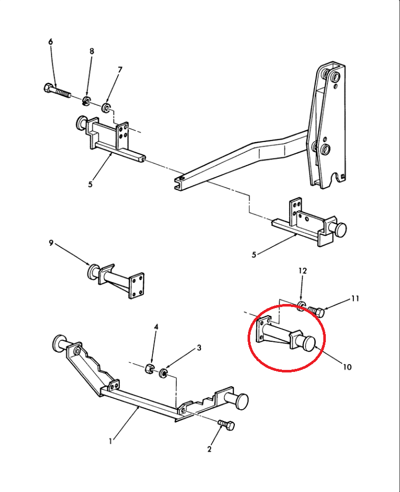

for the rear mounts you would need to do something with these

Wow you built the entire loader! Beyond impressive. Thanks for the info. Would you show a pic of the rear bracket on the left side. I can modify the right bracket but wasn't sure what to do with the other side where the steering shaft is right in the way. I found this pic of one that looked like the way to go.
