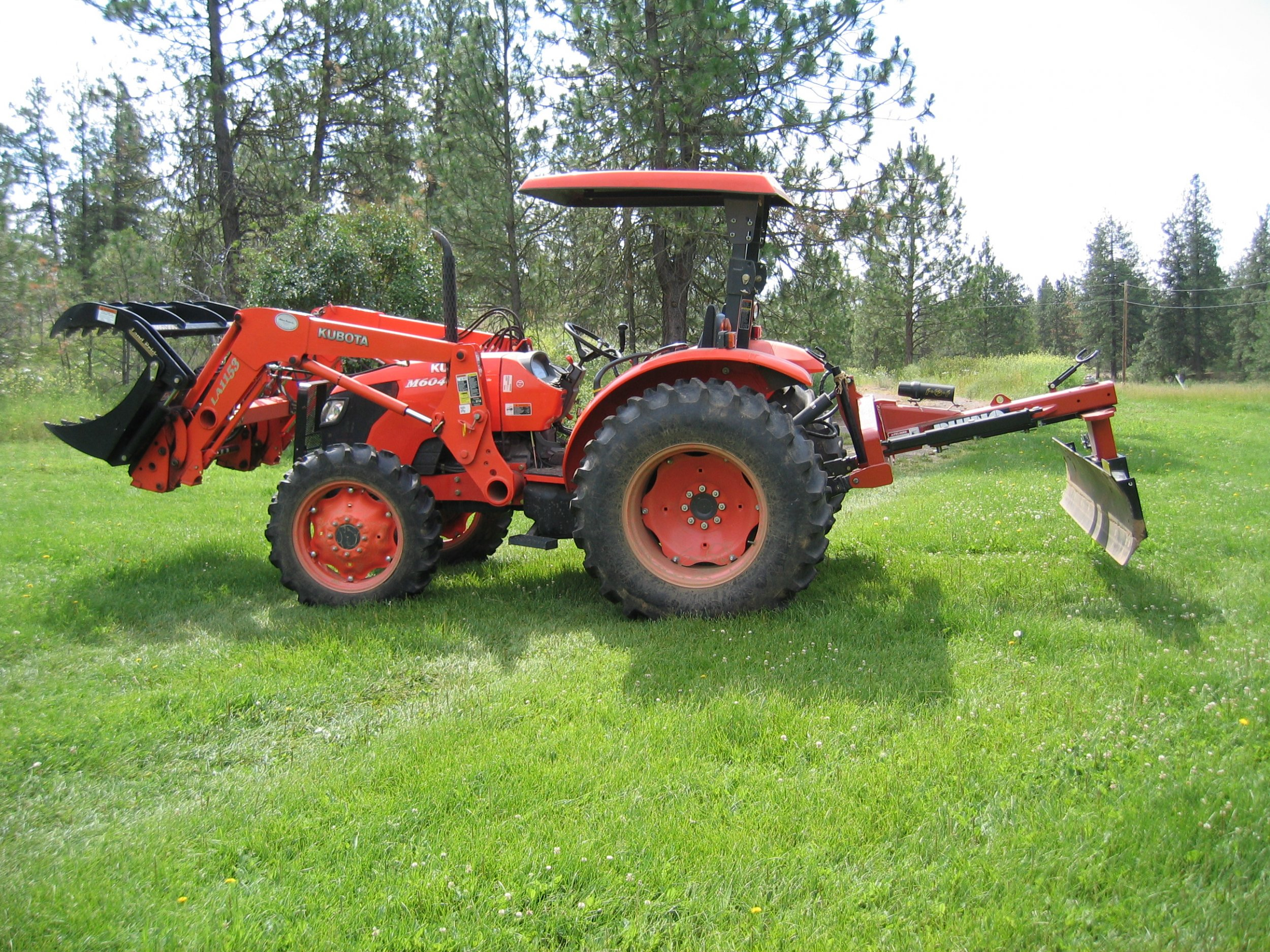

Seven foot was right for me,, because I found it as a used blade,, at the right price,,
Obviously, it is not wide enough for this tractor, but, it is track wide enough behind my JD 4105, which is similar to the OP's tractor , HP-wise.
I would never consider a 8 foot blade, I only have 1,400 feet of driveway, the 8 foot blade would be a problem when turning around, etc,, for me.
My JD would quickly run out of HP doing gravel work with an 8 foot.
HECK, I have a 6 foot blade I use sometimes for dirt, and gravel.
The 7 foot blade in the pic can have the boom pivoted right at the 3 point hitch arms, so even though the blade is only 7 feet, I can move snow WAY off the driveway to one side.
That is a great feature of this blade.
If you do decide to get the 8,, a few minutes with a torch will allow you to narrow it,,
ADDING width is FAR more difficult, so, if you GOTTA try an 8 foot, converting it to a 7 is SUPER-EASY!!
I also have a 7 foot finger rake, and a 7 foot landplane,, my mower is 6 foot, because I could not find a 7 foot at the time that I wanted to buy.
Maybe the fact that all my attachments are virtually the same width makes it easier to operate all of them well? Just making a wild guess,,,
