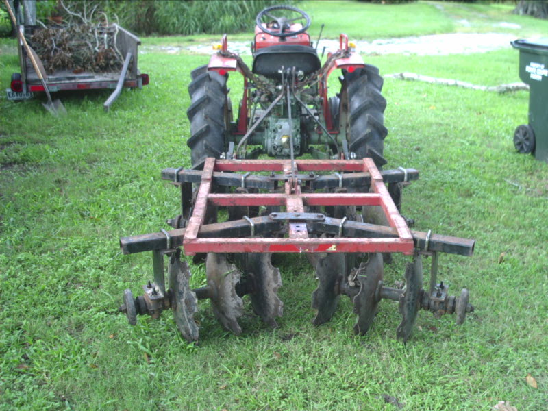

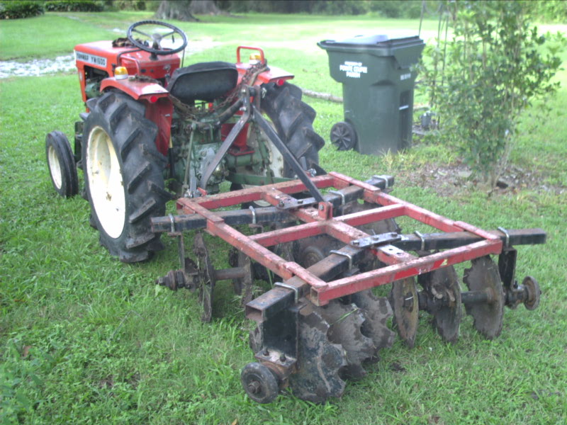

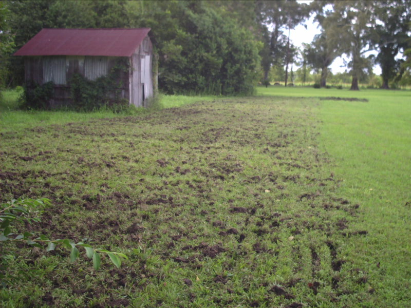

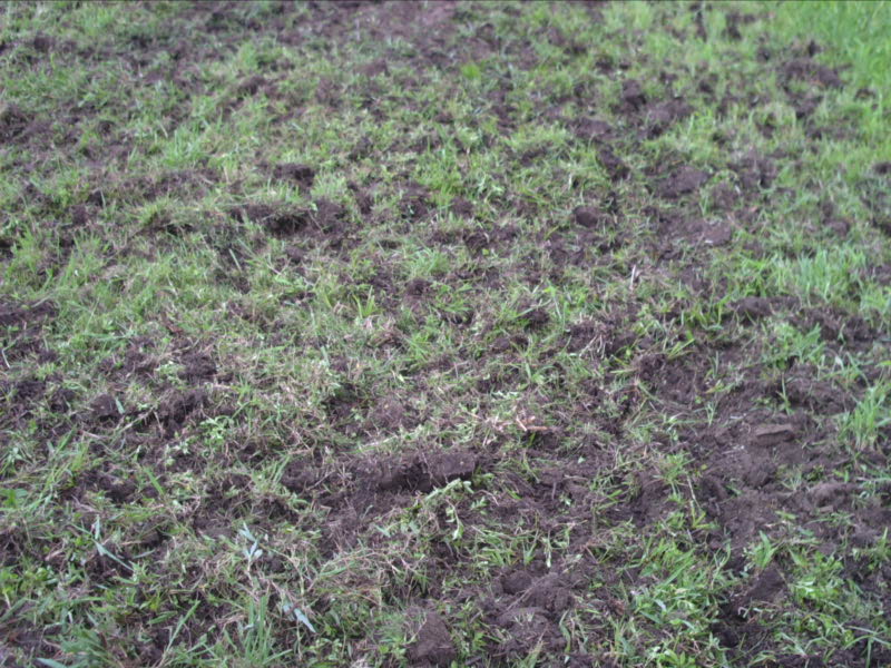

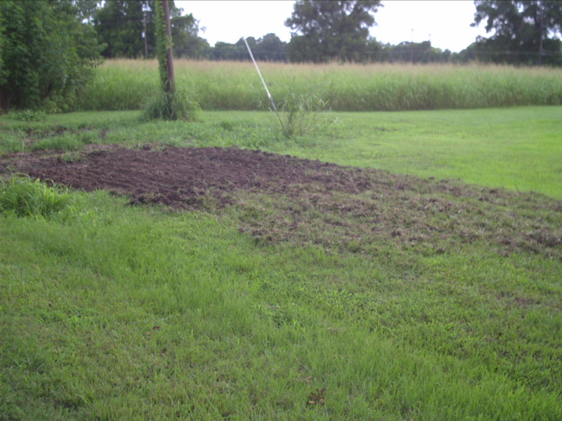

   / 7 ft disk to big? #6
California said:
Later I found a 4 ft Lienbach and that feels about right.
Yes Sir, I agree, my YM1600 feels the best after removing the 4 outer most disc's. See Pixs, ran field tests today.
8ball3290 said:
i figured it would be to big.. have a tiller already but this was a good price.... oh well someone else will grab it.
How much $, those things are not cheap new.
The only issue would be its weight while lifted with the 3pt for getting around. ? add weight to the front bumper. I see allot of folks adding weight on their Disc Harrows so they will cut deeper. Probably no need with 7 footer running fewer discs.
If you look at pix you will see I removed the four outer discs on my 5' model. I plan to run more tests using 8 smaller diameter discs mix matched alternately seeing if it will cut well by only having 8 cutting deep and 8 not so deep just breaking up raised clumps.
Something like that could be done with a 7 foot model. No guarantee's, but if it is not all that expensive initially to try, it may be worth it.
Rhett
