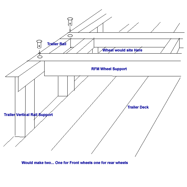

#25
Re: 7\' First Choice RFM on 6\'9
Kodiak,
What do you think about this design using angle to make a setup similar to trailer ramps? Should hold the weight and would allow the mower to be supported by the wheels.
Tie it down with some staps and whala!
Any other Ideas from my fellow TBNers will be appreciated. I am sure there are other ideas out there that havn't been mentioned yet!
Keep them coming!
   / 7' First Choice RFM on 6'9 #26
Brandon:
I agree it certainly looks sturdy, but weight is going to be the problem. Are you going to want to muscle that much weight around, two times per trip. Thats why I was thinking in terms of wood. Also some one here just mentioned that a good center support would be using the plastic milk crates, they are 12" square. Actually by lowering your gauge wheels, thus raising your deck. And setting each one on a milk crate, it should support the weight of the mower. Without the deck having to be in contact with the rails. Just as you've suggested with your heavy support.

   / 7' First Choice RFM on 6'9 #28
The C channel wouldn't have to be that big because you could turn the wheels sideways. /w3tcompact/icons/clever.gif You'd only need slightly more space on the inside of the C channel than the width of your wheels. A couple pieces of angle iron as you show in your sketch would work just as well if you just spaced them properly and welded a couple pieces of flat stock between them to keep the spacing right. That would allow for a track in the center for my next idea for you. /w3tcompact/icons/wink.gif/w3tcompact/icons/smile.gif/w3tcompact/icons/grin.gif
Now that we've solved that problem, let's address securing the mower to your new supports. How about J hooks with threading on the long end or U bolts for this? You could put the hook over your wheel support on the mower and drop the other end down between your pieces of angle iron then use a plate with the appropriate size hole(s) as an oversized washer and finish it off with a wing nut over a light lock washer. One of these on either diagonal wheels and you're all set. /w3tcompact/icons/smile.gif
