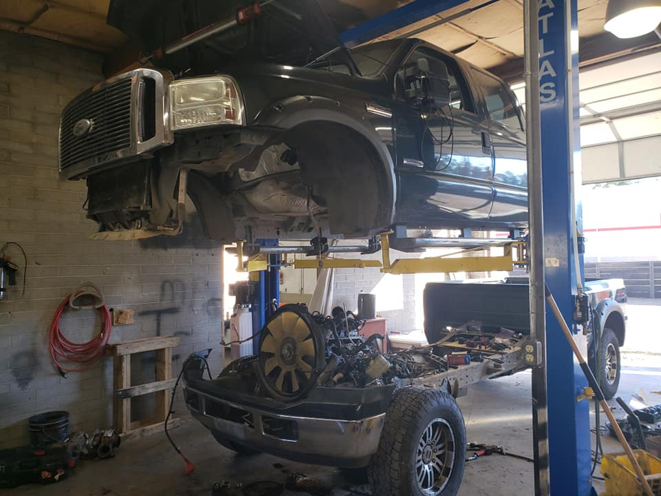

Anyone know if the cab needs to be removed to service Godzilla motors.
   / 7.3 gasser #2
My son says no. His shop does a lot of Ford diesels, mostly 6.4's, Lol
   / 7.3 gasser #3

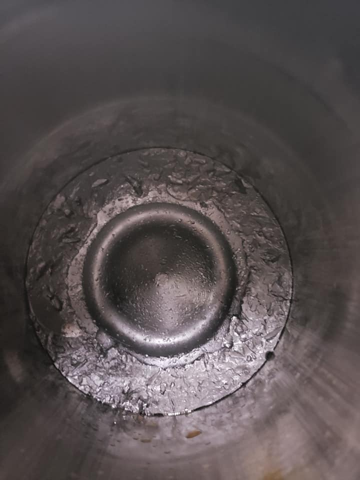

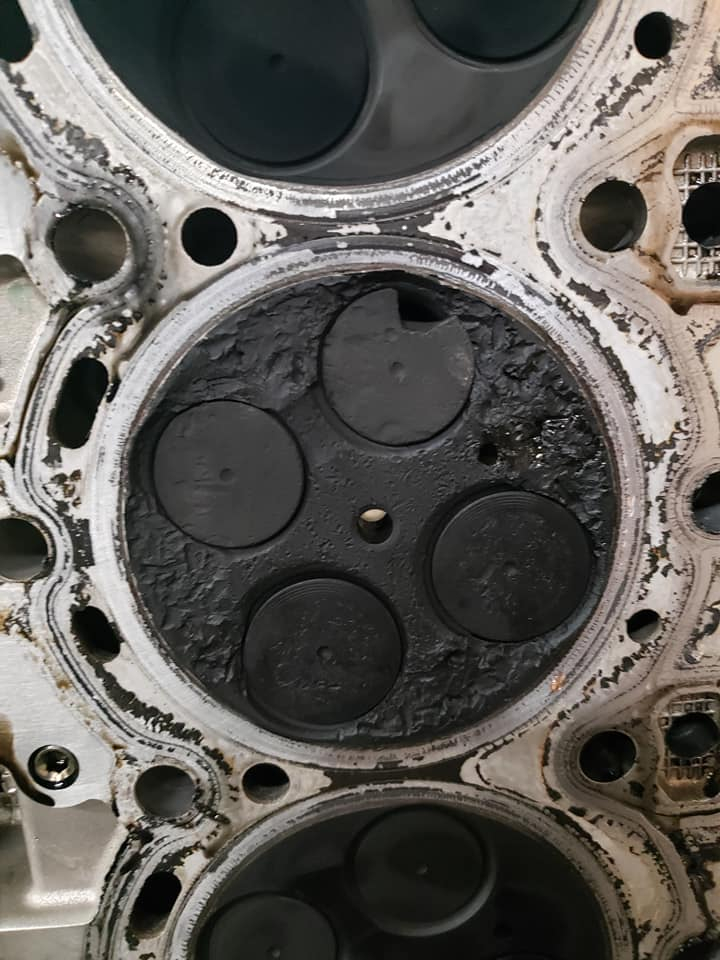

View attachment 727757View attachment 727758View attachment 727759
Those 6.4 were monsters, but the 1st gen of DPF motors. Using the exhaust stroke to dump fuel in 7 & 8 Cylinders to provide the fuel to burn off the DPF was a mistake. It just diluted the oil with diesel fuel and cause a lot of valves and lifters to die a premature death due to bad lubricity.

I guess I would question what kind of "service"
And there is also a difference between "have to" and it simply makes it easier IF you have the equipment.
They "say" the cab (or at least the fenders) need to come off to put head studs on a 6.0 powerstroke. But I can assure you it CAN be done without. Is it easy....nope. But it still can be done.
