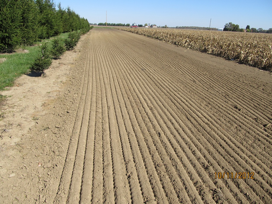

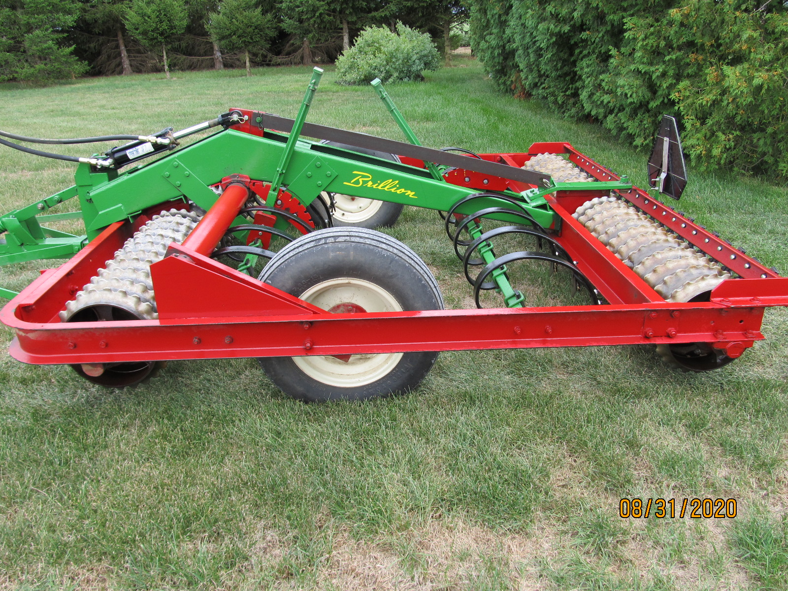

The OP hasn't said what he does with the ground but he may not need a tiller after all. There are times I chisel plow and then run my cultimulcher over the ground. I can't find a good picture of one right now but here is the end result. It's way faster than the tiller and gives a packed and smooth seedbed. I've done several threads on cultimulchers on the TBN.
Oops--Found this pic of a smaller (9 ft ) Brillion cultimulcher. Most are 12 ft-15 ft and up. Notice it packs and then cultivates and then packs again. gives you seedbed like the first photo. It's all cleaned and oiled for winter storage so is never this clean.

Looks like blow sand to me.... Put that sucker in heavy clay and 60 pto won't be nearly enough.
You might need to take a soils class if you think that the soil in the picture posted by 3Lfarms is "blow sand".
/ 7’ tiller advice #38
Not needed, what it appears to be to me but then pictures can be deceiving. What I', alluding to is simply dropping a large tiller in anything but sandy loam will take a gob of pto power to have it operated correctly and in a timely manner. Nothing more.
