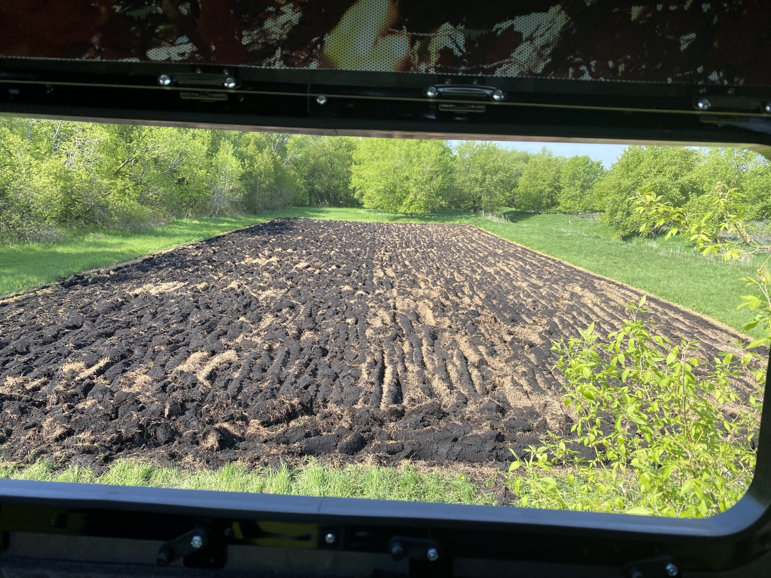

My deer plot which had not been farmed for about 20 years. Sprayed roundup to brown everything down, then plowed it with a two bottom plow (first pic). When went in with my 6 foot King Kutter tiller after that (second pic). Slip clutch never slipped though i was tilling as deep as I could. Good luck with your project!!
Pretty black soil. I wish I had a spot like that for my “human plot”
