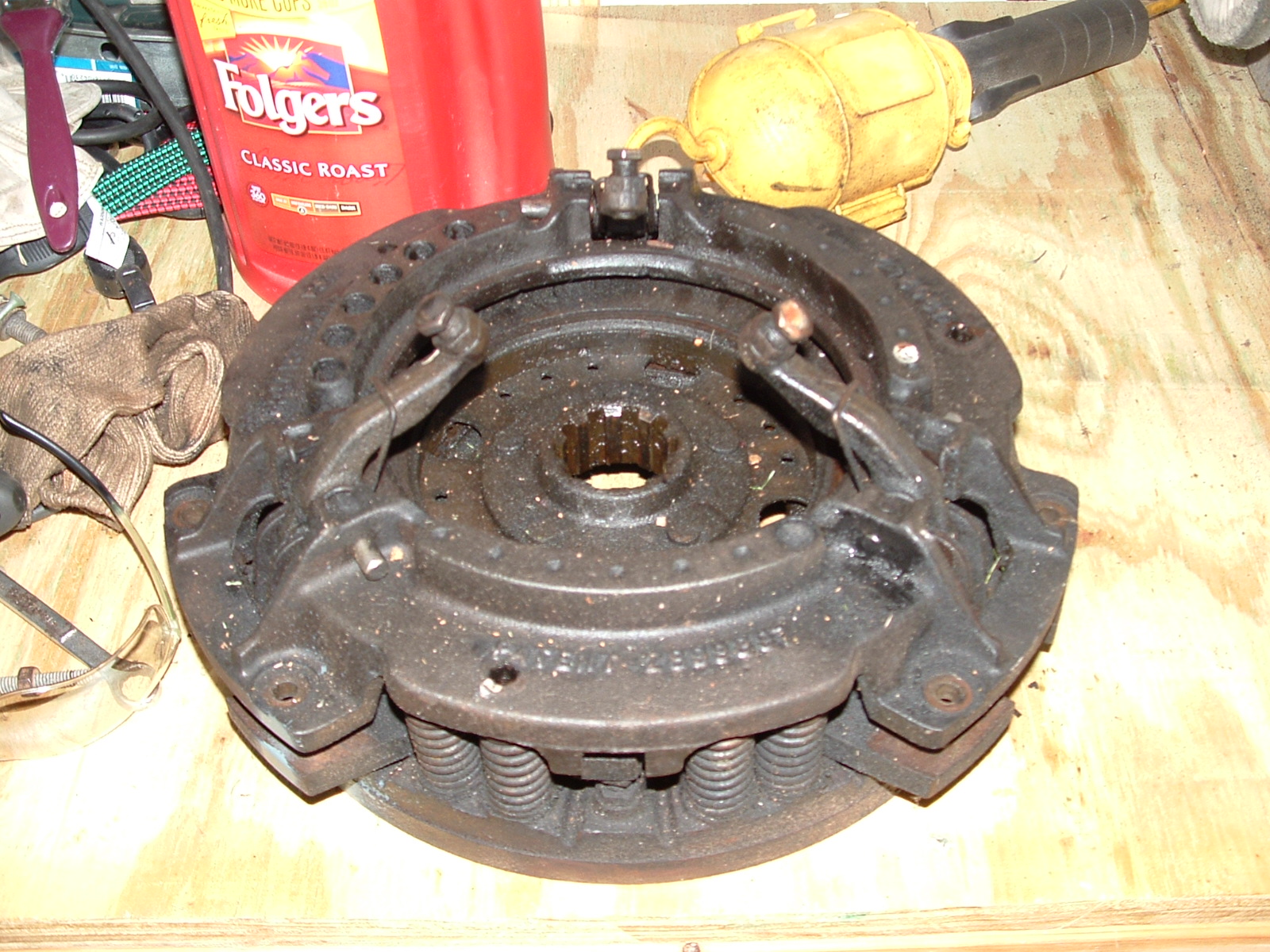

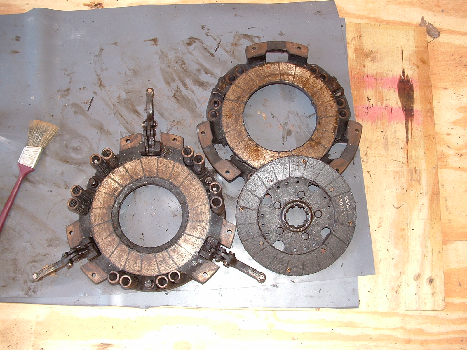

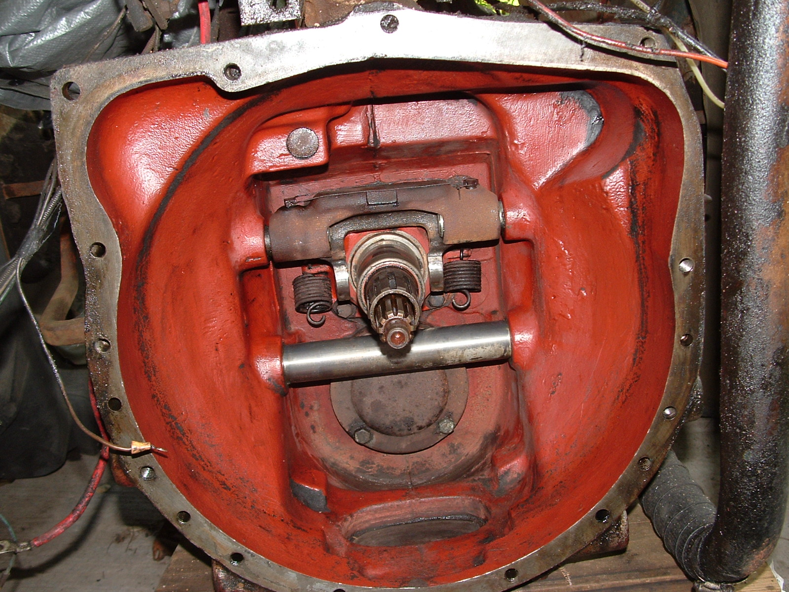

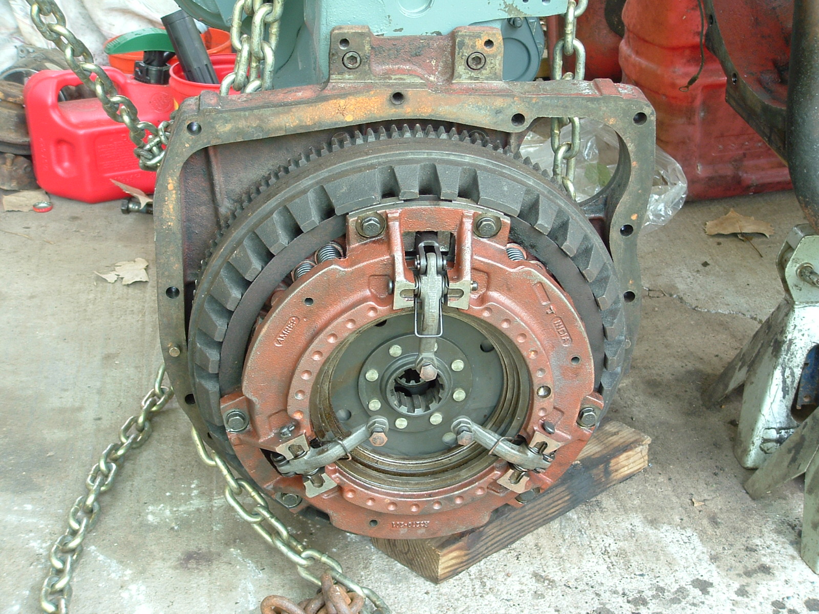

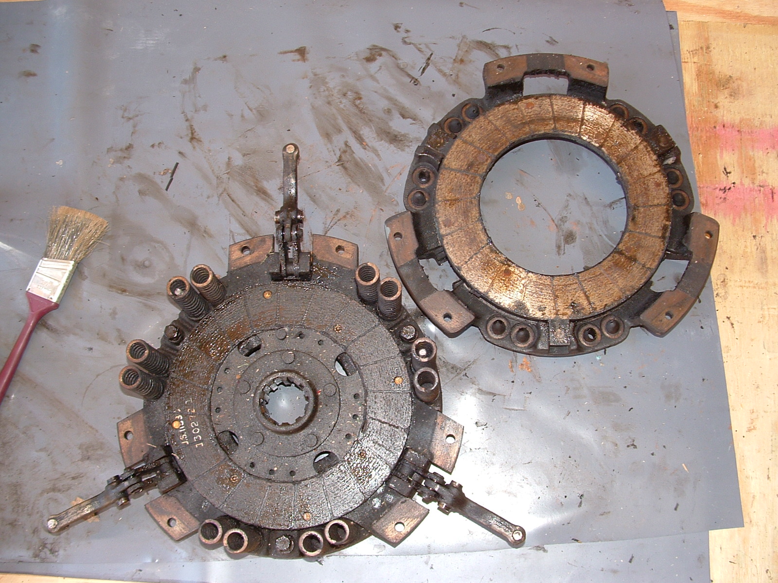

My clutch was not blown up as far as the discs coming apart, they were just oil soaked so I replaced them when I did the motor rebuild. If its any help, here is a few pics of the inside of the bell housing and the old and new clutch (dual clutch). Took the old clutch apart just to see what the inner disc looked like. TB
