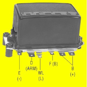

/ 66 Ford 3000 Voltage Regulator
#9
/ 66 Ford 3000 Voltage Regulator #10
never mind.. you didn't read any of my replies obviously...

/ 66 Ford 3000 Voltage Regulator #14
fuses is in near the connector for the plug in for the cluster.
wire to the front? i'd look for the water temp sender.. or see if someone scabbed in an electric fuel pump vs the mechanical one up there for the gassers anyway....
yep.. genny runs tach...
voltage stabilizer, not regulator runs power to the gauges...
