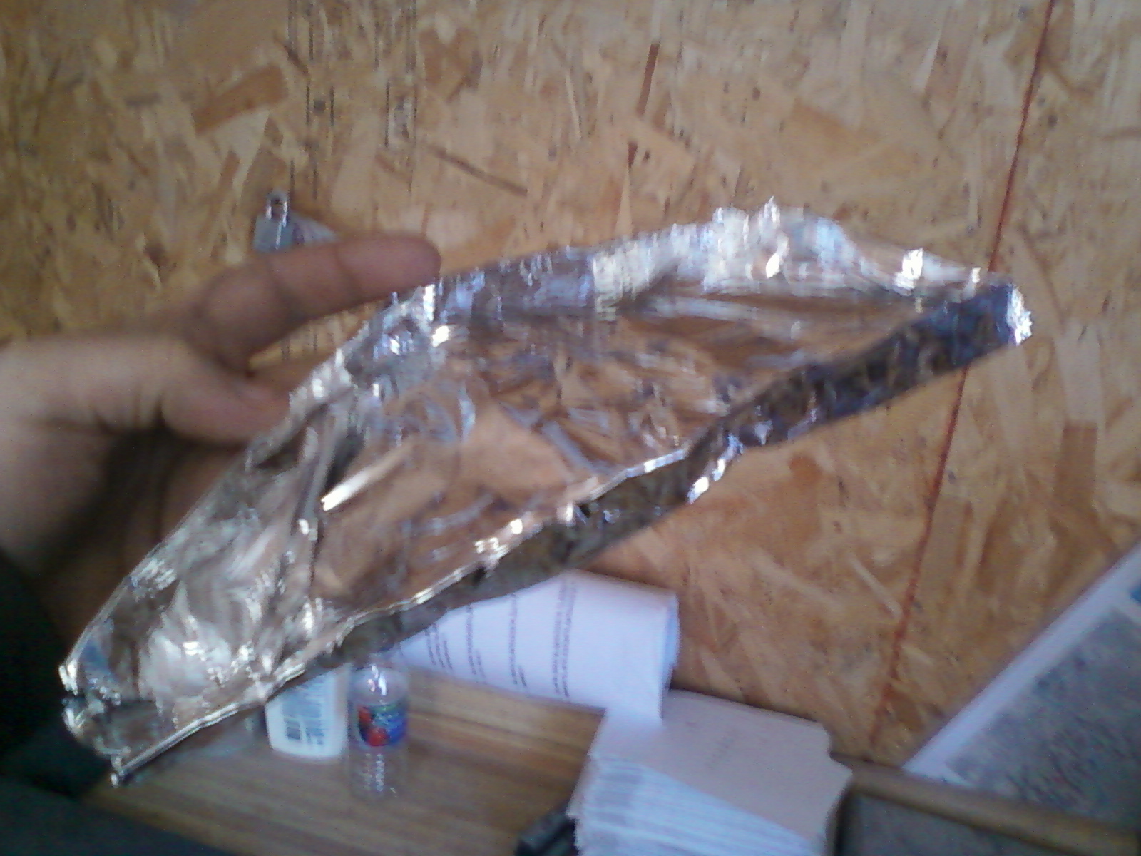

When I have a tight space when draining fluids, I use a piece of aluminum foil folded over itself a few times to make it thicker and moldable, then shape it however I need to pass it between the drain and whatever's underneath bending the sides up fo form walls, and the other end folded down to form a spout...works great. Unfortunately it won't help your filling problem:confused3: Photo-0005.jpg
   / 6530 Oil Change .......... Absolutely Ridiculous #7
When I have a tight space when draining fluids, I use a piece of aluminum foil folded over itself a few times to make it thicker and moldable, then shape it however I need to pass it between the drain and whatever's underneath bending the sides up fo form walls, and the other end folded down to form a spout...works great. Unfortunately it won't help your filling problem:confused3:View attachment 305976
Or get your missus to pick up a couple of those molded tin cookie sheets/oven liners that they sell at the dollar stores... they are thin enough you can mold them to the shape you want, but have a bit more strength than a few thicknesses of tin-foil.
