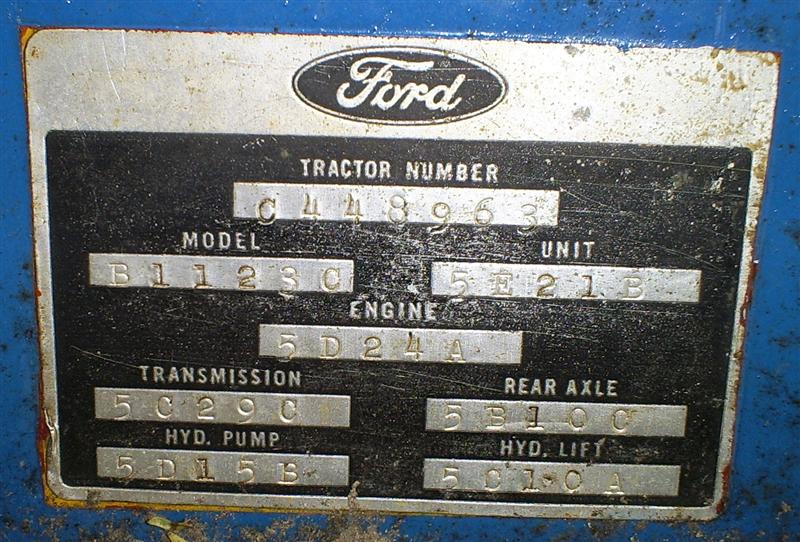

I downloaded a photo I took the other day of the data plate under the hood. Next month is its 47th birthday! :) I bought it on 4/21 and the production code for the tractor is 5/21/1975. For a second when I looked at it I thought I had actually bought it on its birthday, then I remembered this is only April. :(

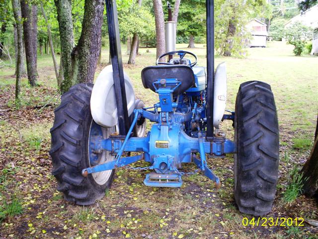

Nice tractor but I think you are a decade off.
I never learned to read all those production codes but judging by the tin and square rear axles it is a 75 not a 65.
Looks like you got a real sweet unit - power steering, 8 speed. Does it have LPTO.
I also see the foot throttle and lack of Differential lock.

Guess I need to look at it closer. I know the numbers on the data plate and those stamped on the tractor match, I looked for that first thing. Won't get back over to work on it until the weekend most likely, we'll have to wait till then.

Yep, I think you are a decade off as well.
the first clue is in the model # of the machine. B1123C
Prior to 1968, they used a number for the first digit of the model code. A 2000 would have started with a 2, a 3000=3 4000=4.....
In 1968 they went to letters. B=2000, C=3000.....
So your model code deciphered:
B=2000
11= LCG (I believe that is low center of gravity tractor)
2=Gas
3=Live 540 PTO
C=8-speed trans
And according to the serial #....I am getting 1974. According to tractor data, 1975 started with 450700, and yours at 448xxx puts it late in the year 1974.
But that really dont matter too much. Look on the bright side, buying what you though was a 1965 and finding out it is a 1974/1975 is a lot better than buying what you thought was a 1975 only to find out it is 10 years older:confused2:
Sources:
FORD CODES and SERIAL NUMBERS
TractorData.com Ford 2000 tractor information

Thanks everyone for your help. And I can't believe I misread the date. I had actually printed out that page on IDing old Fords here:
On that page they list a production number starting with a 5 as 1965, they don't even have a year code for 1975 shown on that page. What happened in 1975?
/ 65 Ford 2000 3 Cylinder #16
you can buy more parts for that 2000 than that 1710 :)
/ 65 Ford 2000 3 Cylinder #17
I am not positive, but I believe the 1975 is a 5 also. But you have to rely on the model # and serial number to know weather it is a 65 or 75. IE, model beginning with a # and date code with a 5 would be a 1965. Model # beginning with a letter and date code 5 would be 1975.
/ 65 Ford 2000 3 Cylinder #18
yep.. 75 is a 5 as well..
/ 65 Ford 2000 3 Cylinder #19
In 1975, Ford changed the numbers on these tractors. The 2000 became 2600, the 3000 became 3600 and the 4000 became 4600 and so. I had a 2600 , 1979 model and it was a great tractor. The tractor is rated at about 32 engine horse power. It will run a 72 inch finish mover, but a 72 inch bush hog is a little to much in heavy stuff. I ran a 5 foot and ran good in heavy stuff.
/ 65 Ford 2000 3 Cylinder #20
no they didn't change the numbers until 1976 and it is 32 pto horse power
