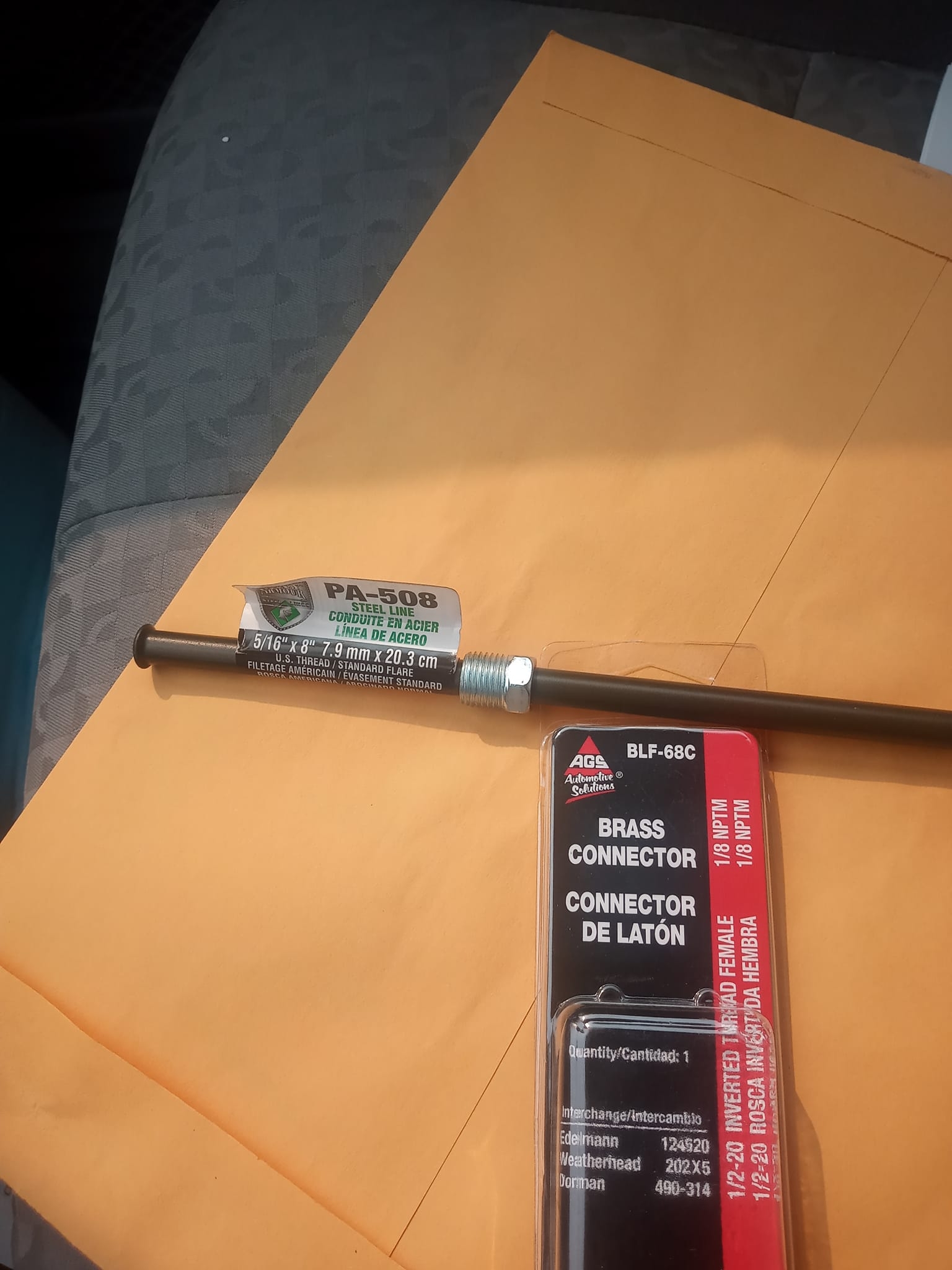

I'm changing the fuel line from the sediment bowl to the carburetor to a steel line with flared fittings. Just don't run the new fitting into the carb too far or it will break out the threaded part of the carb. That's experience talking. I was fortunate enough to know someone with a top part of the carb. I'll post pictures later. This can be done for less than $20 as opposed to about $70 for new rubber seals unless you break the carb.

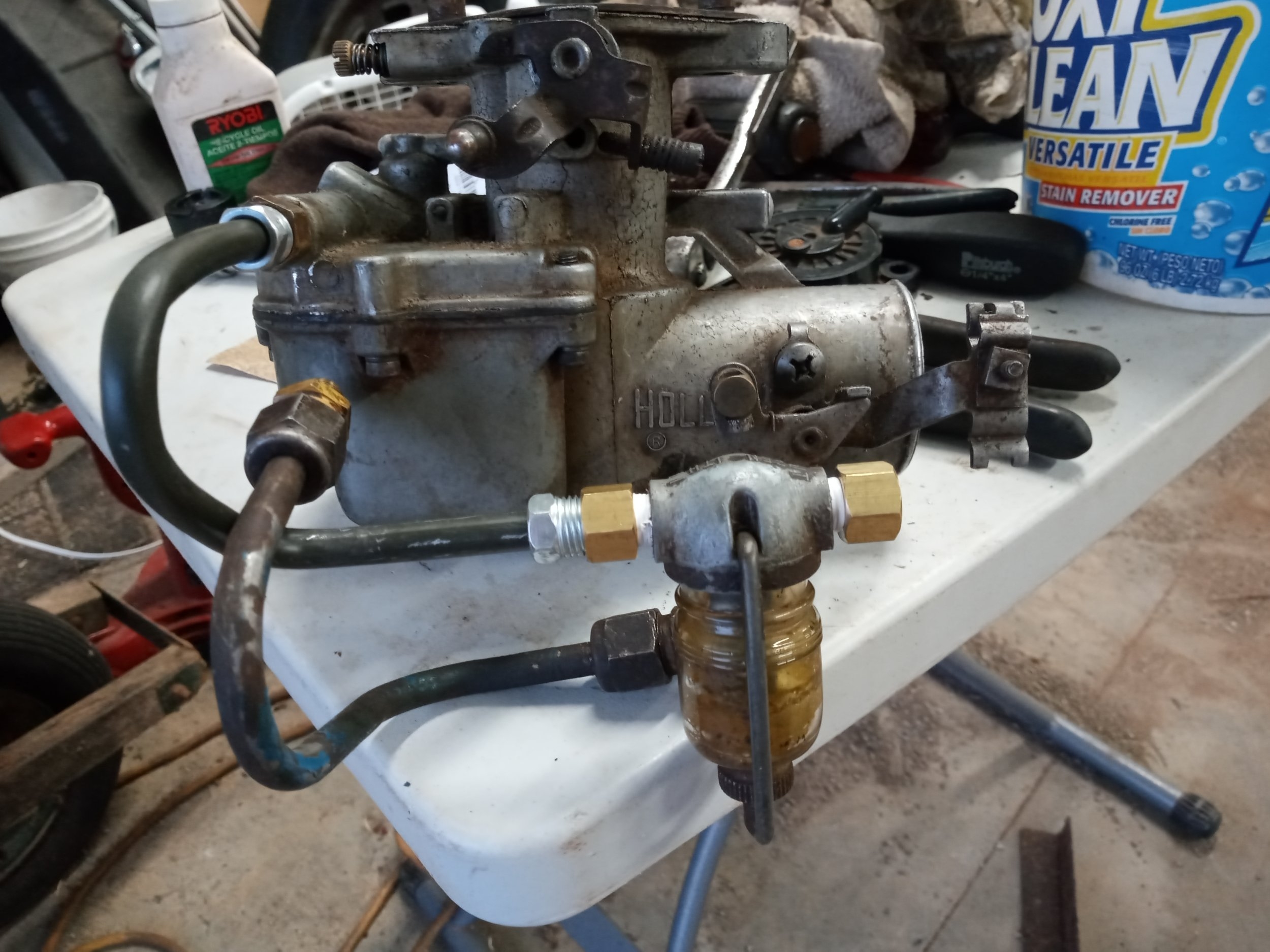

Turned out pretty good.
