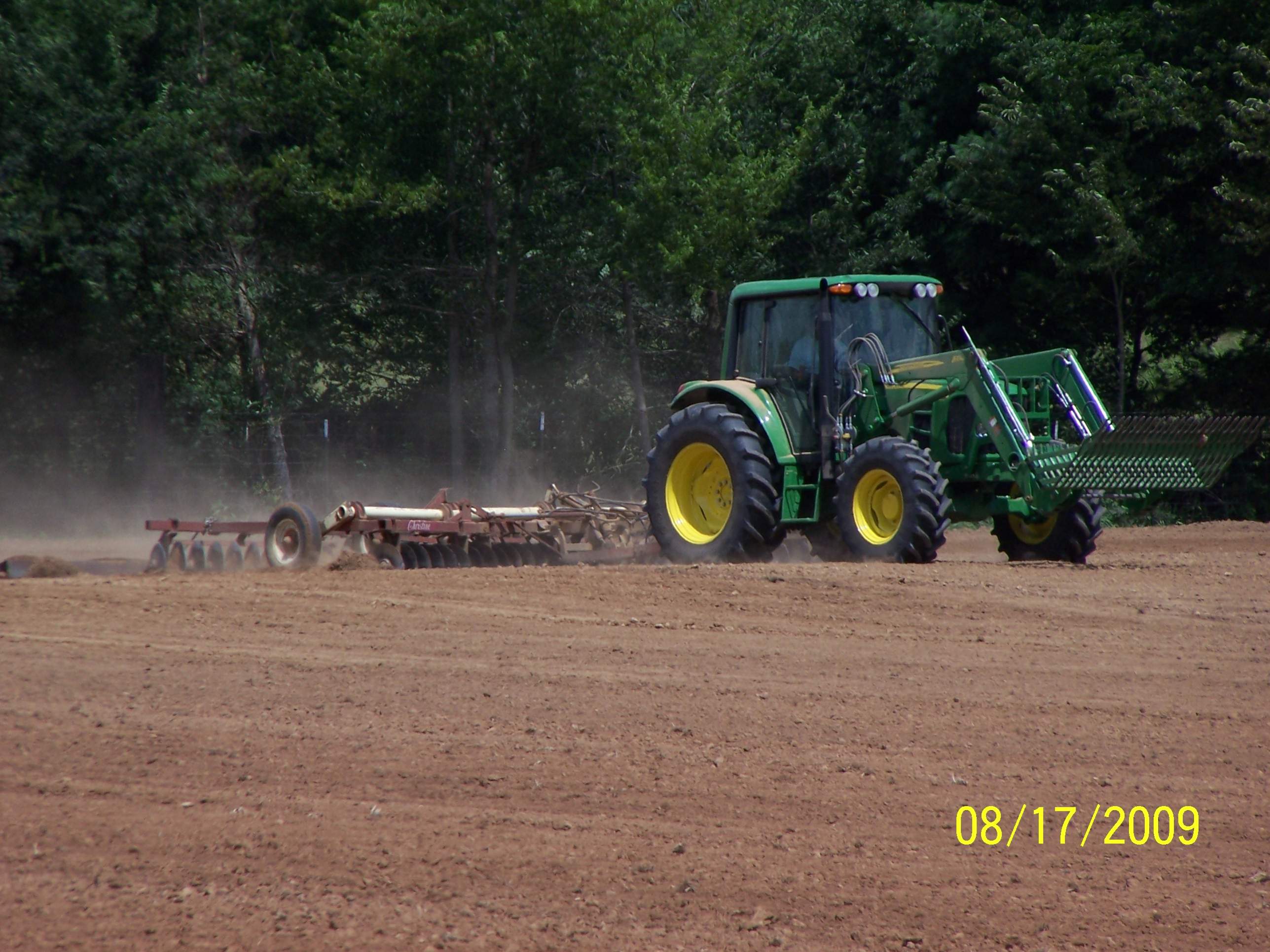

I am in middle tn. Those pictures are from the total rework of that hay field. dates are correct that field has been really putting out the hay since i beat up the ground so much.. Started with the plow then dick to smooth then went in with chisel plow and broke the bottom of it over 30 " deep in a cris-cross patten then back in with the disk spent over a month working the dirt. packed the top so that the drill would not leave tracks and over triple the tonage from that field since. I have had nieghbors paying me to do their fields now. lookin for a new disk and packer my old krause has seen alot of ground.
/ 6430 performance question #22

someone mentioned the old picture he is a new one.
