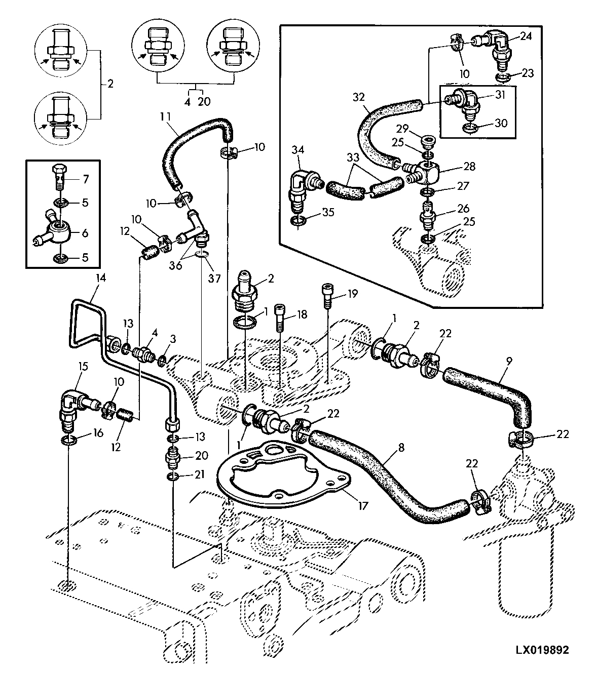

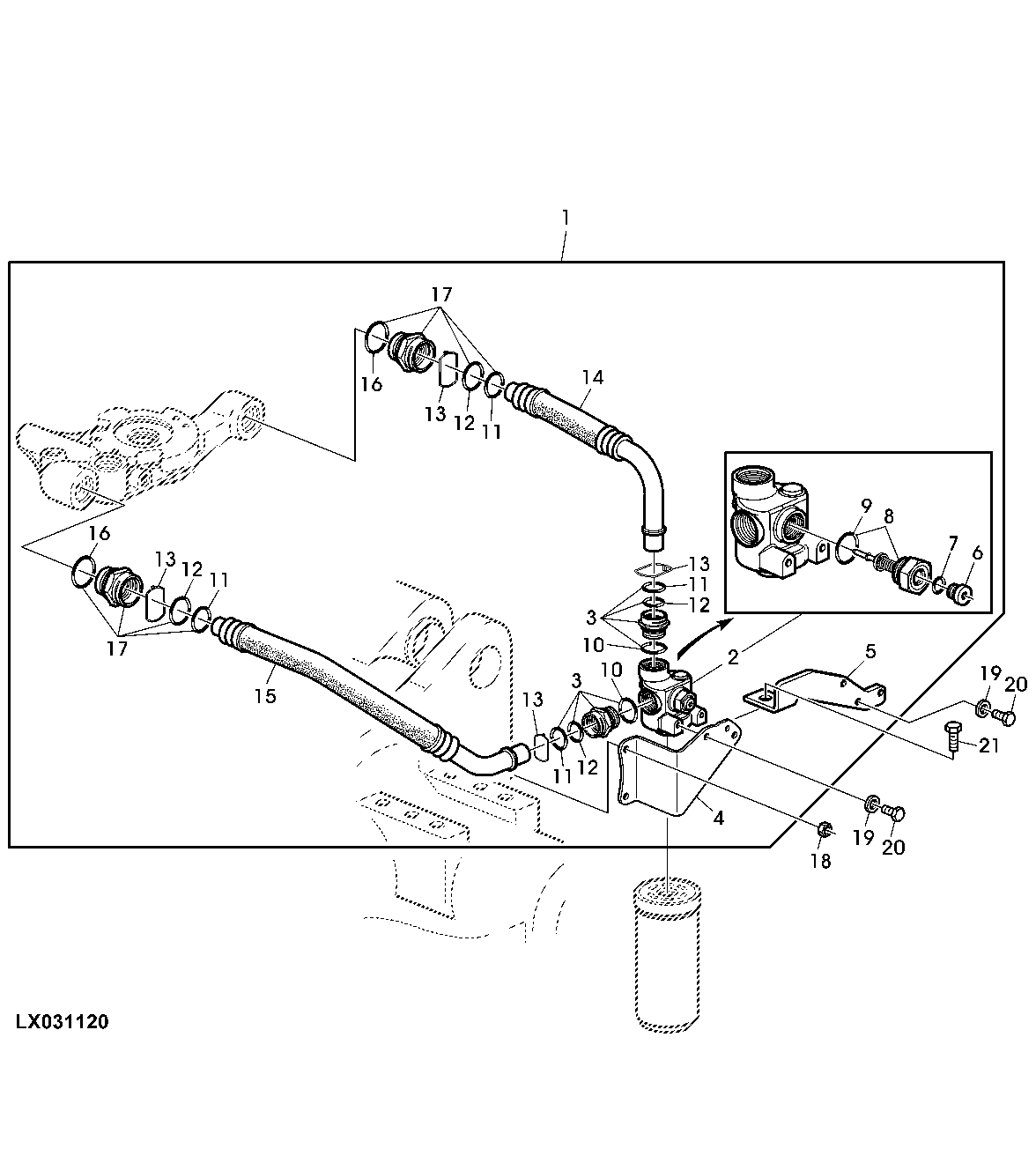

Is it hose 8 or 9 in the first drawing? I see in JD parts they have an oil line conversion kit that does not use hose clamps on the hoses. Maybe this is a known problem and this is JD's solution?

It was hose 9 where clamp 22 is.
But I think Fuel Doc Figured it out....What I did was losen off the fill cap and started it up...And now the Hyd warning lamp is not on any more.

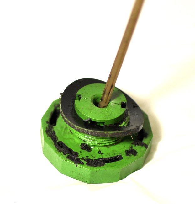

/ 6400 JD Blowing hoses
Here's that cap before...It looks a bit plugged up

When looking at pictures of the cap yesterday I was wondering if the debris on the cap was coming from the brake discs. Hope not for the OP's sake but that is a lot of drbris if it is clogging the filters, not a whole lot of places it could come from.
/ 6400 JD Blowing hoses #12
Most of the time it is dust and hay dust that gets in the vent and the oil just makes it stick in the vent on the cap
